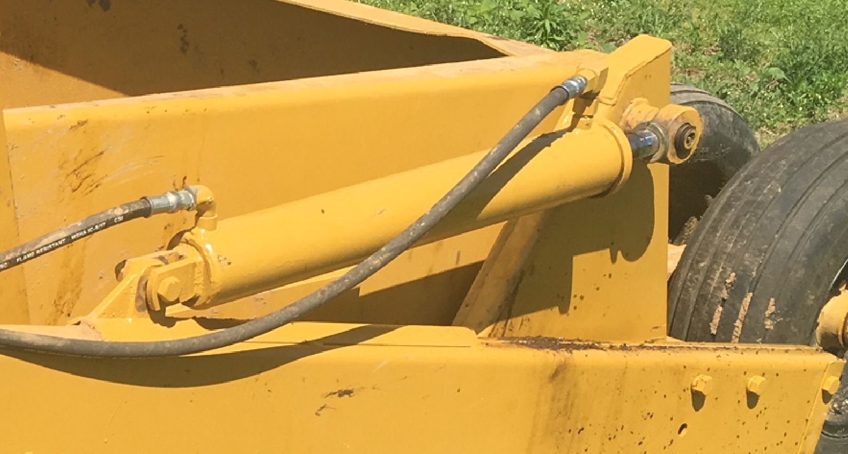

My old scraper has turned out to be more of a hassle and hindrance than a benefit. It seems as though everytime I turn around something else goes wrong and as soon as I fix it, a new problem arises.
I have need of a new hydraulic cylinder after this one blew the back seal off and they repair place says it will be $700 and several weeks to rebuild it. Likely cheaper to just buy another.
I'm in a bind in that I need this scraper working early this week!
Where is the best place to buy a cylinder such as this and where can I get it quickly and at a reasonable cost?
The rod is 1 1/2" and I think the thing is about 30-36" long. I can measure it Saturday or might be able to get dimensions sooner, but basically, it isn't a small piece.

Cylinder comes apart and moves freely. The rod does not 'appear' damaged. The seals looked to be intact.
Basically what happened was my own stupidity. I made 'stops' out of pipe in order to halt the travel of the rod. That 'stop' pushed into the back of the cylinder resulting in the failure of the main piece which holds the cylinder seals in the housing. I don't know what it is called, but it appeared to be about a 3/16" piece which was screwed/attached somehow into the housing, through which the rod then moved. I completely know my issue and that it was caused by me. But I also know why it failed and while I don't know about hydraulic cylinders, I do think that it was a single point of failure in this piece, caused by me. The cylinder slid freely afterwards. It collapsed completely with the seals freely sliding into the housing.
The failure is whatever holds the seals in the housing. This piece I believe is all that is wrong. Now... that might be a complete bust as far as the usefulness of this cylinder. I might have completely screwed it up in this instance. However, I really believe that is all that is wrong with it. It might be catastrophic, but it is a single point catastrophic issue.
3.5" bore
24" stroke
1.5" rod
I'm not exactly sure of the collapsed length.
Swivel eye on one side and clevis on the other. (This is the issue I am running into for a replacement. They seem to be built only with the same on both sides.)

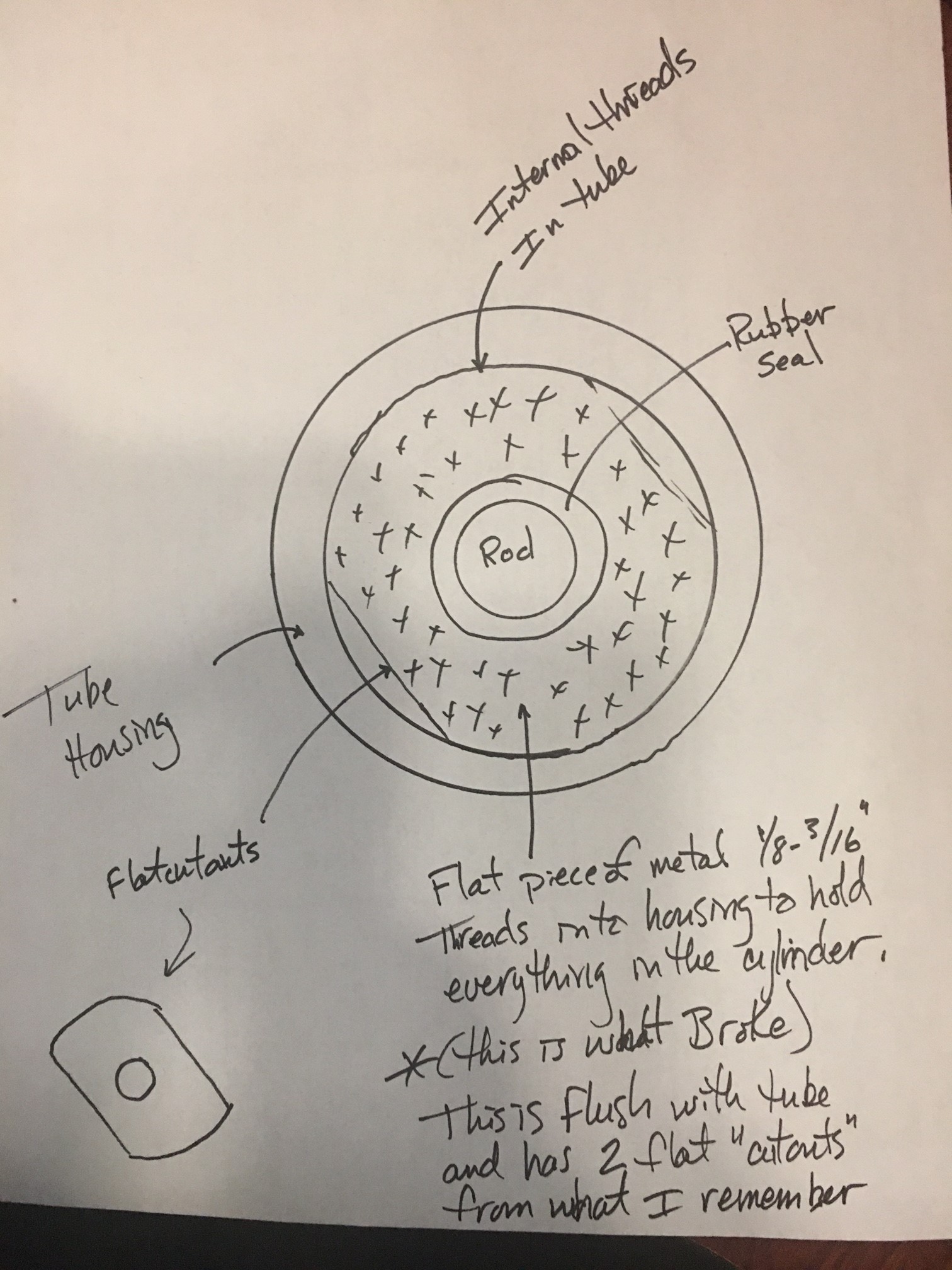

I'm going to look at it Saturday. I had simply assumed the fix was straight forward. They might be thinking it needs to be 100% when I am looking for 'functional'.
I think I just need a cylinder headcap that fits my piece. However, it doesn't screw 'around' the outside, it threads inside. I simply haven't found them online yet, but all the 'rebuilds' I see on YouTube have internal screwing caps. Mine is different, in that theirs appears to be much more 'beefy' than what was in mine. Mine is a relatively thin 1/8-3/16" round flat disc with threads around the entire outside. It screws down into the housing until it is flush. Also, it has 2 edges which have been cutoff, making it flat on 2 sides of the 'circle'. I suspect this was what allowed the screwing/unscrewing of the 'endcap or whatever this is called'. This flat piece is what broke, and allowed everything to come out. It very well could be FUBAR, but it still seems like it doesn't make sense to me.
This drawing is essentially what I can remember it looking like.
I do wonder whether it could be that it is an "Internal Threaded Ductile Head"?

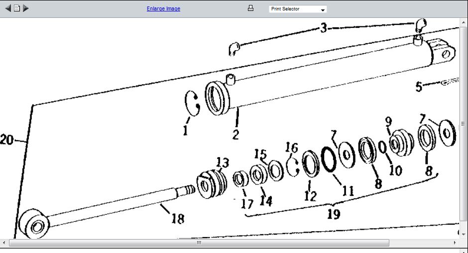

I found the schematic online: I need #13 listed as 'Guide' #HK041057
It appears it is MORE than the simple flat piece, in that it is attached to the entire main piece. Also, I don't remember seeing the internal snap ring, perhaps that is what blew out and allowed everything to disgorge. Any thoughts on getting this piece? I'll contact the local Industrial JD dealer tomorrow and see if that piece can be purchased.
