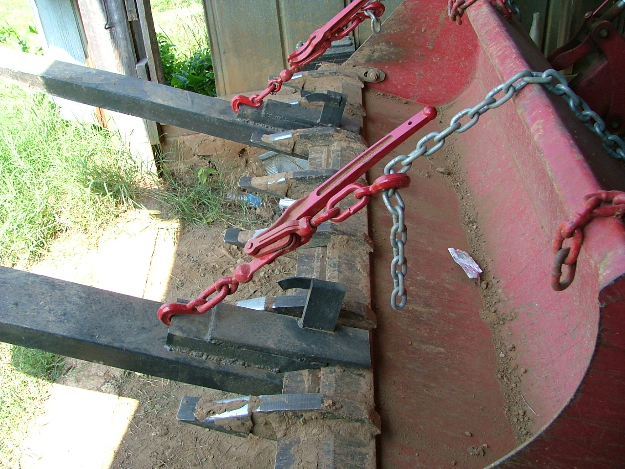

I made a set of forks from a skidsteer "cover" set (the kind that slip over a worn set)..I'll try and post a couple of pics..BobG

Hit pay dirt today. There happened to be some forks that would work on a set at my dealer. They will be floating like the originals. Think he said Tennessee River Metals made them.
Loader is definately a great bend. I found some old paperwork that says so.
