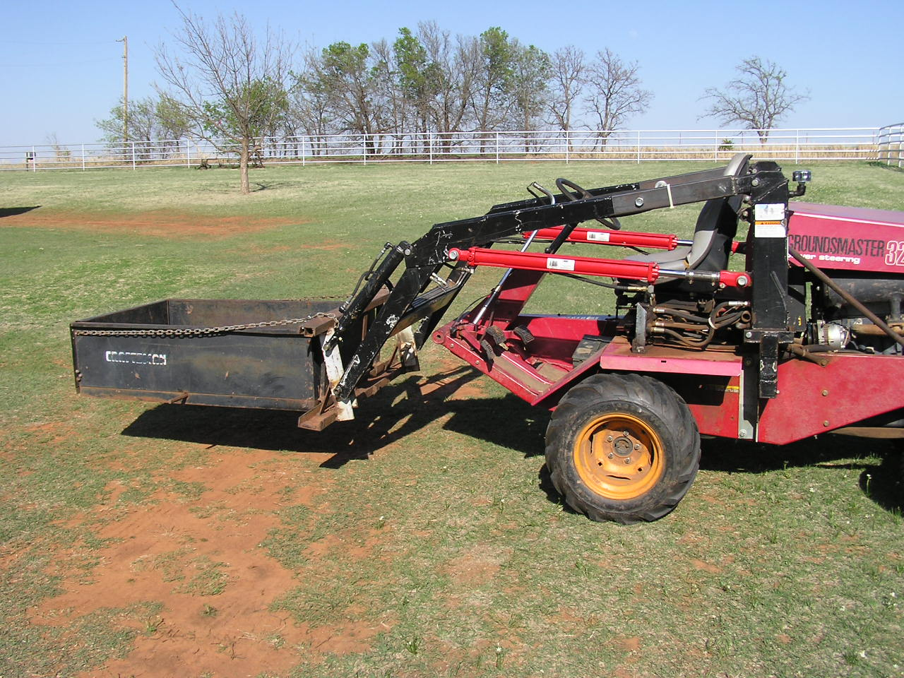

I like that well enough. I decided i am going to convert a riding mower dump cart into a 3pt attachment like that, since it turns out i never use it with the riding mower because.. i am always riding the tractor around! 😁
   / USA Manufactured 3-Pt. TRANSPORT BOXES / DUMPING CARRYALLS ~ Anyone bought? #30

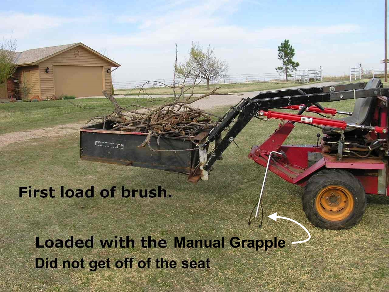

I put a riding mower dump cart on the forks:
It is a good dump truck:
Handy for brush:
