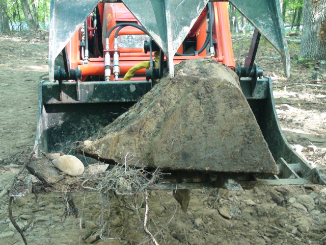

In the foreseeable future I will be fencing in a 1 acre garden area off the back of the house. With all of the rocks on my property I have decided not to use wooden 4 x 4 posts except at the corners and gates (or possibly metal pipe) and use T-posts everywhere else. From responses to a previous post, I will probably use a #5 driver bucket attachment from bucketdriver.com
My property is VERY rocky and it is quite a chore just to get the driveway flat enough to lay gravel. It seems that every 4" - 6" hump in the ground is only the tip of the proverbial iceberg and I have to dig up the large rock which usually seems to be surrounded with smaller large rocks. I have attached two pics for those who have not seen previous posts of my rocks and I have dug up quite a few rocks like the largest one and a huge number of smaller rocks in the 20# - 100# category, along with quite a few between 100# and 300# or so. A lot of it is granite.
Since I do not have access to a ground penetrating radar unit to make my fence post positioning easier, I am wondering if a good quality metal detector would be helpful? It sounds like a good idea to me but I have never used such a device. Any comments from those experienced with metal detectors or any other ideas would be appreciated. I am planning on driving the posts ~ 2 feet deep.

Mine doesn't seem to find a difference between rocks and dirt. It might with the right settings and a rock of the right type, but it won't on my land.
What I have done, at a couple of places where I kept hitting rock, was to drive a small, smooth rod (1/4, 3/8) where I wanted a post, to see if it would go in to my desired post depth.

Thanks. Odds are most detectors would be the same since they all use similar technology. I may have to drive a section of rebar first as a test.

Rebar is harder to drive and pull, I found.

I have been using metal detectors for many years now. They are obviously designed to locate metal objects, not rocks or dirt. The higher end models with a ground balance control can sense differences in the density of the soil, but I think trying to interpret the differences in the tones when moving from all dirt to a large rock (buried under the soil a few inches) would just eventually lead to frustration with it. I don't think you could accurately learn to distinguish the difference, on a consistent basis. The tradeoff though, is that you might find some really cool metal stuff with it lol.

Thanks. You guys have burst my bubble and saved me some money on a tool that would not have worked for my purposes. I was hoping a metal detector would zone in on the mass of the rocks and differentiate between rock and earth, but apparently not. However, around here there supposedly used to be some gold mines years ago and some say that where a lot of granite is found, so might be gold... So maybe I could retire if I bought one, maybe ??? Ha, ha. Even I can't justify this... and I can justify a lot.
