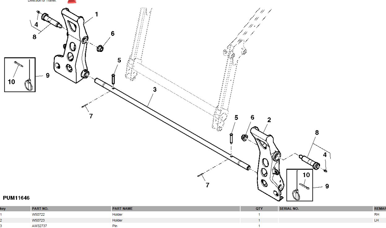

Hey guys-
I'm a longtime reader, but a first time poster. Thanks for all of your help!
Can I swap the quick attach hardware and bucket from a 200x FEL (currently on a JD 2305) onto a D120 FEL (currently on a JD 1023e)?
Seems like a pretty simple swap, but I'm hoping you guys can confirm/deny.
-Gpabby

Welcome to TBN gpabby,
it looks like the "holder" is interchangeable with the 200cx and the d120..
here is a pic of the part and the part numbers for 1 and 2 show compatibility
with several of the newer loaders.

Thanks, Dutch445! I've also noticed that the bucket on the 2305 (200x) seems to have a greater holding capacity in terms of volume than the 1023e (D120). Both buckets are 49":
1) Any idea why the newer buckets would hold less?
2) Would you have any concerns using the 2305 bucket on the 1023e (balance, weight, etc)?
   / Use the quick attach bucket and hardware from a JD 2305 200x loader on a D120 loader? #4
the Pin on buckets are physically smaller, and i wouldn't worry about the quick tatch
bucket as i've never sold the pin on bucket and everybody seems happy with the
quick tatch buckets, 49 or 53 inch...
