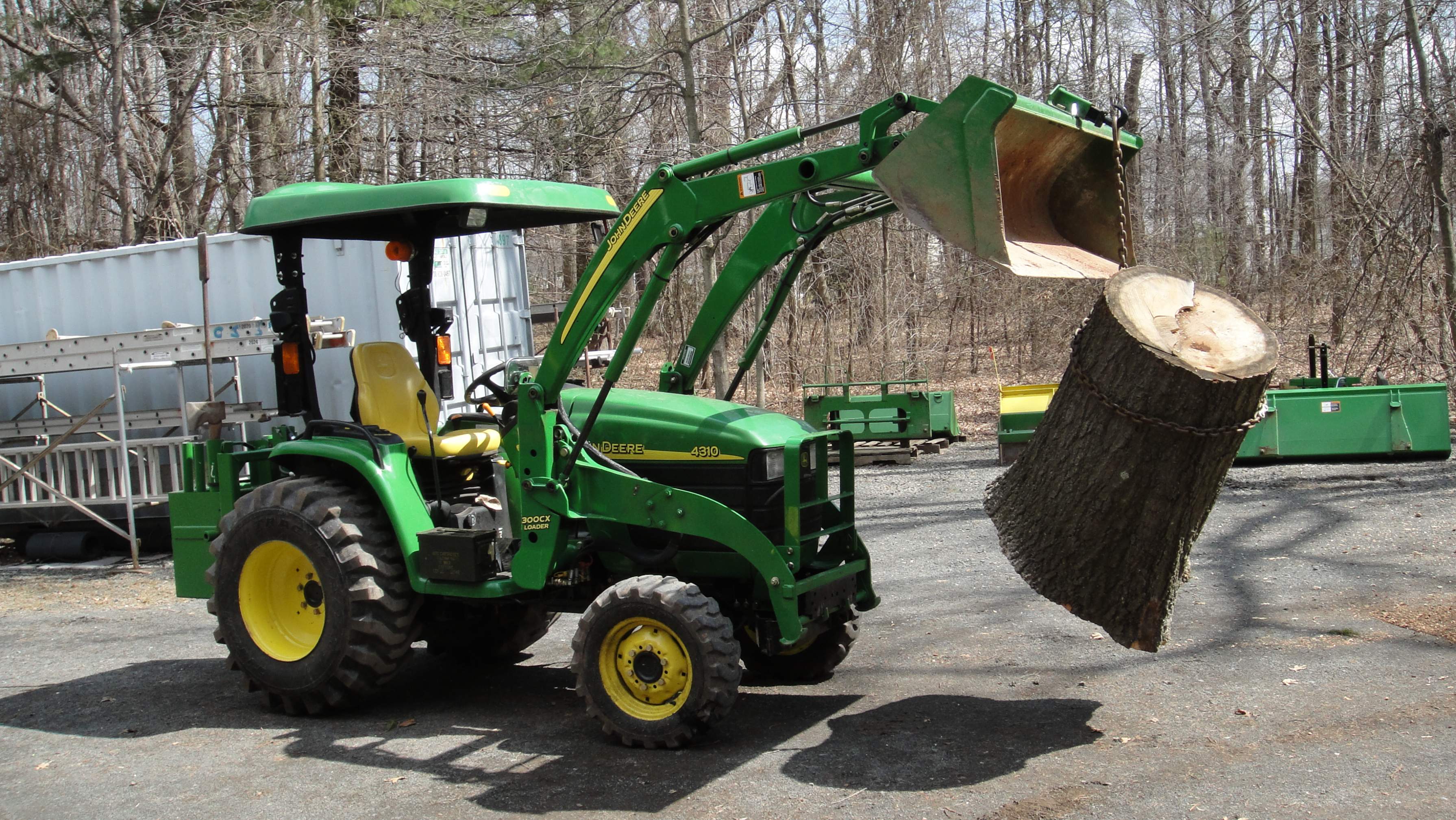

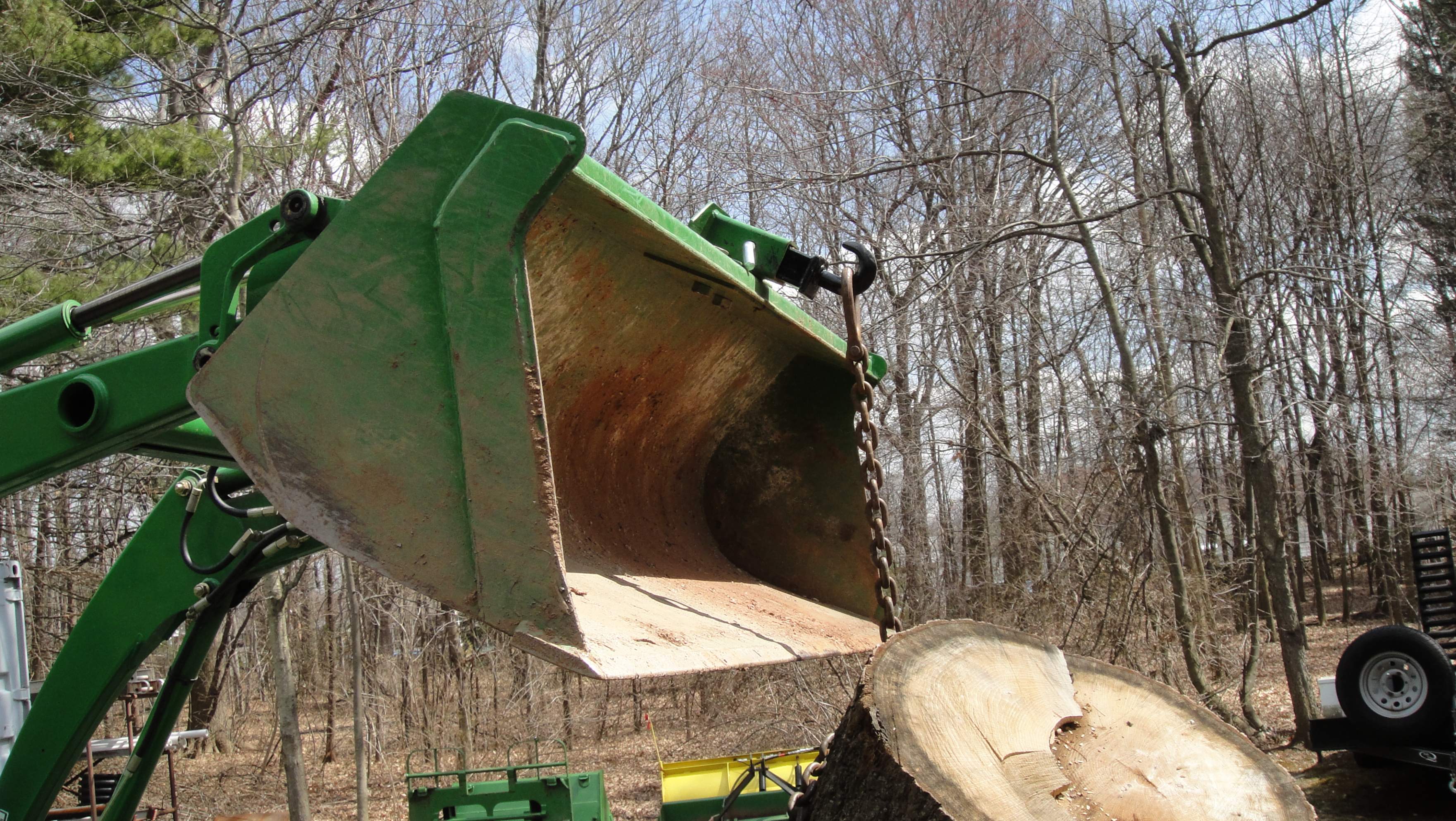

Once steel is bent, the strength it had before will never be the same again. If you heat the metal, AND bend it back, your losing a large amount of strength yet again, by heating, and bending for a second time.
Also, in one photo, I seen a chain hook welded in the center. I would strongly suggest welding one hook on each side, directly in line with where the loader arms attach to the bucket. The closer you are to the side of the bucket, the more support you have. I would still weld a piece inside the bucket for extra support as well.
I guess if all you need is a bucket to move very lightweight material such as fluffy snow, mulch, or something like that, it would work just fine. I wouldn't want anything bent to be seen on any tractor I own though! :D
You are crazy, the bucket in the first post (which is the one I am considering buying) is worth far more then that. And that slight dent in the top is hardly going to effect the buckets overall strength once I bend it back; IMO.
