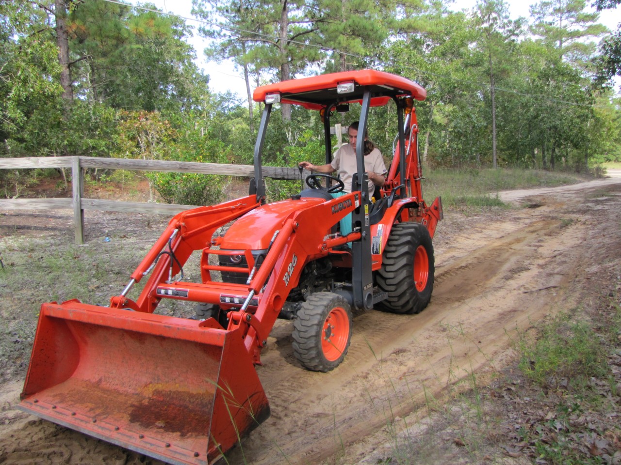

Thanks Guys,
I am a tractor newbie, been looking for over a year, and yes noticed this one because of the posts here. I followed the craigslist link on previous post and did a map search and learned it wasn't as far away as I had thought. Called the owner on the off-chance it was still available and voila...B26! The previous owners are really nice people who we are keeping in touch with. In fact, we may go visit them for a few days this fall, just such a sweet couple.
The tlb is super clean and runs great. I did notice a small leak in front left axle. After picking it up, I took it straight to our local Kubota shop who fixed the axle leak and did full service check-over. I told them to change out all fluids/filters and look hard as the tractor has sat mostly over the last couple years. Two very long weeks later the tractor arrived! We've had it for a few days now and couldn't be happier.
I definitely want to shout out a big thanks to all the folks here at tractorbynet! In addition to the people that contributed to this thread, I'd also like to thank the guys that have posted about Kubota TLBs in other posts. About 6 months ago I made up my mind it would be a Kubota tlb or bust. So much of what I am learning is coming from posters right here. I feel very confident that we got the right tractor for us and my wife absolutely fell in love with it and the previous owners, lol. Thanks guys! :)

Congratulations nice looking tractor.

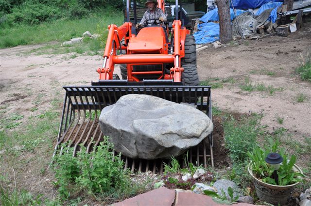

Looks like you have a lifetime of fun there. Glad it's got a thumb. I think you will find as we did that the backhoe gets more use for gardening, lifting, and placing things than for digging. Ours is the larger version - the M59 and we use it for everything.
Someday I'm betting that some clever guy will come up with a whole raft of accessories that fit the quick attach hoe bucket mount and use the TLBs for all kinds of things. We could use a single tooth ripper, a skeleton BH bucket for placing landscaping rocks more accurately, and maybe a post hole drill. Oh, and a three to four foot wide sort of grader blade with a smooth edge instead of teeth for flattening and finishing large areas. And a small brush whacker along with a flip down screen to protect from flying debris.
But having a thumb is the first step and the big one.
What accessories did you get? You may want to go through Kubota's list of accessories still available for that model while they are common. There are a surprizing amount of things from dealer overstock that gets sold on Ebay. At one time there were various hood or bottom protectors, lights, tool boxes....etc. And of course you want the three point kit if you didn't get it. BTW, I recommend that once a year you remove the backhoe and put the three point kit on - if for no other reason than to keep the pins and mounts greased and fitting properly.
You'll want a small lifting chain - 12 feet if grade 100 in 9/32" link size is about right. or two sixes. A battery minder and oh yes - very important - it should have a 110V. block heater. Get the dealer to install that; it has an odd thread. Use it in cold weather for a few hours before starting the engine; it will really extend the engine life. I do that plus a long (5 minute) warm up in cold weather.
Lets see.... what else.... oh yes, some hooks on top of the bucket. I like the bolt-on type to the welded, and a reinforcement against bending the bucket if you put one in the center.
You can see in the photo that I kind of went overboard with that, but I had them laying around. Two is plenty. Put them out toward the edges. Not shown is that my center hook has a large piece of steel underneath to spread the stresses out and prevent bending the top of the bucket. You can see the bolts that hold the metal in place.
The largest two wicked hooks in the photo are actually hooks from a small Toyota PU front bumper. Got them at the junk yard where they have a bucket full of similar hooks for sale.
I just couldn't help myself with the advice, but excited to see you get such a nice machine.

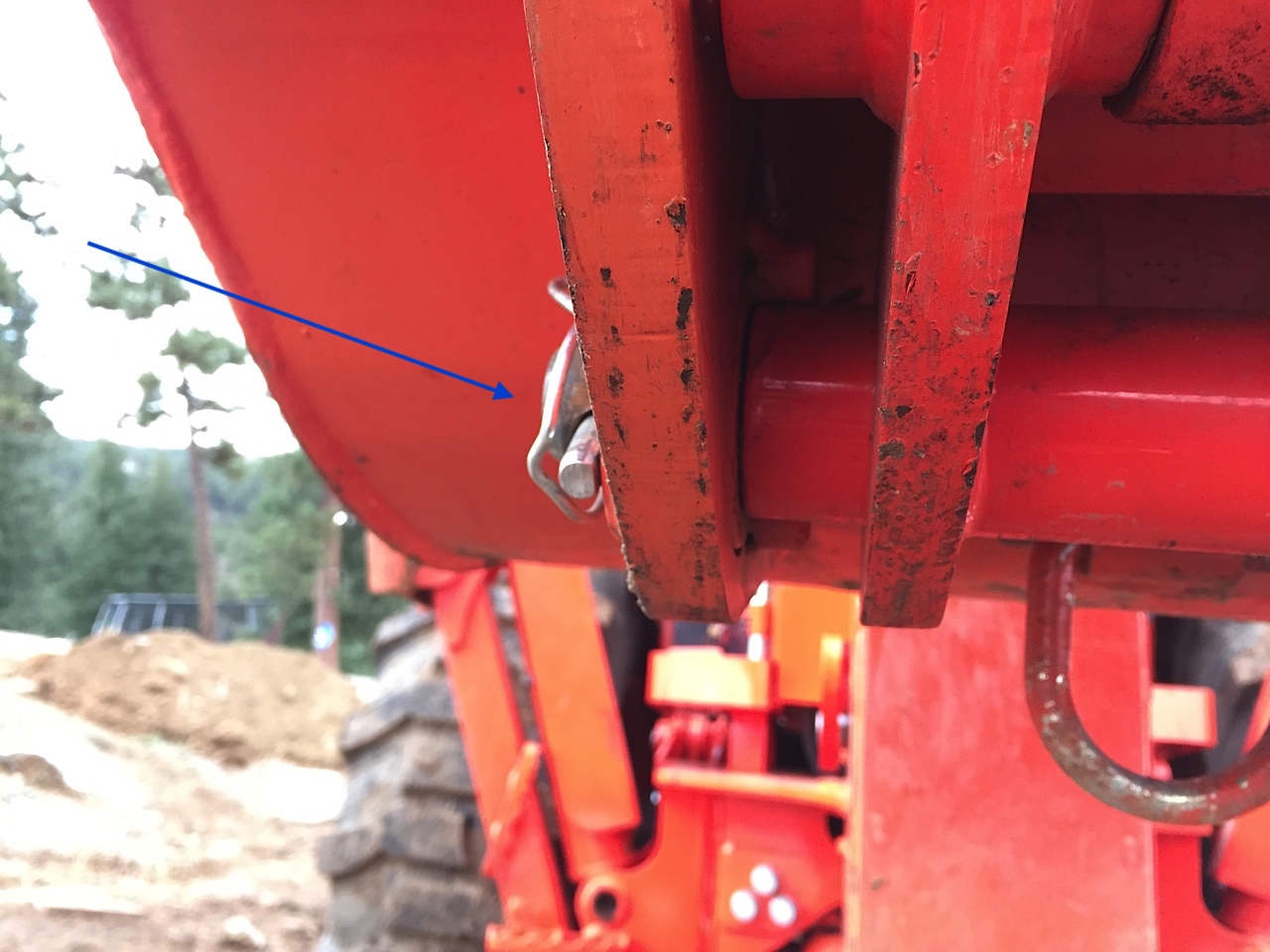

BTW, if you have the quick attach type Backhoe bucket with the finger clip to retain the pin, they come loose and can allow the bucket to bend the mounts.
Watch it carefully when using the bucket for digging, and maybe safety-wire it in place.
Most have replaced that pin with a double-nutted grade 8 bolt.
My only other caution is to be careful about running over logs and stumps. The underside of all of the TLBs is less well armored than the rest of the tractor.
Some skidplates under there is another thing that someone could offer and find a lot of buyers.

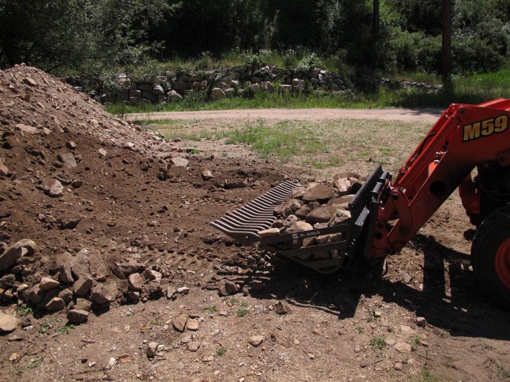

Our ground is rocky, and lately I've been doing less and less with the 3pt and more with the FEL because the SSQA allows quick switching between the regular FEL bucket and a skeleton type rock bucket to break up soil and sort rocks. Or sometimes I will break up the ground with the hoe before turning around an picking it up with the FEL.
