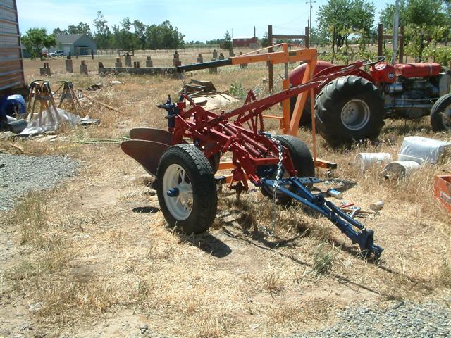

Just be sure the adjustments still work. I've bought a used tow-behind 2-14 plow (IH Little Genius) as well as a used JD 2-14 plow that fits on the 3pt hitch. I completely restored that IH plow to get all the adjustments to work properly.

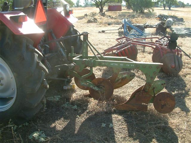

The 3pt adjustments on that JD plow were shot.

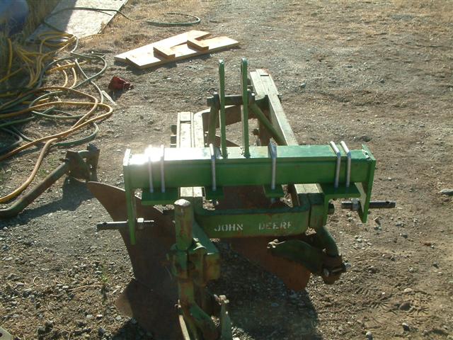

So I had to weld up a new 3pt hitch attachment for the plow.

Be sure the plow you get has coulters (the discs hanging in front of the plow bottoms) and a rear wheel that rides in the furrow and helps keep the plow pulling on a straight line. The coulters cut through heavy turf and other trash on the surface and help the plow work better.
