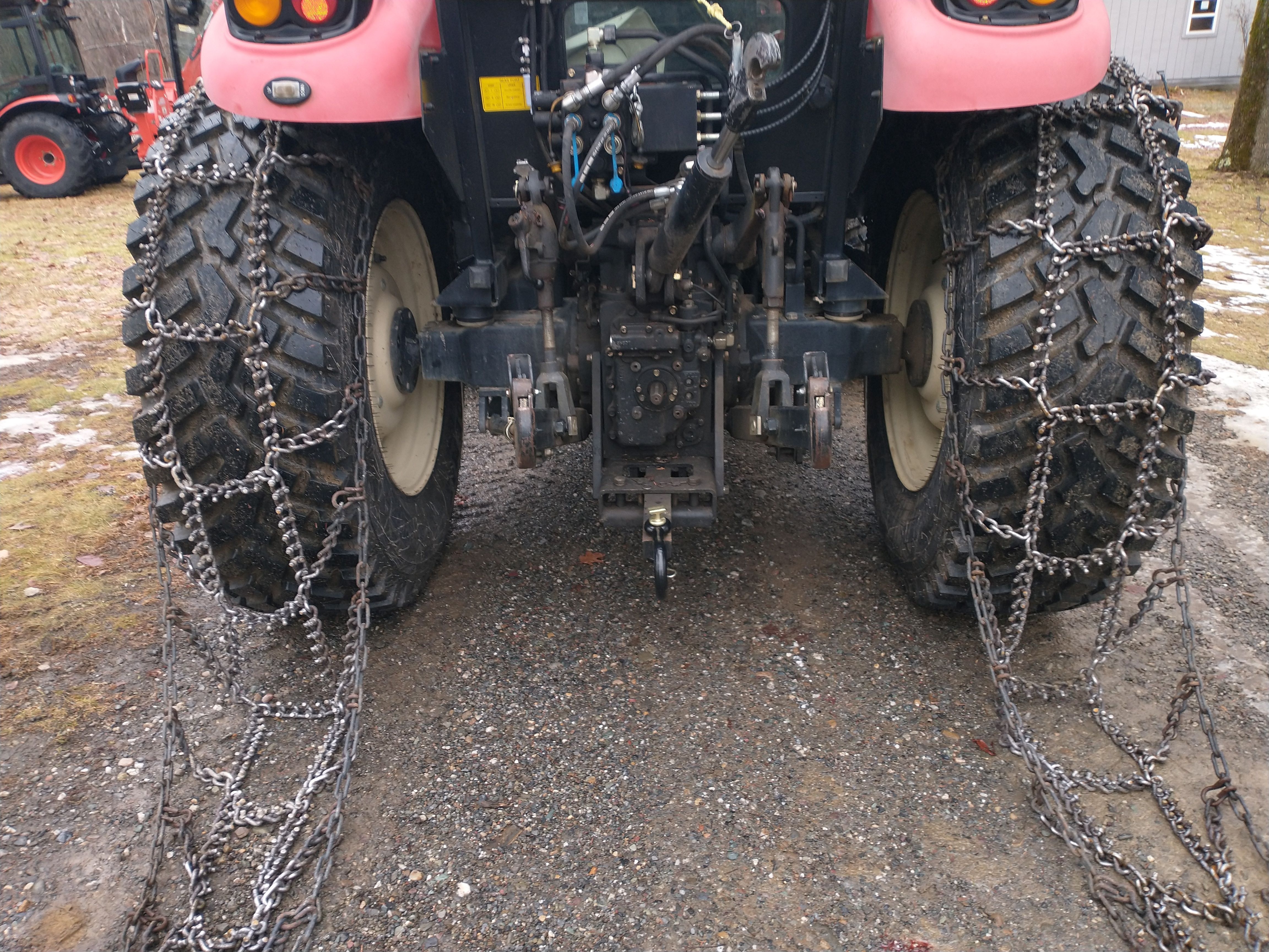

I prefer the R-14s way over the R4s, hard to beat R1's most of the time. But once they spin on wet snow none of them are worth a damn. I switched one tractor over to BKT Ridemax last year they worked very well in the snow. But even then the rears were chained up. If it's steep and gets wet snow or ice under the tires none of them wil work worth a damn.
Putting the chains on the new rear tires.

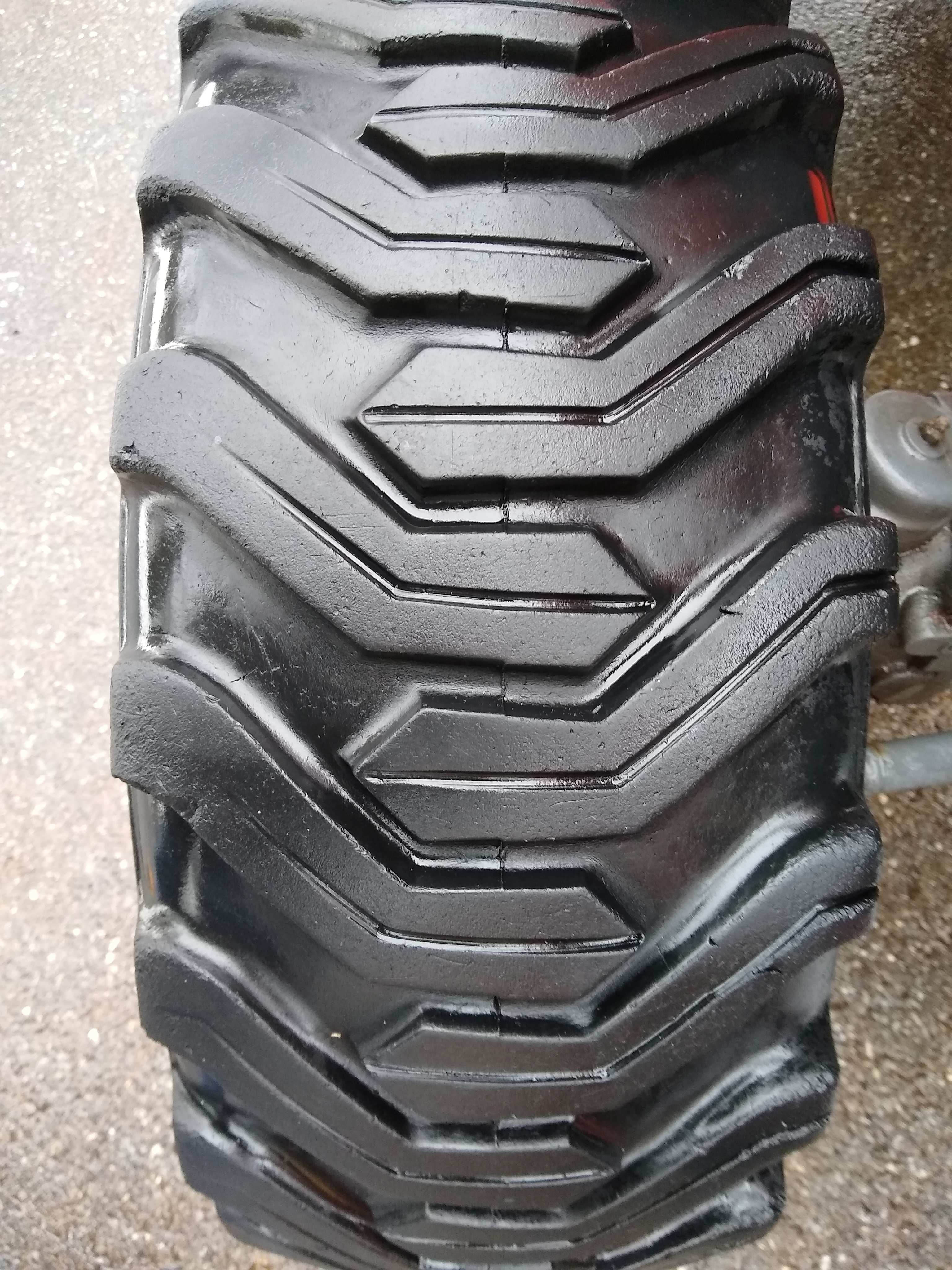

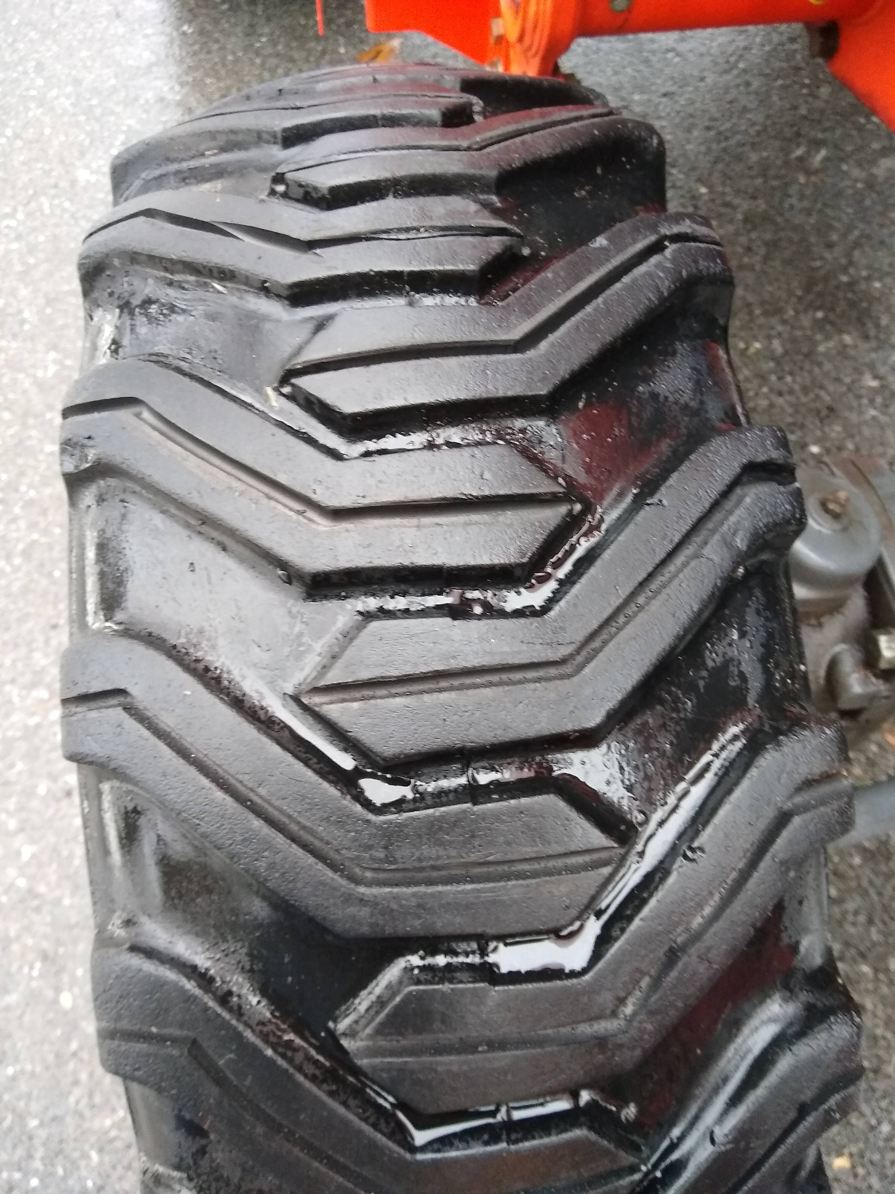

The first picture below is from January of 2019 when the tires were grooved on the 977 hour new-to-me L4240. I don't have record of the hours when the next two pictures from January of 2024 were taken when they were regrooved. Probably around 1400 hours. This shows how much camber it has. The insides were barely worn in 5 years.
EDIT TO ADD: The these tires have 1600 hours on them and they look like they'll last for a while longer.
