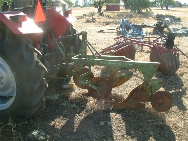

What should I look for when buying a used bottom plow? I know there are not really any moving parts so I am not sure what wear and tear to look for. Also, just finding a used plow has been difficult. Thanks in advance for any info.

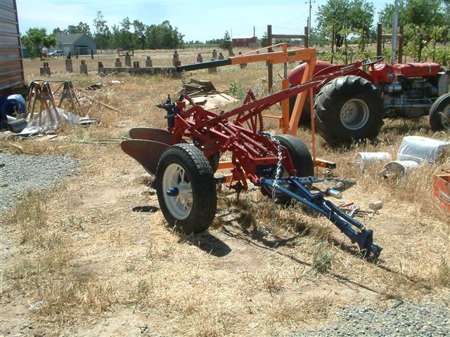

Just be sure the adjustments still work. I've bought a used tow-behind 2-14 plow (IH Little Genius) as well as a used JD 2-14 plow that fits on the 3pt hitch. I completely restored that IH plow to get all the adjustments to work properly.
The 3pt adjustments on that JD plow were shot.

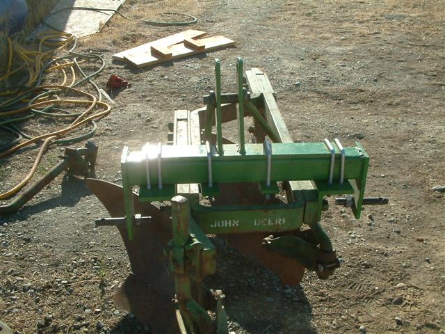

So I had to weld up a new 3pt hitch attachment for the plow.
