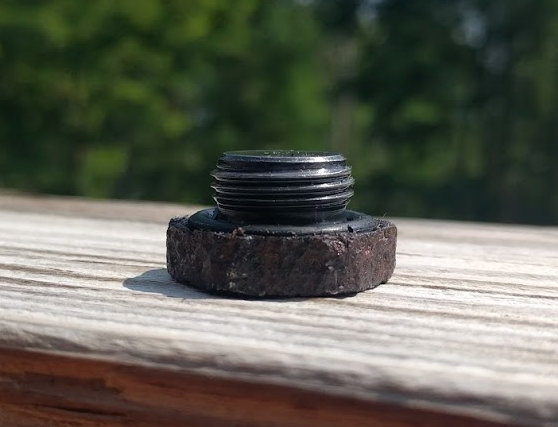

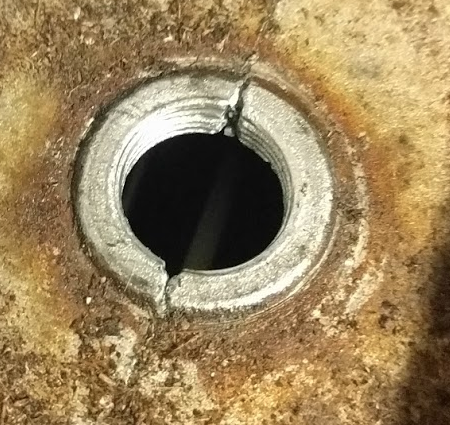

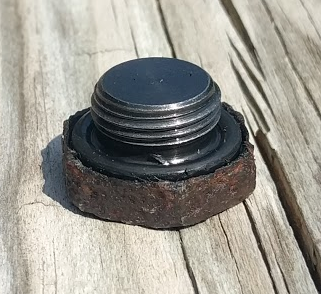

Thanks. Here are some photos of the top plug as it came to me. The top plug doesn't look so bad to me, but I'm not familiar with what to look for.
The bottom seal seems to be leaking pretty badly - I assume that if it was due to pressure build up, the seal has been compromised and I'll need to take it apart and reseat the seal / install a new one?
If it wasn't due to pressure build up, is there anything else? I think my friend ruled out a cracked gearbox... Screen Shot 2017-08-22 at 2.20.47 PM.pngScreen Shot 2017-08-22 at 2.21.11 PM.pngScreen Shot 2017-08-22 at 2.20.59 PM.png

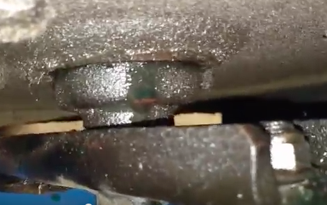

Here's a view of the leak / stream

I seriously doubt the problem is due to pressure buildup; but there's a simple way to find out.
Loosen the top plug; still leaking out the bottom?
Now you know.
I suspect a problem with the seal installation; most likely the shaft that wears against the seal is rough / corroded, and spoiled the new seal. Other possibility is a loose / worn out bearing, but that would have been obvious.

That oil seal o-ring does not look good at all and is where you oil is going most likely. At this stage I would just invest in some corn picker grease to lube the gearbox and enjoy breaking new ground for a fall green manure crop.
