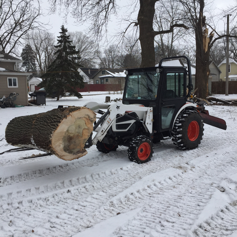

The John Deere 110 is a cool machine but honestly unless you're planning on doing continued extremely heavy duty work with it don't know if it's necessary. It does seem built very well and would probably last without question. I have run one A few times and it did a fine job A bit underpowered I thought but nonetheless a nice heavy duty machine and if you're planning on getting a backhoe for sure it's not a bad option. The backhoe definitely seems better then the ad on options for compact tractors.
However I think there are plenty of machines out there that will handle your rock bucket just fine and are of great quality. Bobcat marketed a version of the kioti CK line of tractors for years as a commercial machine. I currently have one and would have no qualms about doing the tasks that you have mentioned and I feel it does them all quite well. If you feel the heavier duty commercial grade TLB is best for you then by all means get that one or you will always regret it. Personally I prefer to have a little smaller machine because I feel it is a little more versatile for my uses. It's easier to get into smaller yards for me but yet still capable of getting The larger jobs done with just a little more time. Nothing more than my opinion. Hope it helps.
As a person who owned a bobcat tractor I can tell you with 100% certainty it is not a construction grade machine comparable to other bobcat equipment in quality and construction which is one of the reasons the line was dropped.
