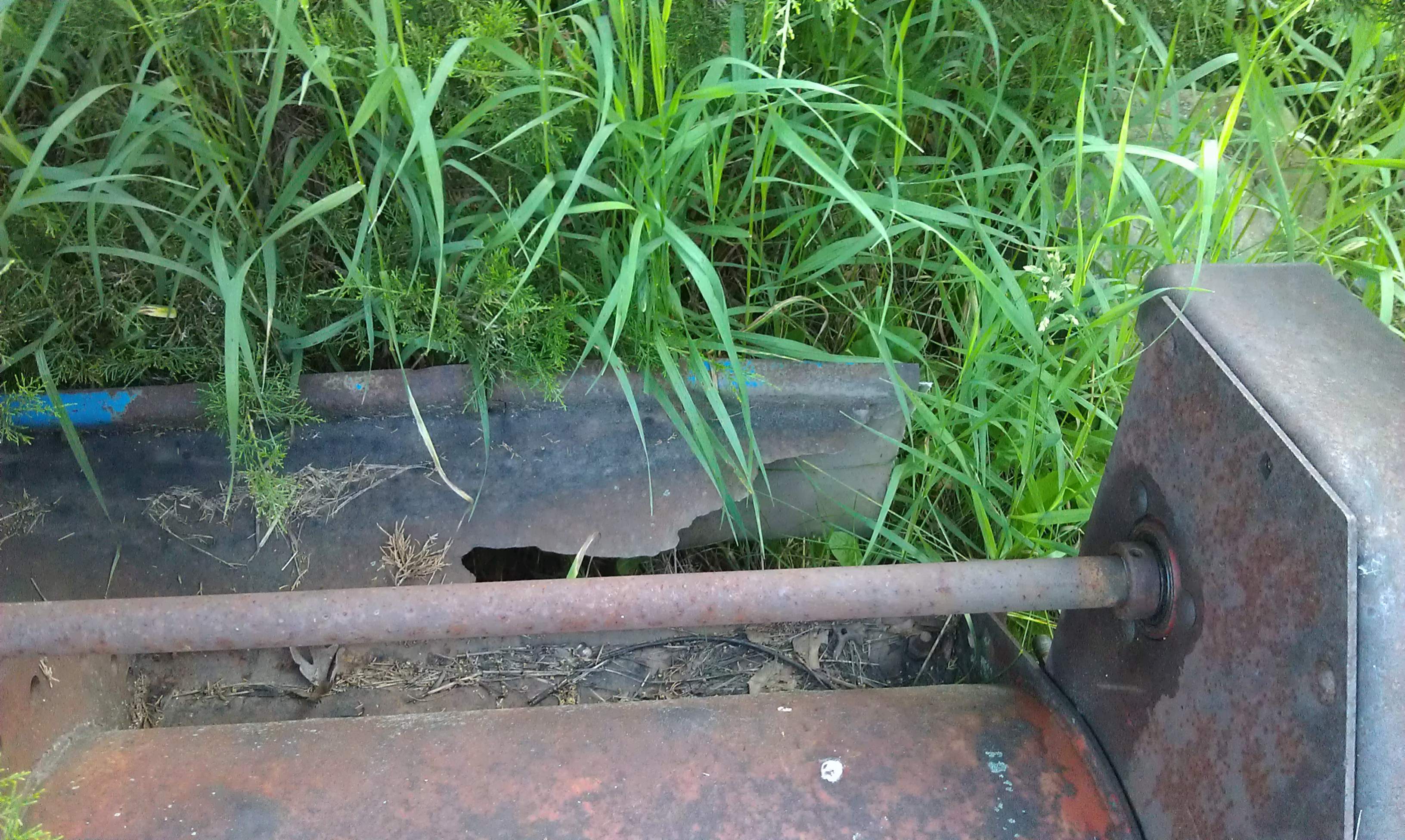

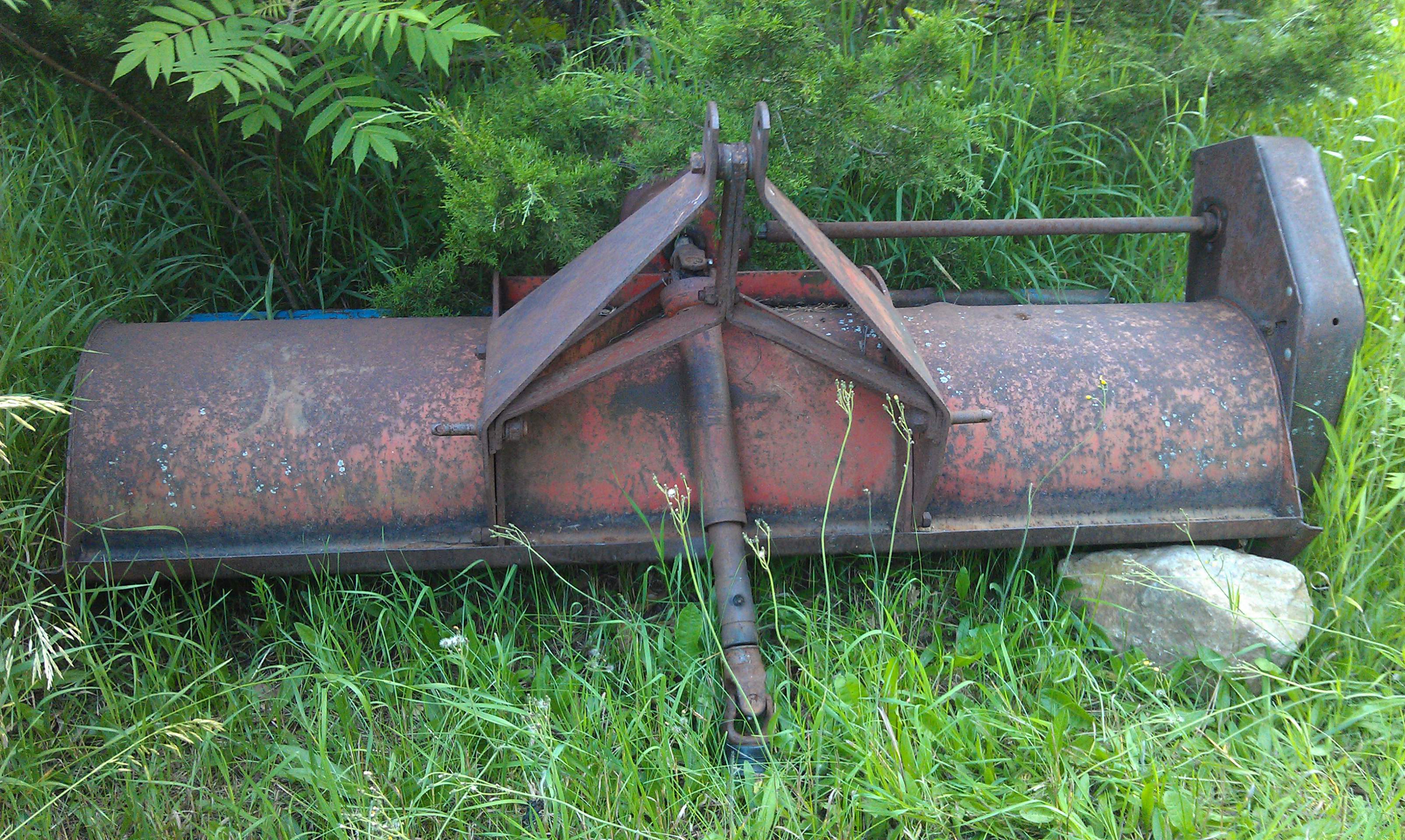

I went to flailmaster online but I didn't see much of a website. I hear they are great to work with. I would be interested to see what a new roller and roller bearings would cost.
I have some great ideas to fab this thing up. I like to add hydraulic actuators to everything and a trash door seems like a novel upgrade to a mover in need of a new safety door.
here are some pics I took of it today in the weeds. pretty rough
   / Used Ford 907 Flail Mower questions #14
View attachment 325950View attachment 325951
Hello Bubacuse,
The flailmaster folks have been working on thier web site
for while and for some reason you cannot access the
catalog through there. They certainly have a great catalog.
Now that I see the mower you will most definitely have bit
of welding to do AND be sure to make weldments that match
the right side exactly as log as you are fabricating a trash door.
You will need a full width paino hingefor the trash door providing
the hinge can be used in one continuous piece.
You will have to decide on how many locking pins and attachment
arms you will need to hold the trash door open.
All of this will depend on the steel thickness and how well it will be rolled to make
the finished shroud curve to assure a straight frame to eliminate any chance
of twisting and or racking the mower frame and whether the attachment
arms will be mounted on a hinge pin or solid mounts/weldments. The use
of a solid weldment eliminates rattling when mowing with a trash door
in the closed position.
