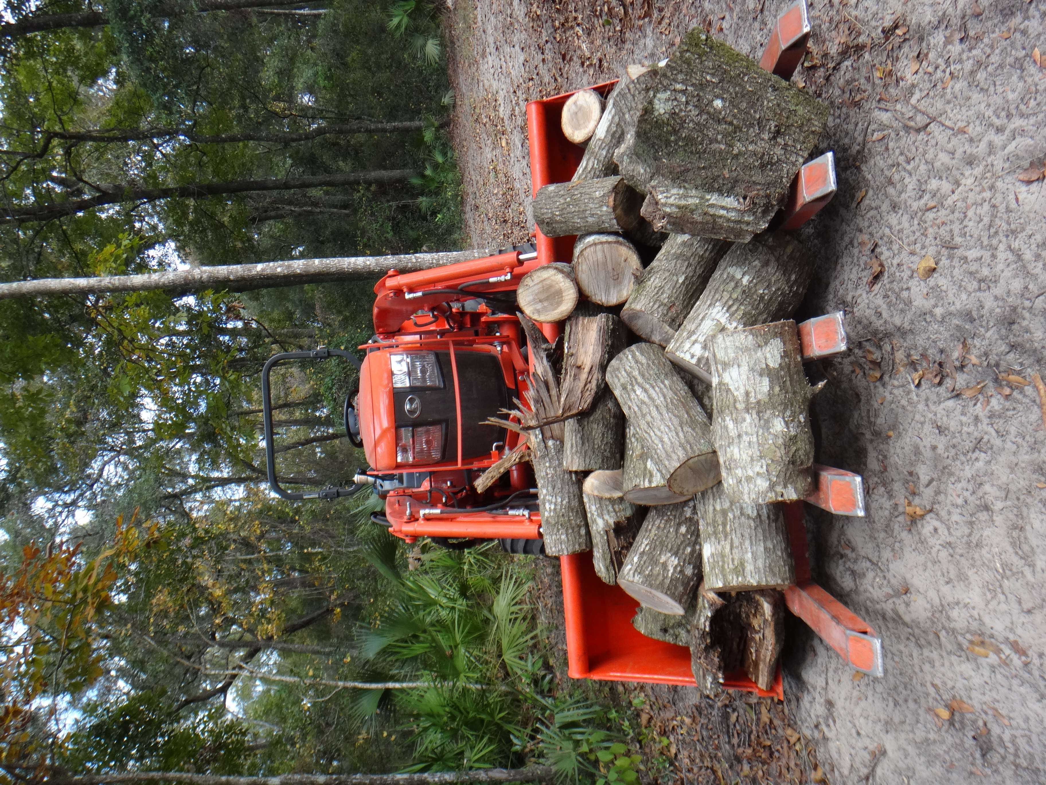

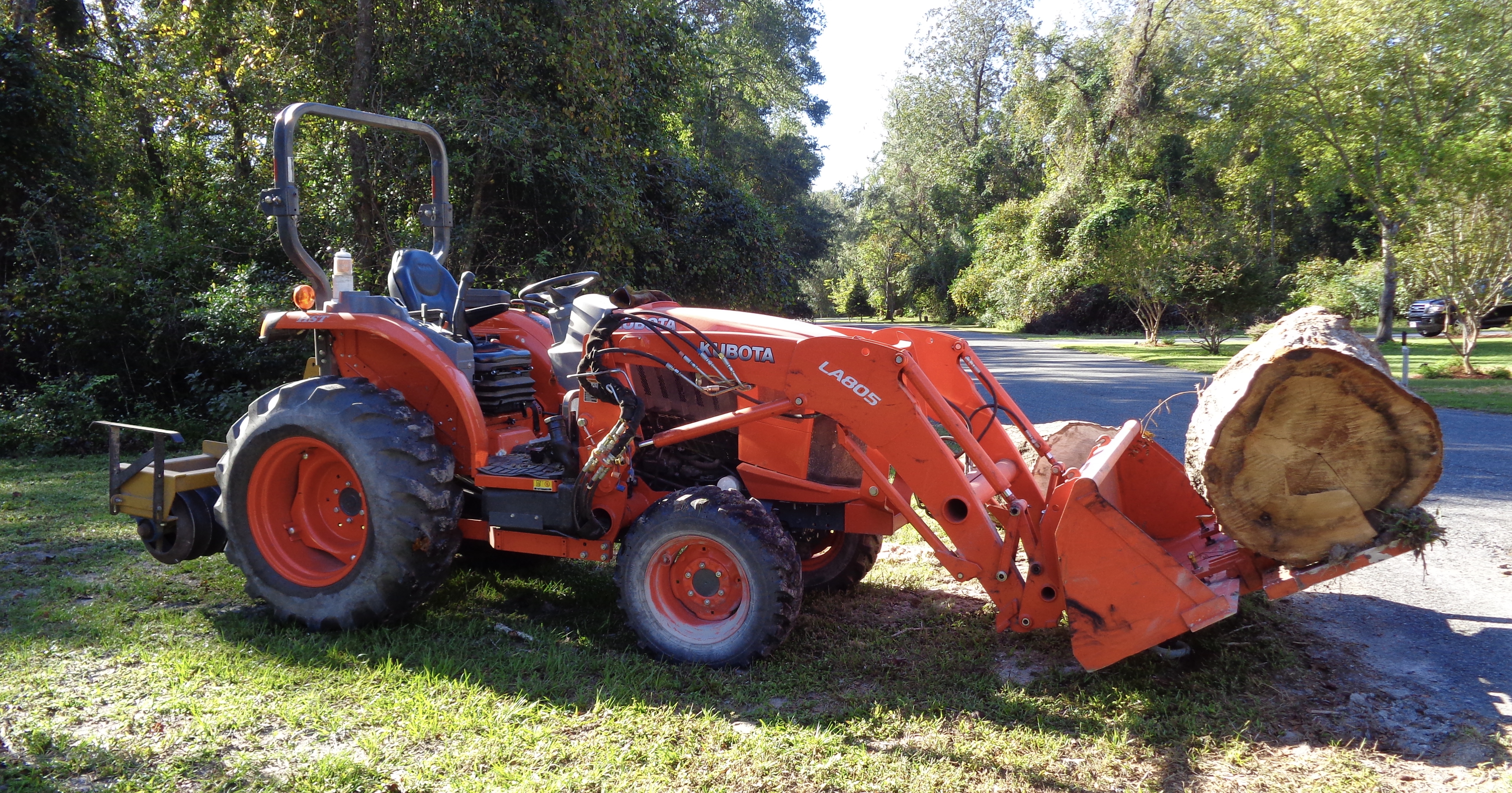

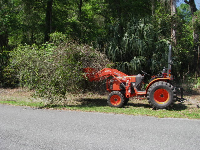

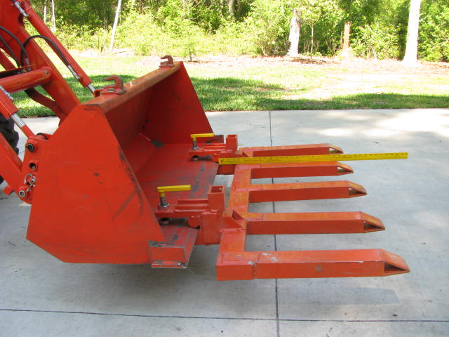

On a tractor of this age I suggest clamp-on bucket Debris Forks or clamp-on bucket UltraForks in 24" length.
The mods you are considering may cost as much as you are likely to pay for this tractor.
HIGHEST QUALITY FORKS: Tractor Debris Forks
ULTRAFORKS: Multi-Spear Ultra Fork
