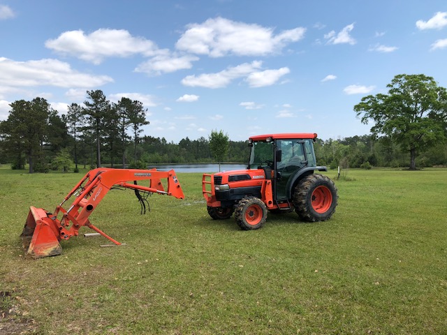

Removed the FEL so I could clean the tractor and inspect under the hood. Can't believe how easy it is to remove and re-install the FEL. Amazing engineering.
The tractor was starting to look like a dull orange but a little rubbing compound and wax and the deep orange color came right back. Other than a few scratches and dings the tractor looks as good or better than some of the new units I saw on dealer lots. You would never know it is 12 years old by looking at it.
Very impressed with Kubota and glad that I took the cumulative advice of TBN to get more HP than you think you need. I would not have been happy with the L2501 or 1526 that I originally considered.

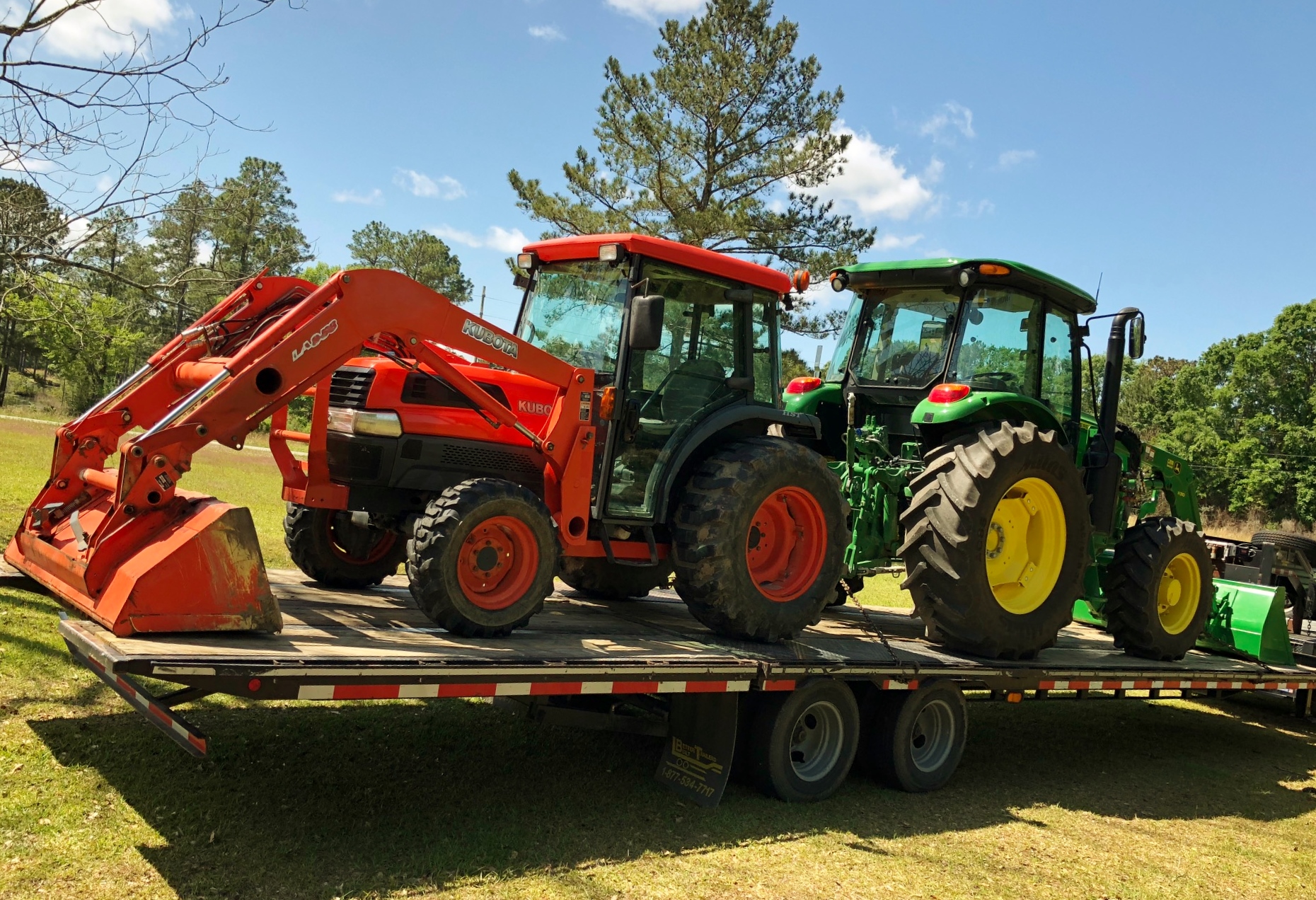

She's headed to the shop for routine service. Figured I would have them look it over and do the first service as I was waiting on the owner's manual to arrive from Messick's.
Here's a photo
