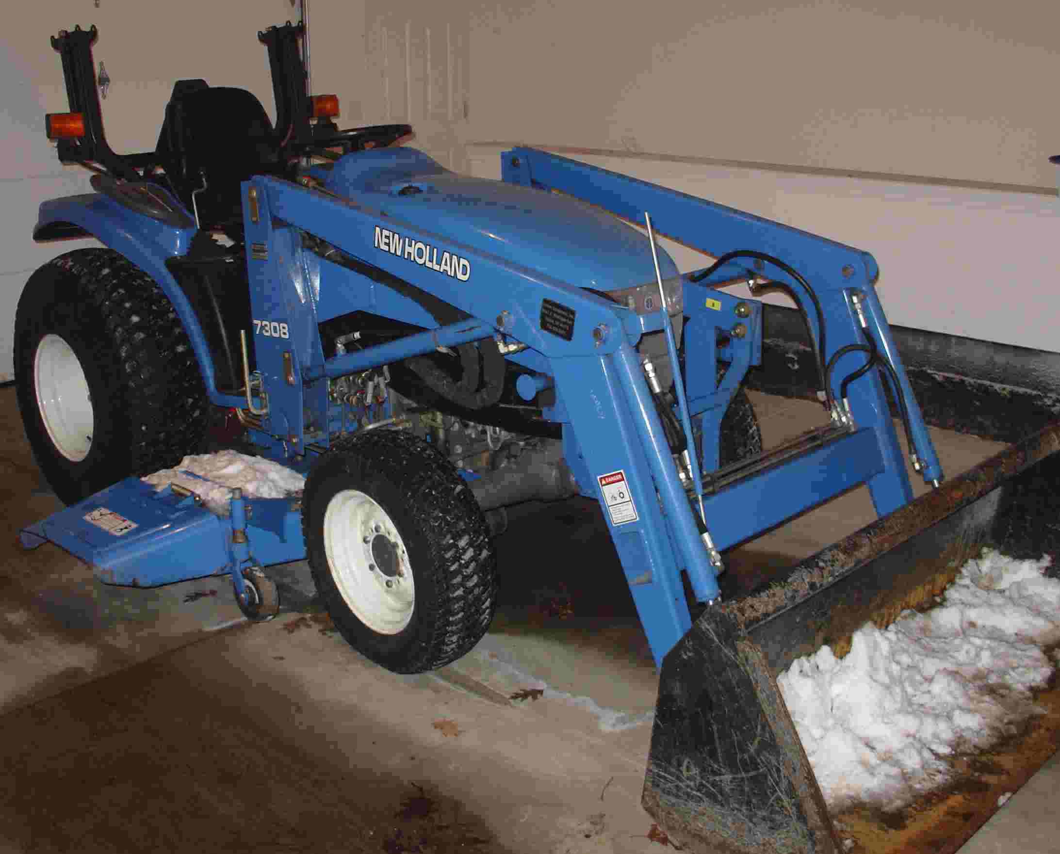

Brougth it home. Here are a couple of pics.
It does need a battery box (or gel cell) update. Besides that, it looks just barely broken in.
Bring on the work!

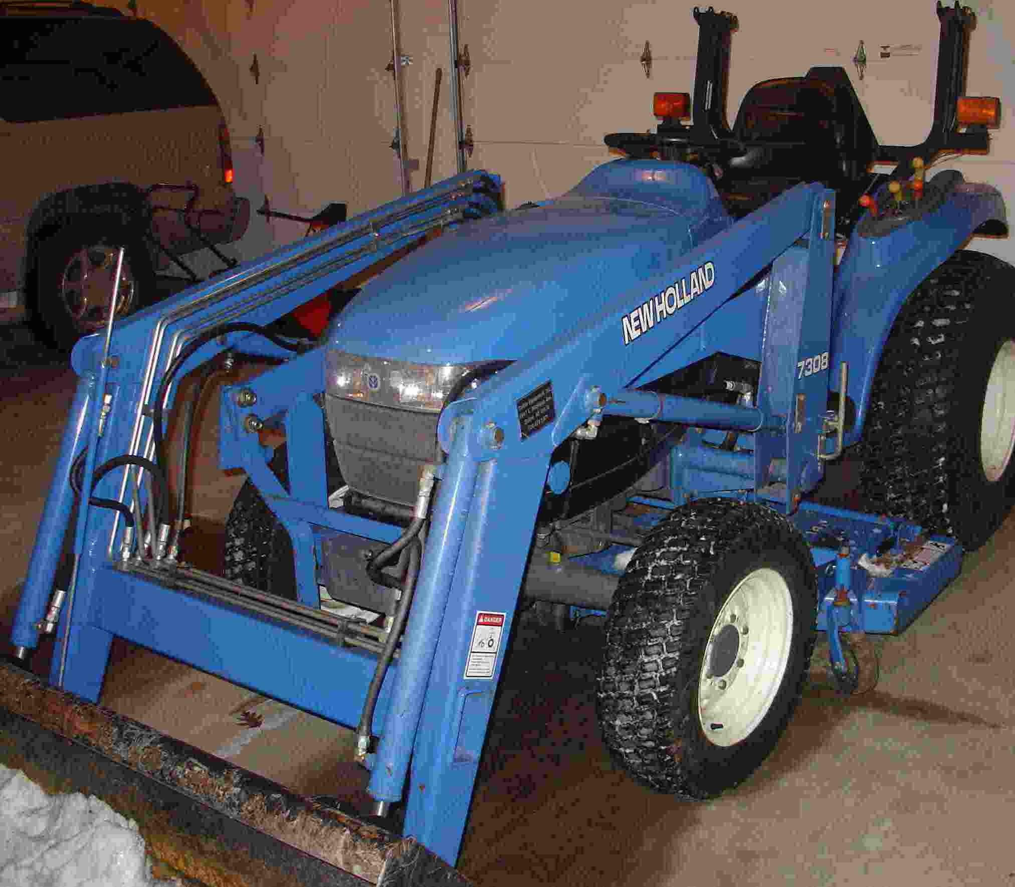

   / Used TC29D deal
And another.

   / Used TC29D deal #9
<font color="blue">Bring on the work!</font>
Congratulations.
Now - be sure to remove that MMM before plowing snow, or we'll have to report you for tractor abuse /forums/images/graemlins/shocked.gif /forums/images/graemlins/tongue.gif
Enjoy, be safe, and keep the pictures coming.
   / Used TC29D deal #10
Hey she looks great but what's that white stuff in the bucket? You should have the seller remove that - could get in the way as you grade for your palm trees & cactus garden. Enjoy her - Buckee
