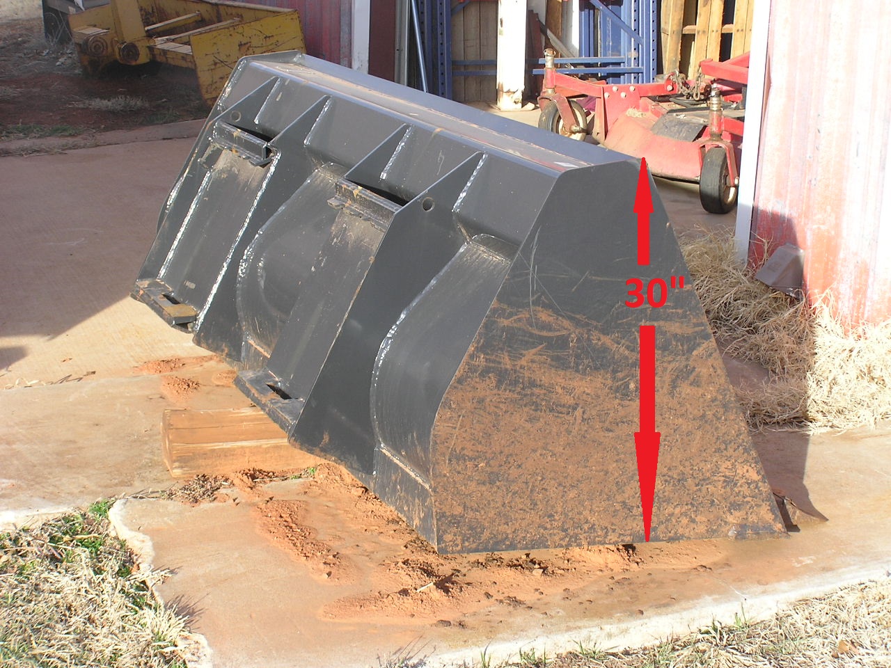

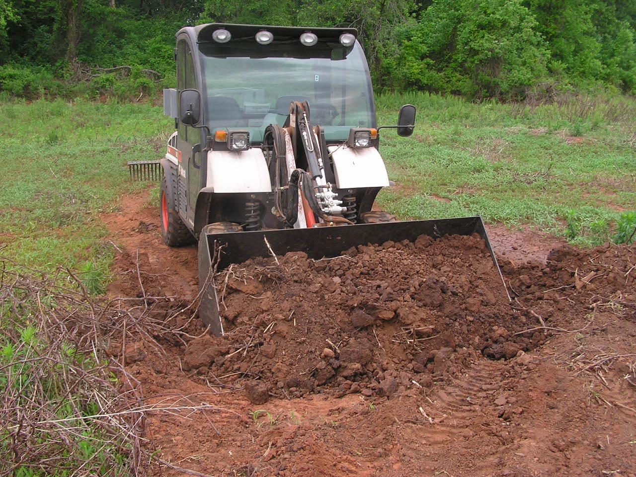

I am using the 72 inch wide, one cubic yard "special Versahandler bucket" that I already had for the V417:
Here it is on the 60 inch wide Toolcat:

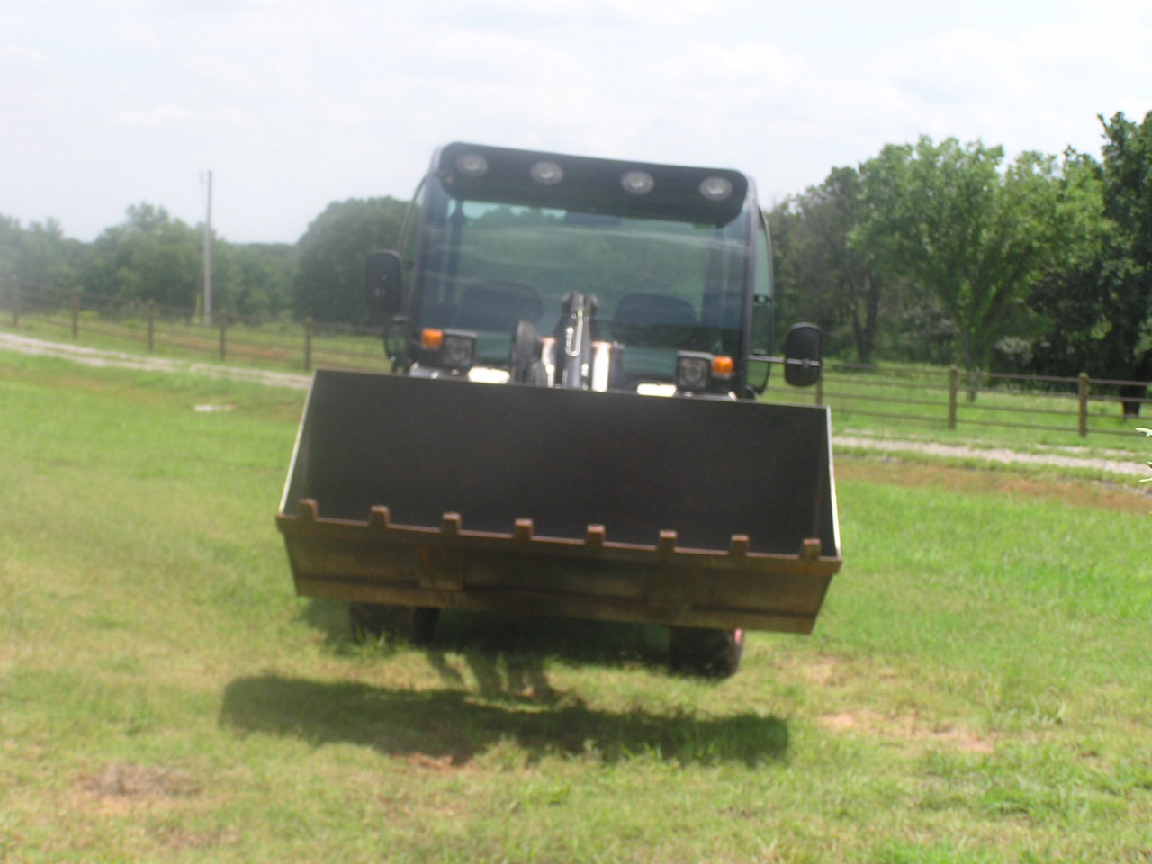

im running a 90 inch high dump for snow removal, also a 84 inch rock bucket to sieve gravel
   / Used Toolcat Questions #15
its big but I can clear a lot of snow, its close to 4 feet deep and 3 foot tall, full of snow depending on moisture it is a hard lift, will try to get a few pictures next couple days
