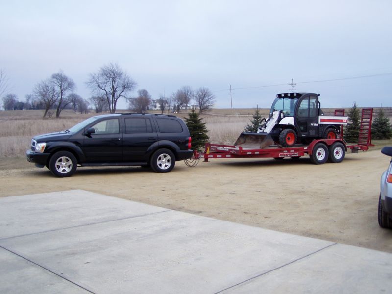

Add me to the list of owners ..... I've got a 2003 44hp with 230 hours. This unit was owned by a lady with 170 acres. Most of the hours are from mowing. She used the snowblower one time, used the grapple to feed hay to a few head of cattle and clean trees/limbs in a woods on the property. The unit had never been off her property. Everything is in very good condition.
This is a later 44hp model. It has the same front hydraulic hookups as the new ones versus the early unit style. Options include AC/heat, mirror, bedliner, rear window guard, attachment control kit and front/rear light kit.
Attachments include bucket (60"?), utility grapple, SB200 (66") snowblower and 72" finish mower.
Attached is a pic of the Toolcat still on the trailer when I got home.
dsb

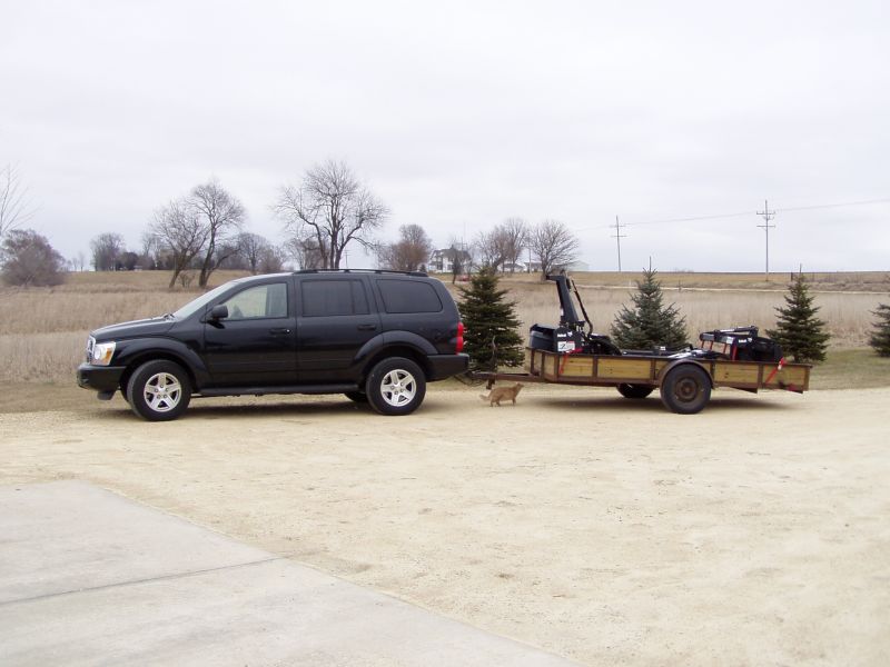

Another pic of the attachments still loaded.
dsb
