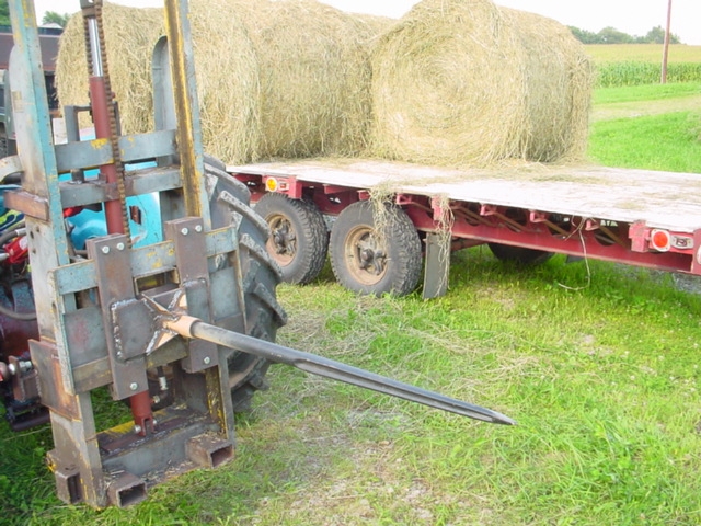

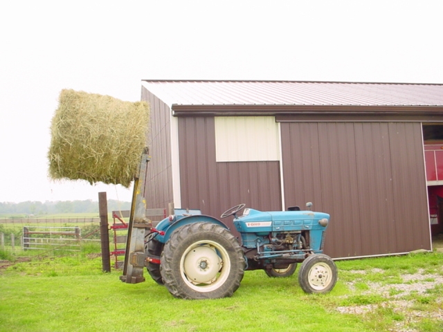

How about a 3 pt. forklift..?? I originally built this, modifying a hyd. pallet jack to stack round bales in my barn. Remove two bolts, and loosen two more, and the spear comes off to put the forks back on.
Got a 2" X like 104" cylinder from Surplus Center to replace the jack cylinder, as it was only like 3/4" bore.
Dad bought 2 at an auction for $25.00. The tag on it says Cap. 1,000 lbs. Those bales weigh in at 580 lbs ea. Lifts them easily...
Plus, handy for moving, and stacking palletized things. I even used it to set my waste oil furnace up on it's stand, approx. 7' high.
Not used all that often, but worth the space to store in in the barn, when I need it. Got about $250.00 in it, + my time...

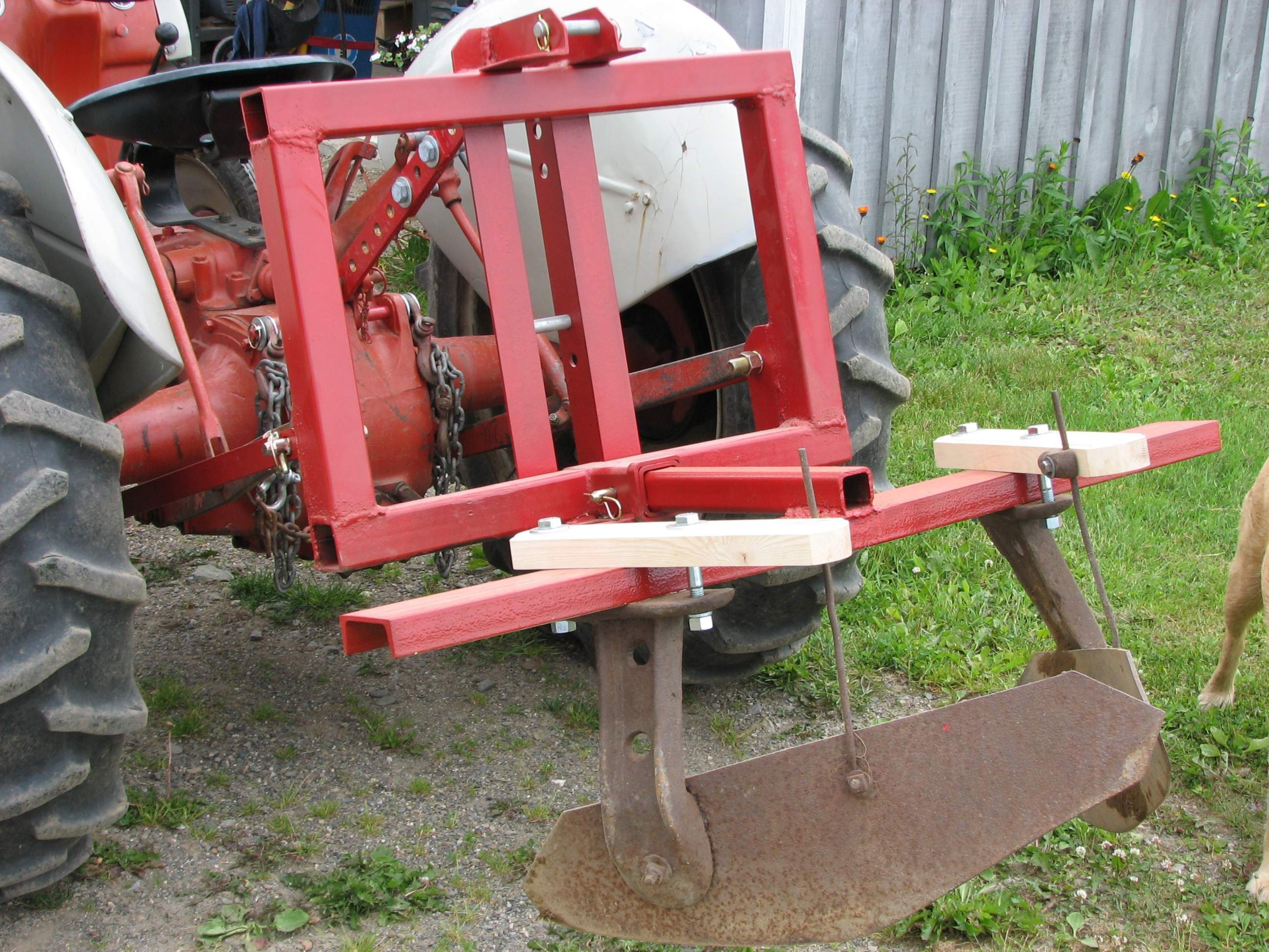

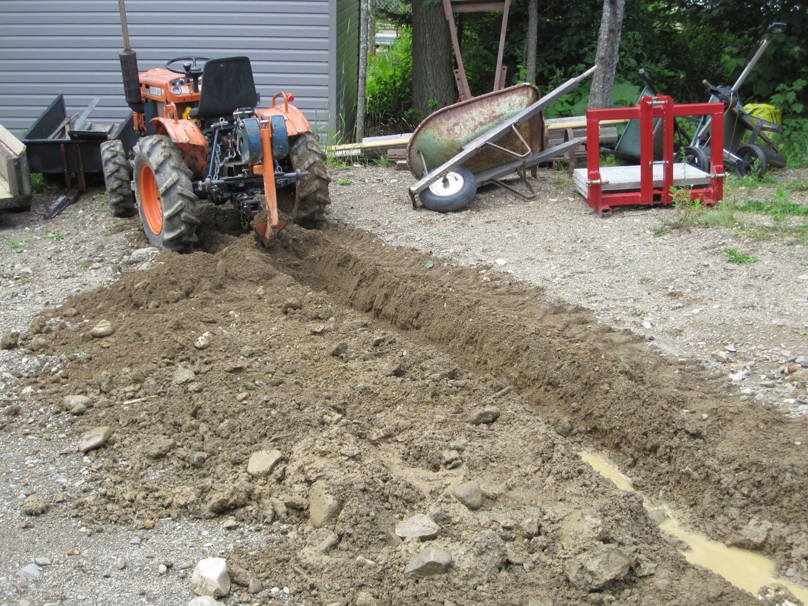

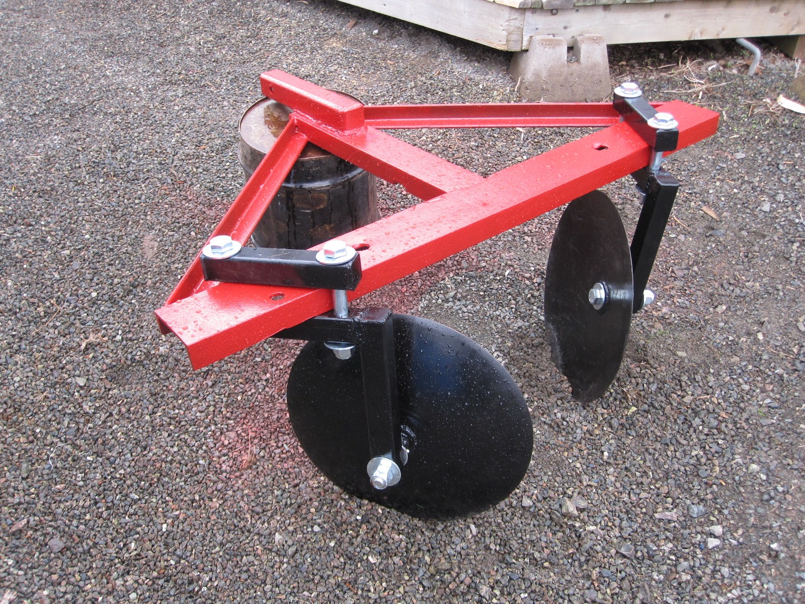

I have built all my attachments for my 1980 Kubota B7100 - 1 hiller from an old horse drawn set, 1 hiller from a couple of discs from a disc harrow, a middle buster/potatoe hoe, a 3 point rear blade, modified an ATV plow for the front using a 12v winch to raise/lower, salvaged an old pull behind spring tooth harrow & used the bits & pieces to make a 3 point harrow/landscape rake, a 3 point fork lift that can be used on my '47 Ford 8N also.
