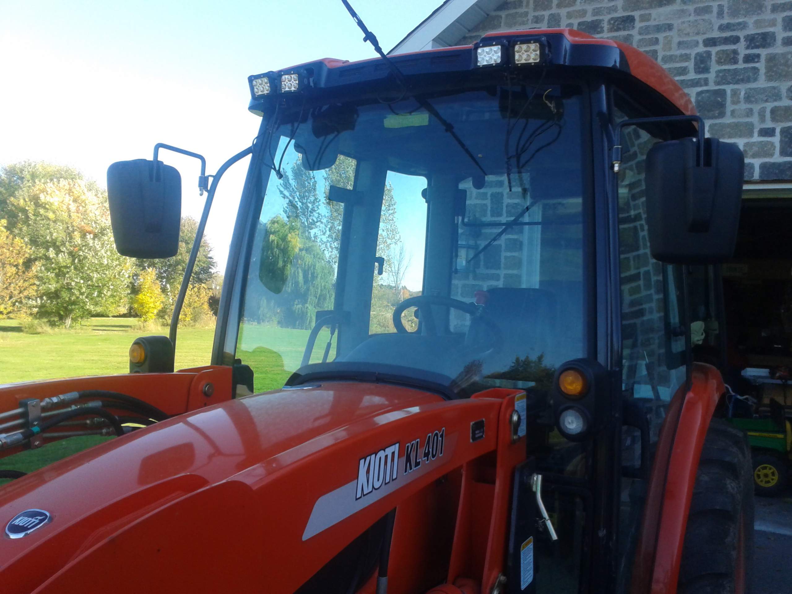

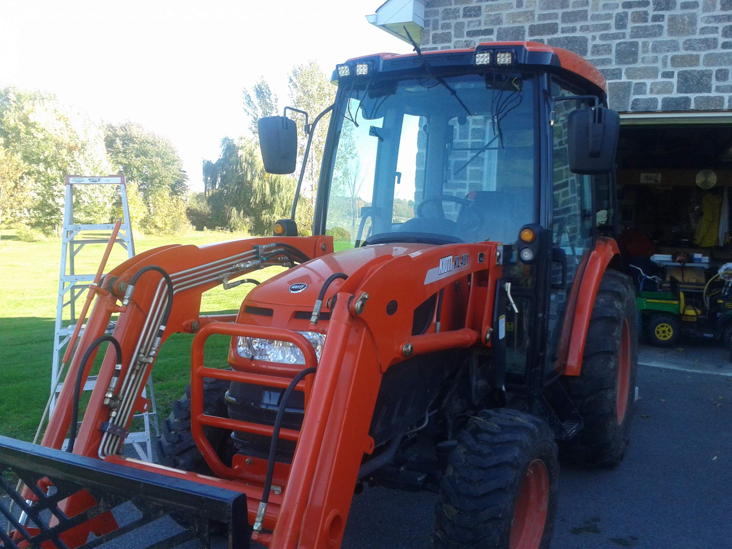

I'm adding LED work lights to my DK45 cab. They are 18W and I'm installing 4 in the front and 4 facing the back. Looking at the wiring harness at the switches, there's one unused connector. Is that from the "users power1" or "user power2" circuits?
I'm total clueless when it comes to electrical wiring, I was planning to copy what they did for the existing work lights. Should I run new wires back to the fuse box or can I use the single unused connector to feed two switches, one for the front and one for the back?
Thanks

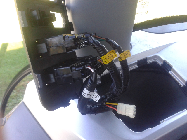

Thanks guys. For some reason, 12v wiring just flies over my head. What I was hoping to do is use the extra circuit Kioti leaves for us to feed two switches, one for the front and one for the back. I'm not really sure how contactors or relays work but I was thinking that since it is a 20A circuit, I would be fine since all my lights are only 12.
So since I really don't understand what I'm doing and I don't want a repeat of PickeringChris experience, I took another look at what was there and decided to ditch the OEM lights and replace them with the LED's. I modified the brackets a little, changed the way the LED mount on their brackets so that I could mount two lights on one bracket and I'm off to the races. I figure the old ones were 55W, or 110W for the front and the new ones are 18W X 4 for the front or only 72W total, so I should be OK, right? Anyway, I roughed it all in and installed it loosely and just went out to try them out in the dark. HOLY CRAP !!!! :eek: They're bright, and I only have the fronts done so far. It works well since I have two pointed a little lower and two pointed up for distance. I have a slightly different plan for the back, but I'll do the same and ditch the OEM lights.
So, is that unused connector (bottom of the first pic I posted) the 20A circuit they leave for us?

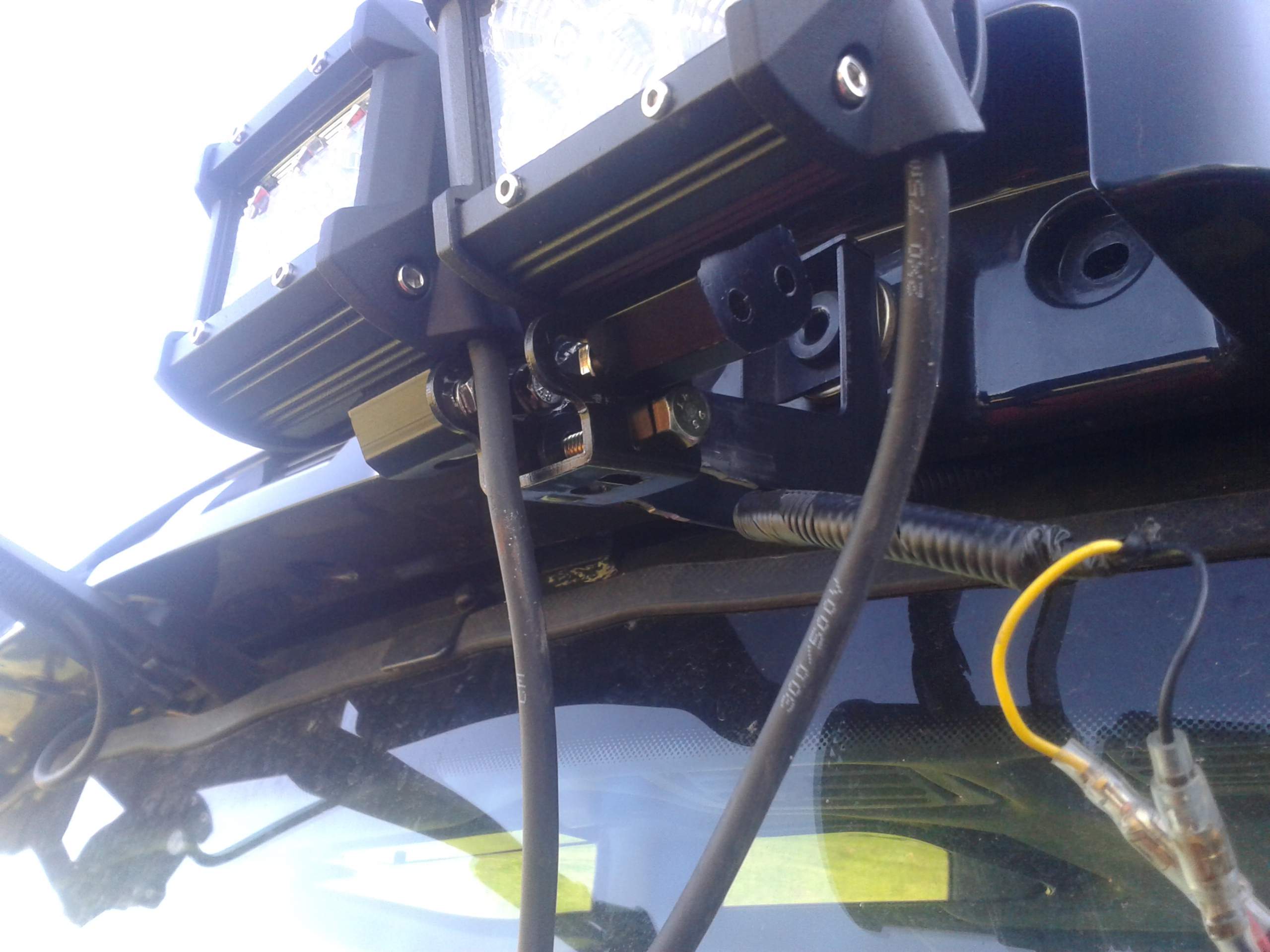

The white connector on the harness you accessed in your cab is marked user or something similar. It can be used for a work light or whatever so long as you stay within the amperage rating of the fuse that it's wired to. The most basic difference between AC and DC voltage is that DC is direct current, fed from a 12 volt supply, your battery to a hot and ground returns to actual earth, via the chassis and tires. household wiring is a hot, neutral and a ground which also makes it way back to earth through a ground rod driven into the ground. Most off road light kits come with a wiring harness and a relay to allow one to wire them up fairly easily. The advantage you have with your LED lights is more light with less amp, (current) draw off your battery. And less heat generated, longer bulb life, and just better all round look too. The fuse acts like a house breaker- when there is too much draw, of current through the wires in a circuit, the breaker, or in the case of 12 volt DC, the fuse breaks(opens) and allows the wires to not burn up. The relay helps reduce the current in parts of the wiring and allows the lights to be controlled by a switch in the harness which closes the circuit through the relay and lights your lights.
If you put a space between each pic you upload, between each attachment they will have some room between each and be easier to view on the page...
Nice job; now use some dielectric grease to seal the ends of those bullet connectors. Ideally you'd use heat shrink tubing to make a waterproof seal on each.

grs, rmorey, CM, I appreciate the info. I did look up relays and contactors to try and learn something for next time. I'm still confused about them and why they're needed (not that I doubt any of you at all) and why a switch can't handle 6 or 12 V, after all, household switches can handle 15V. Do the factory switches simply control relays somewhere before they hit the lights, both front and back?
I was also having a hard time understanding why there are 3 wires from the switches. Rick mentioned that you need to wire them in parallel, so I was kind of assuming there's a hot wire for each light on the circuit and one ground wire that's shared. Now that you guys are talking about relays (and assuming Kioti is using one), I'm confused over why there are 3 wires again. Wouldn't you have power to the relay (2 wires), a switch connected to the relay (again, two wires) and 3 wires running from the relay to the two sets of lights?
CM, for you, I'll start adding a space. I thought I was being nice by at least breaking them on to separate lines! Those bullet connectors have something in them from the factory, not sure if it's dielectric grease. I can't use heat shrink tubing since the lights have to be disconnected in order to open the roof panel of the cab (along with the radio antenna). Kioti did a poor job IMO with access to the roof, not only do you have to disconnect the lights and radio, you have to remove the grey light bar at the front of the cab.
