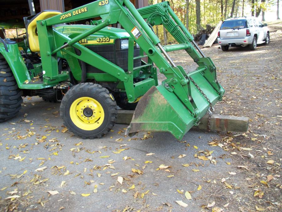

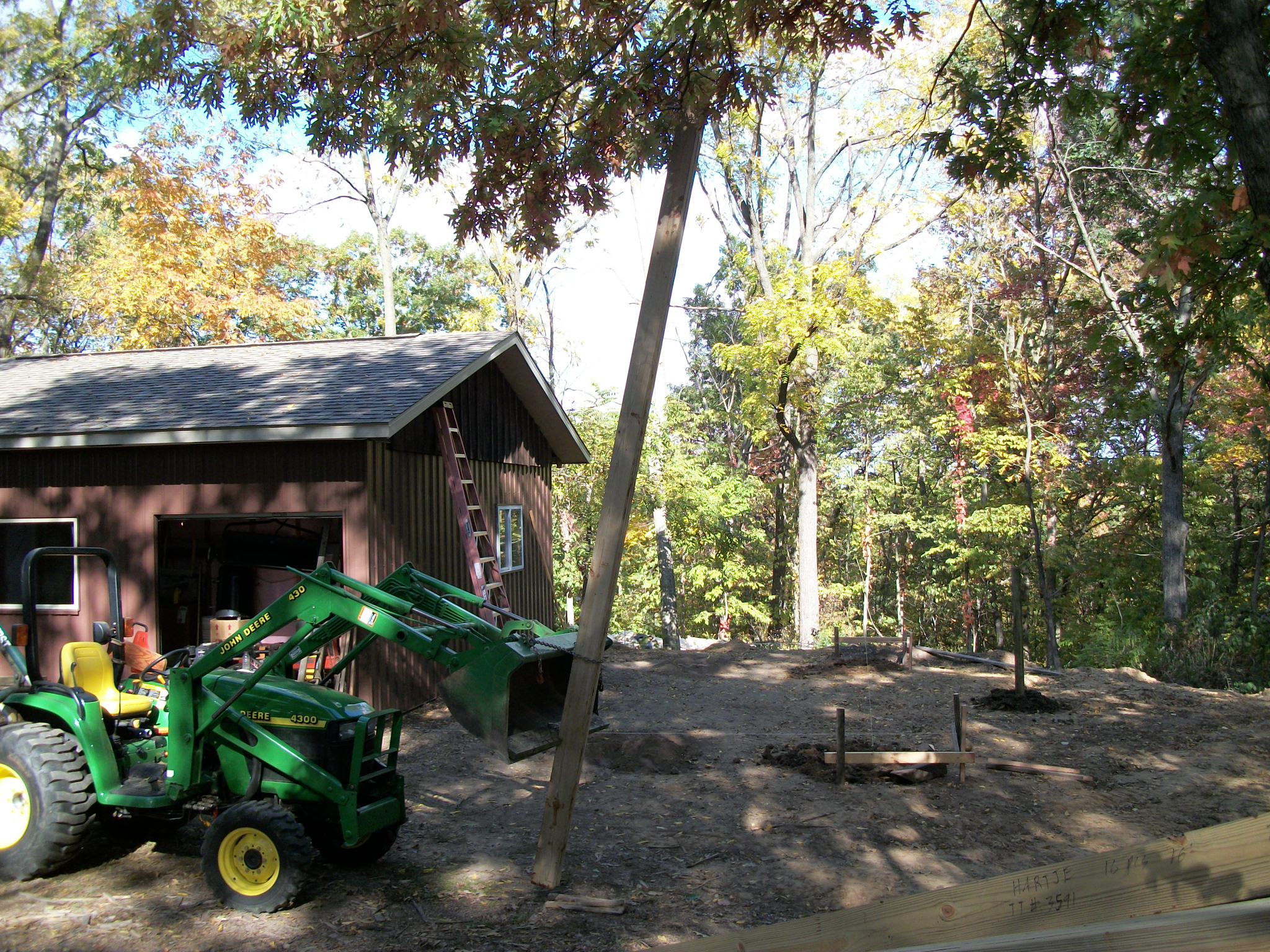

Another use was to set four 16' 6x6 treated poles in dug holes when working alone.
First tested out some rigging using a short post. Then as it appeared to work well, strapped down the 16' at a height that allowed room under the tractor for the butt end and also distance up to be able to set the pole in the hole. Worked well, without a hitch.
