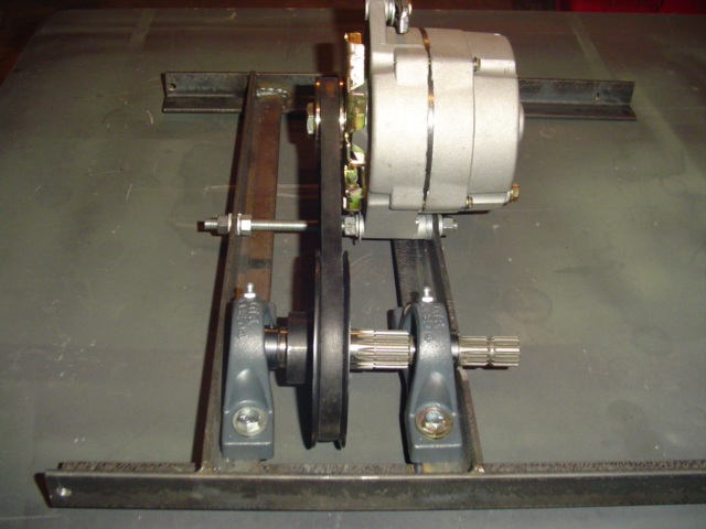

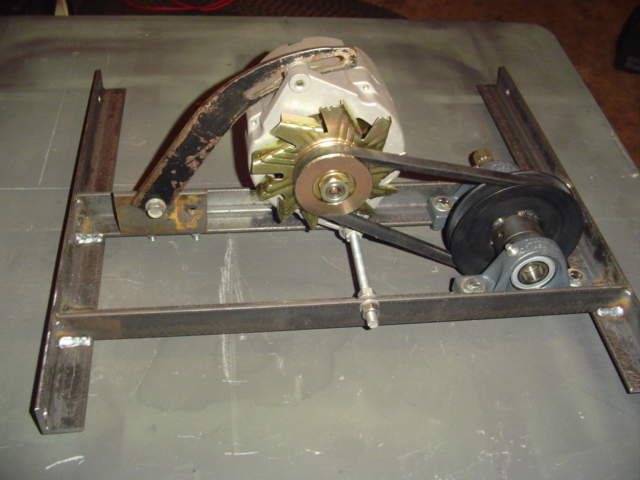

Someone made an axillary power supply to use the front PTO...

Simple, but I'll bet it works :) Wonder what they use it for?
Any mid-pto I've seen was tucked in close enough to limit what can be connected, so IMO the sub-frame and belt drive are more than clever. That said, what if a guy used a shaft with double cardans to add an auxiliary hydro pump. If ground clearance wasn't compromised by any addition it might then allow using a hydro-motored front accessory (PHD, etc) with shorter lines and w/o tying up the rear PTO. I'm sure some of us would think this to be simpler that shaft-driven front implements.
There are also belt driven pumps that could be bracketed like the alternator shown in the post above.
