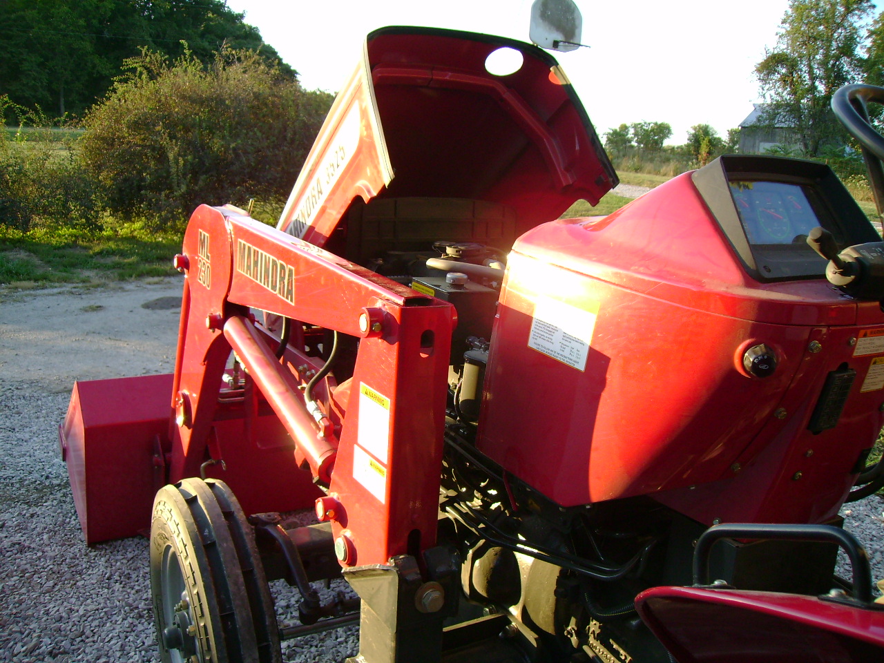

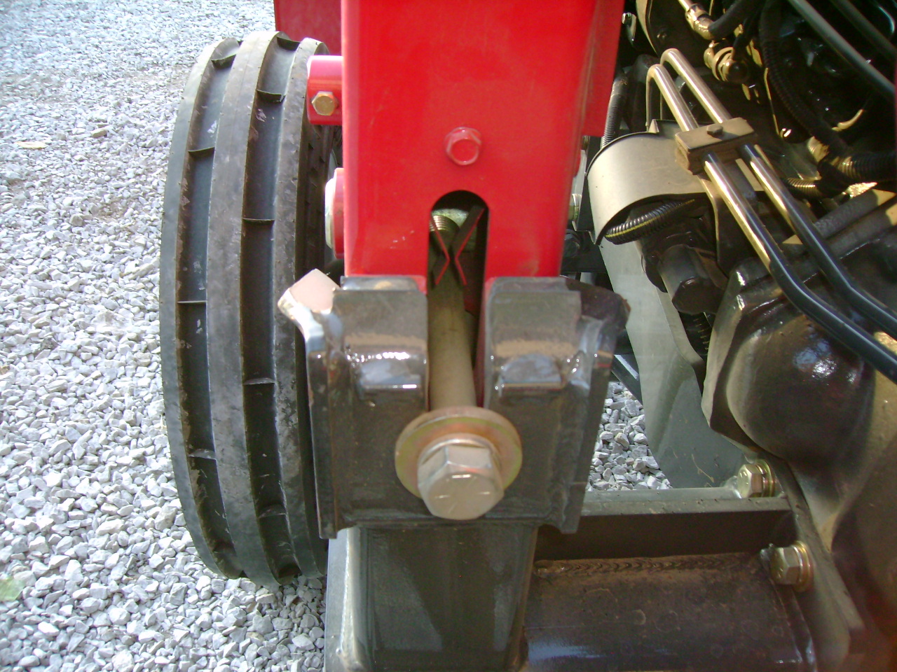

Warcat,
I don't have any good pics of the exhaust, but it exits under the right rear axle.
Here's a pic of the loader attach bolt. Attach the stands, then loosen and lift this bolt (1 on each side), curl the bucket to lift the frame out of the loader mount, back up a bit to get some clearance, then disconnect the hyd hoses, and the loader is off of the tractor. I think that's how it goes anyway, I've never had the loader off of the tractor yet... haven't had any need to. I think after you've done it a time or 2, it would take about 5 minutes or less to remove/attach the loader to the tractor.
I got real camera happy one day with my 3525 (I actually wanted to see how many pictures I could take on 1 battery charge in my camera and the 3525 was the subject), and took pictures of about anything you can think of on it (except the exhaust outlet :rolleyes:), so if you want to see a pic of anything, let me know, I've probably got a decent picture of it... I've got over 175 pictures of the various parts of my 3525.
