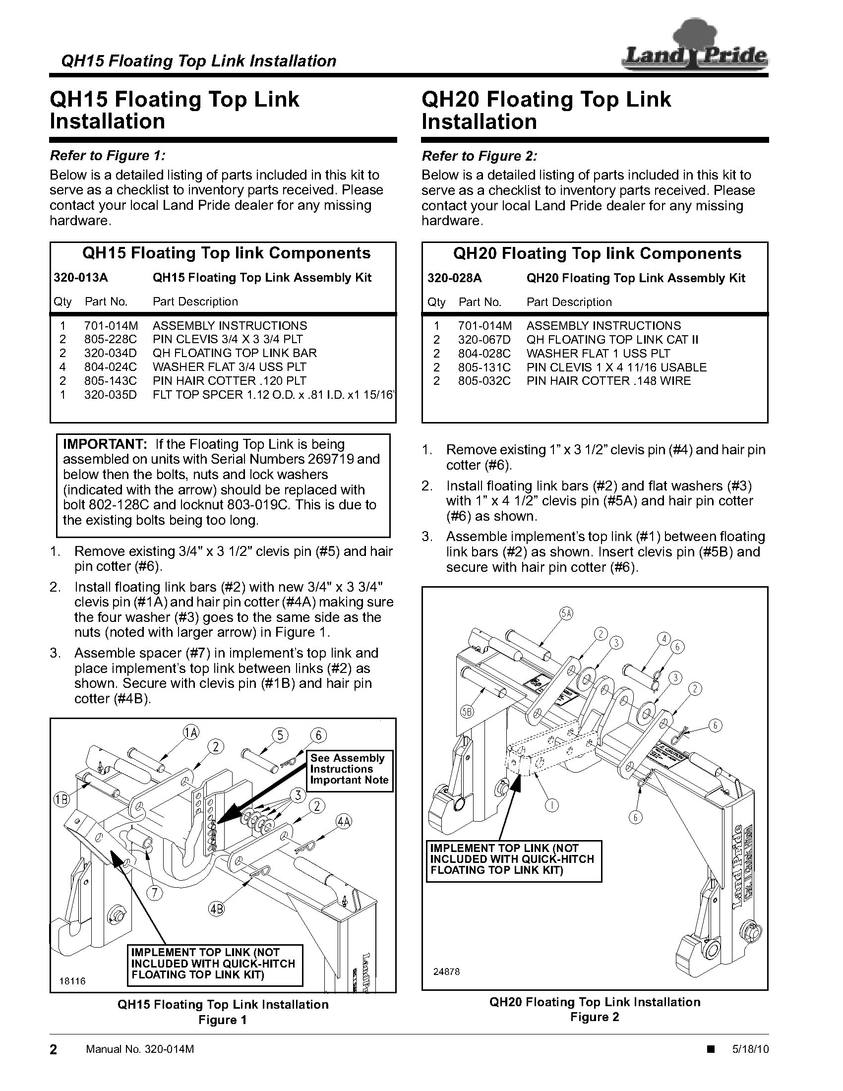

See the picture of the LP floating top link. That is what I use for all contour following implements. It appears to probably be safer than a chain. My QH is equipped with one to use when needed. Top Link.jpg this comes from the LP QH Manual available on line free. This manual also has all the various lengths of lower and top link bushings for the QH.
Ron

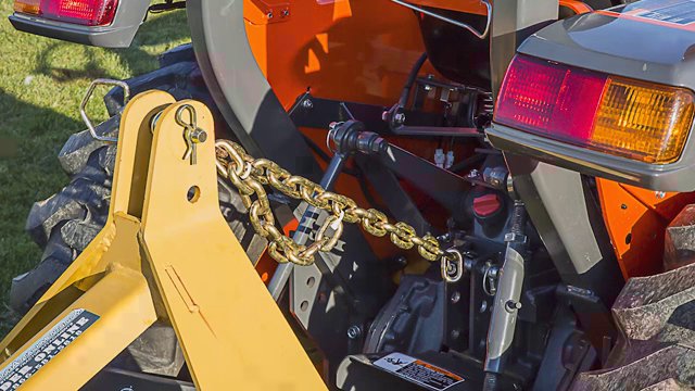

Yes, if the chain is the same length as your top link was adjusted to, it will lift the back of the implement to the same height. If the chain is longer, it won't lift as high.

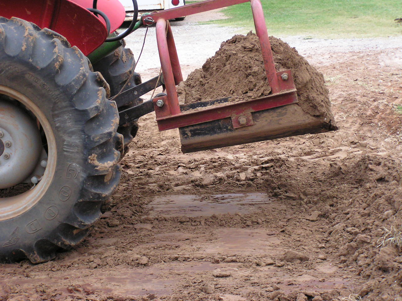

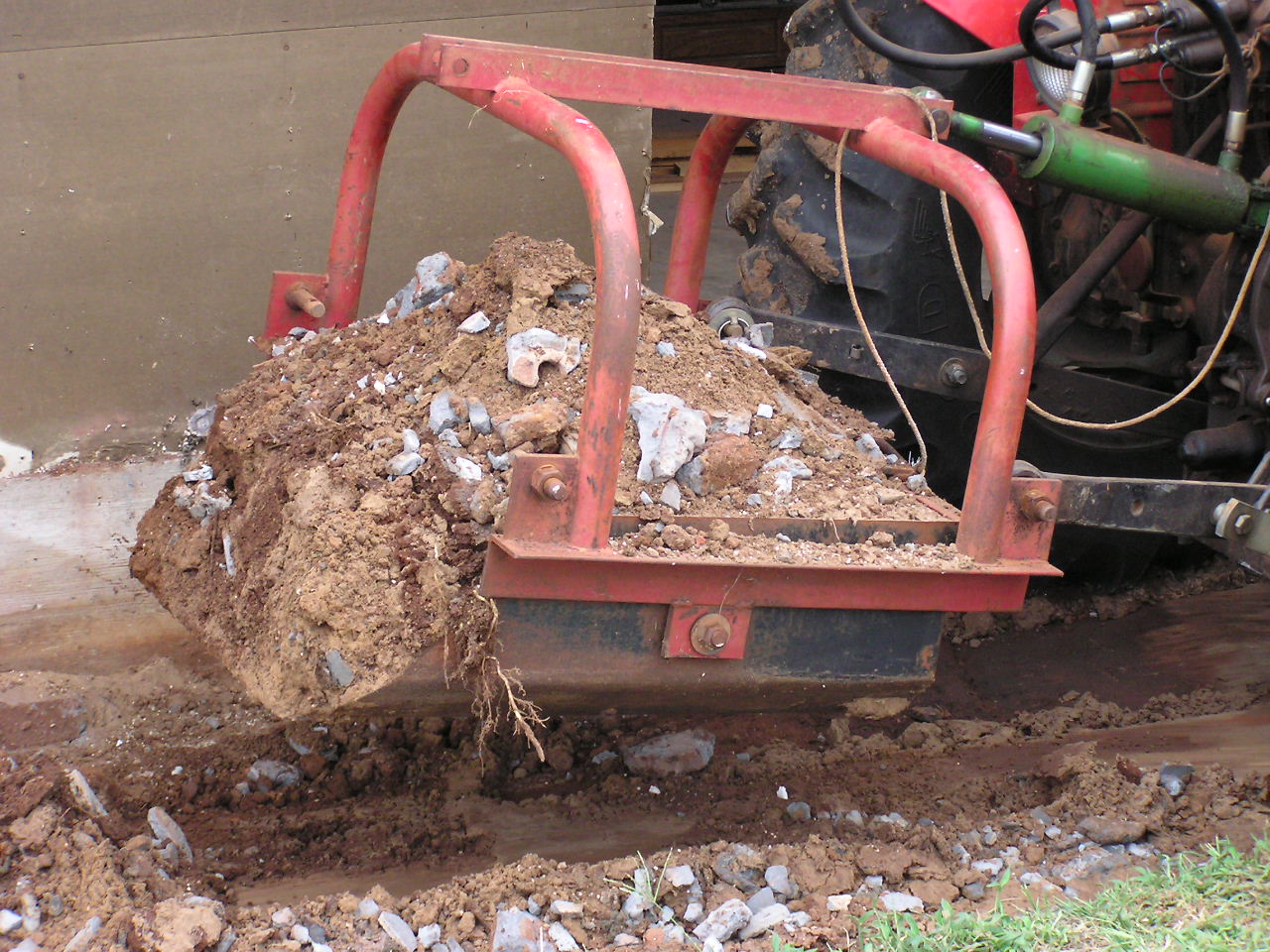

thanks Pat; I also have a rear scoop for my tractor and have used it a lot. Purchase from TSC. Only problem I have had with the scoop it that it has a trip mechanism located at front bottom that has to be pulled upward by a rope. I have found that when I try to dump contents from the scoop, the trip lever is very hard to pull upward by the rope in order to trip the scoop. Maybe it would be easier if I used a chain as top link. Haven't thought of that.
Thanks;
Red
With a chain you would not be able to set the digging angle or pull it in the forward mode. I had a hydraulic top link on mine, made it easy to get the right angle.
Notice that most of the weight is behind the pivot point of the scoop.
To dump, I would lower the scoop to the ground, removing the weight from the trip latch, pull and hold the trip rope, raise the 3 point, dumping the load.

Yes. Xfaxman explained it best. Your chain could be somewhat longer than the toplink - the rear of the drag would just droop some when you raised it. The great thing about using a chain is that if you find it's drooping too much, you can shorten it up by a couple of links and see if that works.
