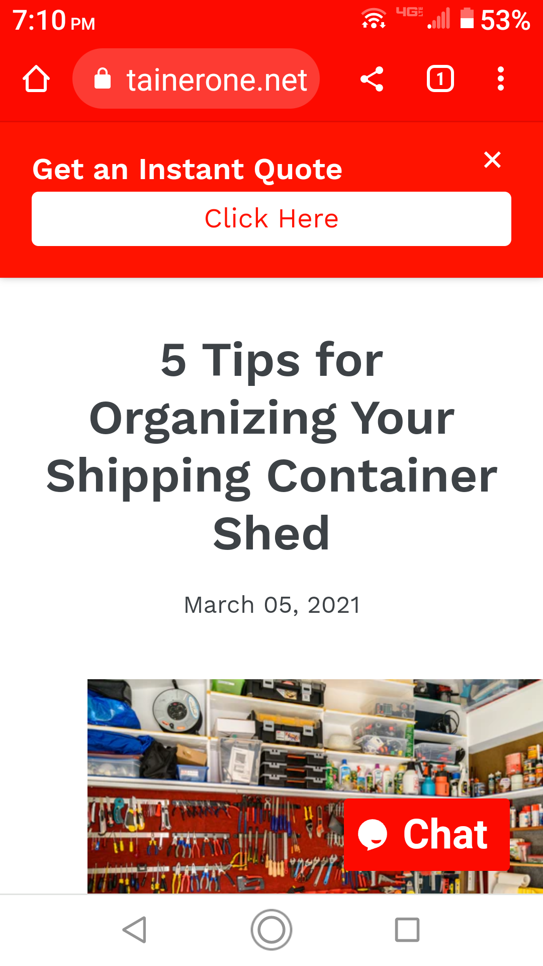

I have a 20' on my hobby farm yard the inlaws use for storage when they downsized. Possible ideas for utilizing wall space? Imo it can utilize a smaller spaces using 8' walls being some what organized however it won't be very useful if it's unorganized and stuff ends up piling in there making it ramped. 5 Tips for Organizing Your Shipping Container Shed
