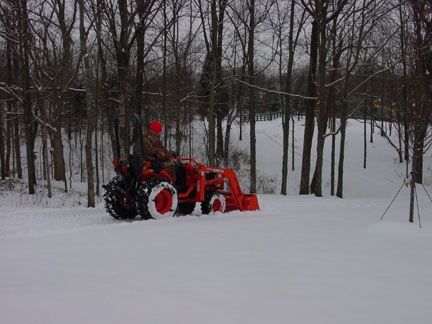

Duane-I used the FEL on my B7500 for my first time to remove snow today and it worked just fine. I don't have a rear blade and can't afford to go out and get a plow. It was a powdery snow and we only had 6"so I guess that made it somewhat easier. It takes some experimenting to get the right angle on the bucket but, once you get the hang of it it works real well. I have a 350' asphalt drive which took me about 21/2 hours and as far as I could tell I didn't do any damage to the surface.

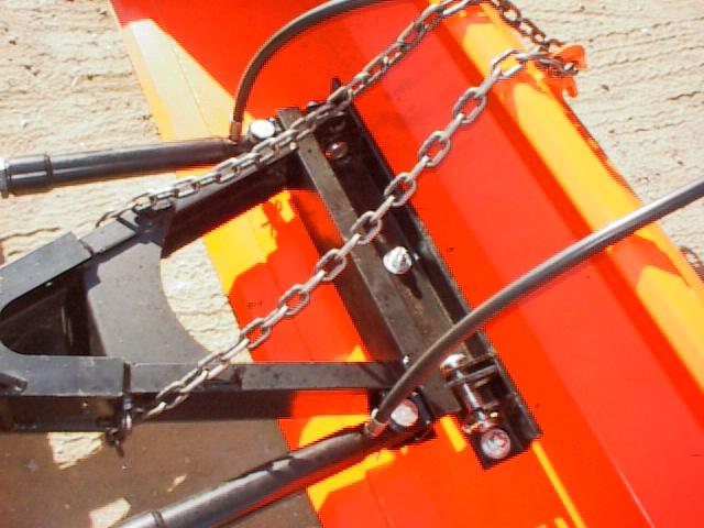

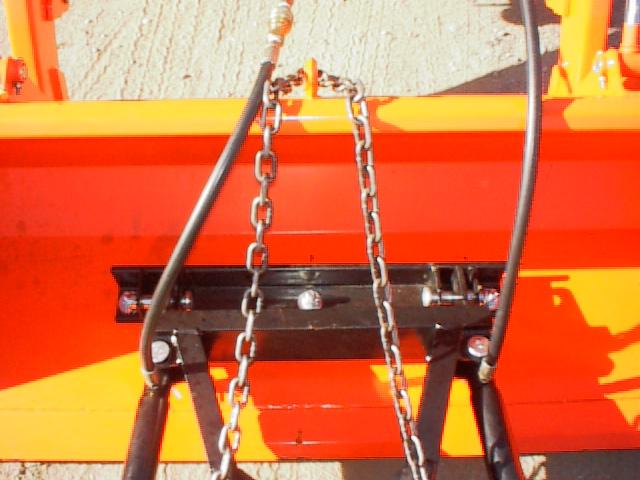

Hazmat,
This is a Really Simple design for mounting a regular type plow into the bucket of a tractor. 2 pins, 1 chain and your hydrolic hose if so equiped and it's either on or off and then you still have your bucket attached for snow banks etc.
I am posative that anybody who can weld (I can't) could thow this bracket together in no time.

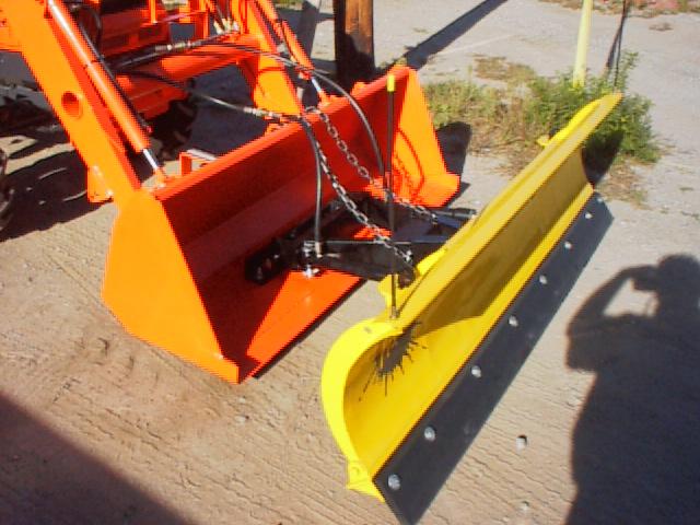

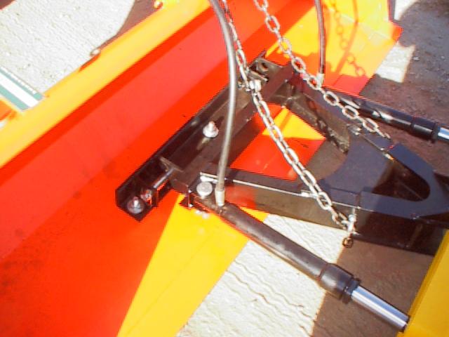

Picture 4
This is the way I will eventually attach mine when I stop procrastinating.

Is that a rubber cutting edge?
   / Using a FEL to plow snow? #20
Steven,
In answer to your ? <font color=blue>Is that a rubber cutting edge? </font color=blue>
Nope, that was / is a good old fashion bolt on steel cutting edge.
