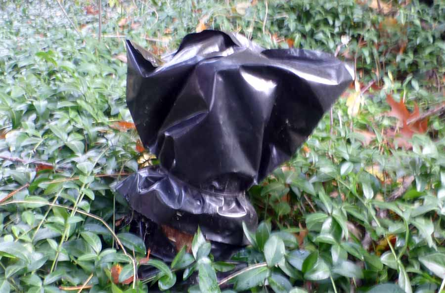

We bagged all the stumps around our property. No spraying involved. Have you been to a eradication seminar there??
Tell me more please
   / Using a forestry mulcher along with Garlon herbicide for Buckthorn control #22
Not here. It was a hay field and will become one again, as with other fields I have reclaimed. Environmentally dangerous chemicals unnecessary.
   / Using a forestry mulcher along with Garlon herbicide for Buckthorn control #23
Tell me more please
Sorry for the slow response but here is a buckthron stump with a bag that will last at least 2 years. The bag is made for evasive tree eradication and is zip tied on. That way we don't need to keep treating the stump with some herbicide. Hope that helps.
