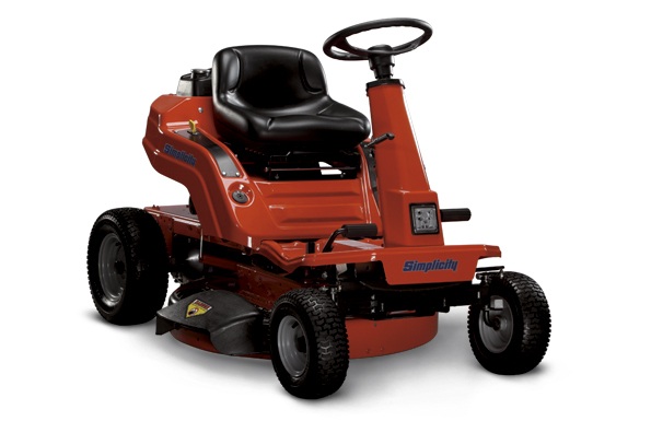

Thanks for the responses. Great ideas. I especially like the remote kill switch idea. I didn't know about those. I think that would be a great thing to have if I do this.
I've also been thinking about the wheelies and the freewheeling down a hill scenario. Maybe a rear engine mower would be a good candidate?
Good visibility with the rider up front, weaker motors with less power to do wheelies, if hydrostatic drive they would be less likely to pop a wheelie or coast.
And maybe if I can find a used one of these it could help with the $ also.
Any worries come to mind with a mower like this?
   / using a lawn mower for younger kids to drive around the farm....ideas? #12
It will pop a wheelie easier than a front engine mower. Go with a hydrostatic mower. I might look for one that has bolt on wheels (ie: where the wheels bolt on like car wheels vs sliding onto a shaft).

The tractor the kid use has a Hi/Lo trans. I fixed it so in stays in lo and can't be put in hi -period-. I can walk right next to it, so there is not any way it can go fast enough to pop a wheelie and the transmission acts as a brake going down the only hill on the farm. I like the kill switch idea, i have an old snowmobile with one that has a cord and a wrist band. On the snowmobile, if you fell off the thing with the cord on your wrist the other end would pop off the switch and if would kill the motor. I can put that on the tractor for one more safety device. Thanks, thats a good idea.
