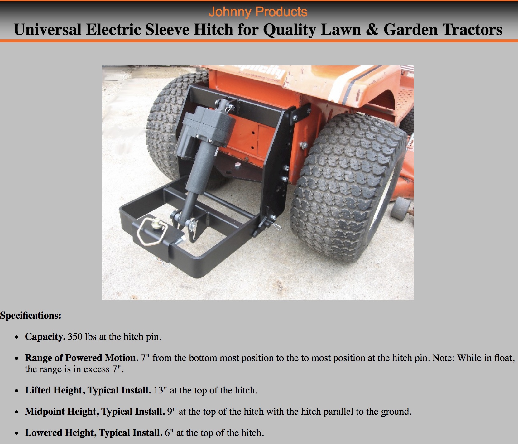

I have a Sleeve Hitch with an electric actuator that lifts and lowers a rear implement on my garden tractor. Johnny Products sells it. Not a huge weight capacity--around 350 lbs--but then it's a pretty small actuator. Nice thing is it has down-pressure, which helps since you're using a pretty lightweight implement with it.
Could a bigger one do the job? I have no idea, but agree it would be great if it could.
