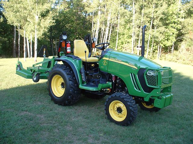

I have a farm king and It is 60" weighting at 550 lbs. I have 5 42lbs suit case weights on the front of my JD 3120 due to fact if you hit a bump in the road with it up you may be bounced around a little.
matthew

   / Using a Rear Finishing Mower #10
matthew
Is that armorall on the tires? ;)
