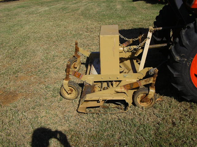

Does yours have the chains like mine? they give it lots of motion. Currently when I lift it the rear wheels are only a few inches off the ground, the fronts are much higher. So the top link is extended I guess. This would help some. I haven't messed with my Woods much except to heat and straighten out a few parts. It and the BH came with my tractor.
Mine is a 660, and it does have chains like yours, but since it is a gear over belt drive, the rear attachment point is on the deck rails. I don't think my chains have anywhere near the slack that yours appear to have, and my top link is extended nearly to the limit.
