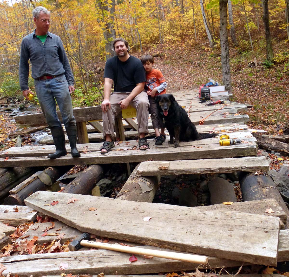

Oh, here is the last "pole bridge" we replaced as it was being dissembled. This was replaced with 32ft long I beam structure. No more poles bridges!
