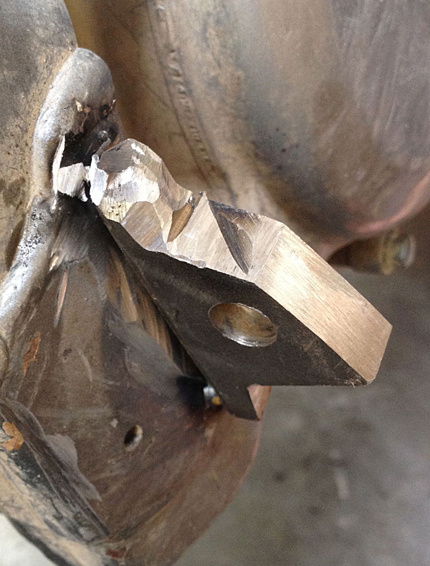

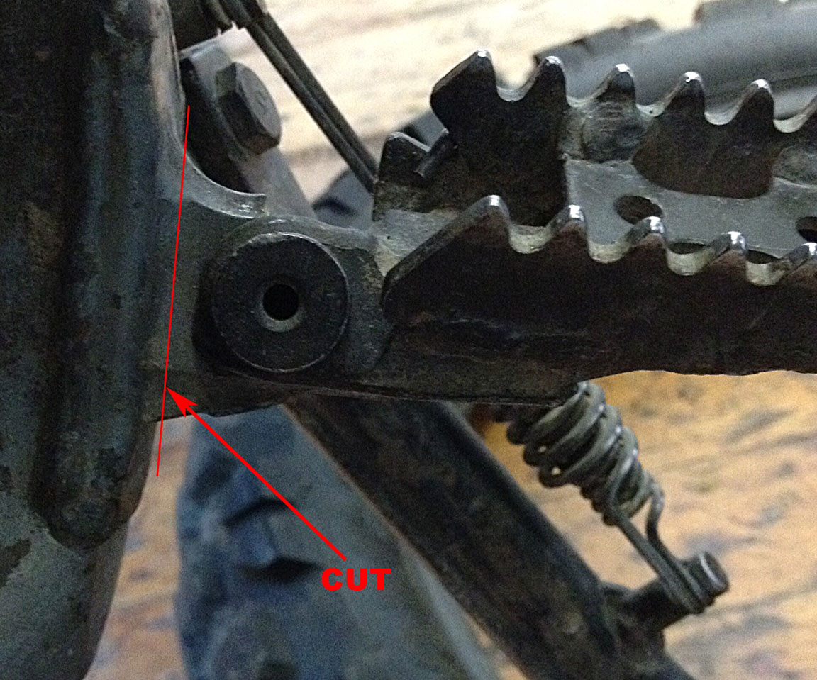

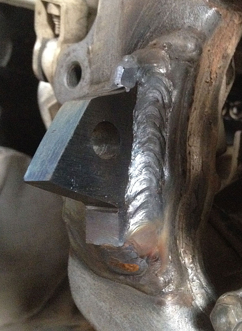

Heres a pictorial example of using the cutoff disk. This motorcycle footpeg mount was cut off with a harbor freight disc on an angle grinder. Also the replacement part (1/2" steel) was cut entirely with one HF disc. (The photo of the 'intact' footpeg mount is the 'other side'). I did the minimum work required (that the owner couldn't do) left him to finish it out to his satisfaction. And he did, all good!
