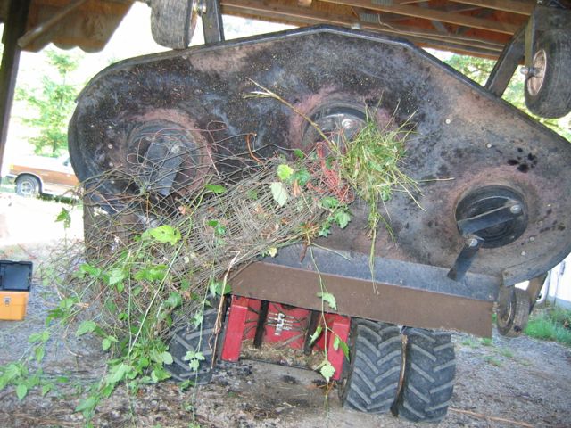

The one thing I should note here guys is that these bolts are held in with Caulk. They are not rusted in and there is little resistance once I get a grip on the bolt.
Here is a pix of the blade setup. Because this is a lighter weight cutter, balance is a key issue so welding needs a delicate touch,
You didn't find a lost roll of page wire fencing that way did you? :(:laughing:

As far as the PT bolts, and blades problems, being there is easier to determine a fix than from the armchair, but it does seem that a protector around the head of the bolt might be one way to fix it, but that does bring up the problem of raising the head by the thickness of whatever you use to bolt it down. However, going around the thickness of the blade might be a way to keep it low(er) than sticking a washer with sides that ramp up over the bolt head to keep deflections going away from the bolt head. I assume that the bolts are shoulder bolts, and step down at the entrance point to the stumpjumper.
