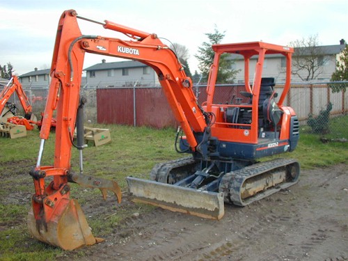

Oh okay, those machines...I just looked one up, odd looking guys. I know what they're used for though, I don't know if they would do you a whole lot of good. Can't dig stumps out, can't clear brush, can't really excavate except deal with banks like mentioned. It's up to you, I personally would have absolutely no use for such a machine in my life. /forums/images/graemlins/grin.gif But I would this machine, see attached pic.
Blake
WA
