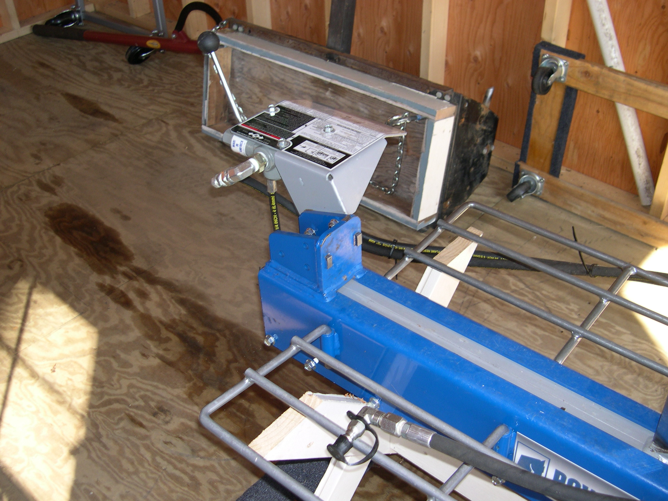

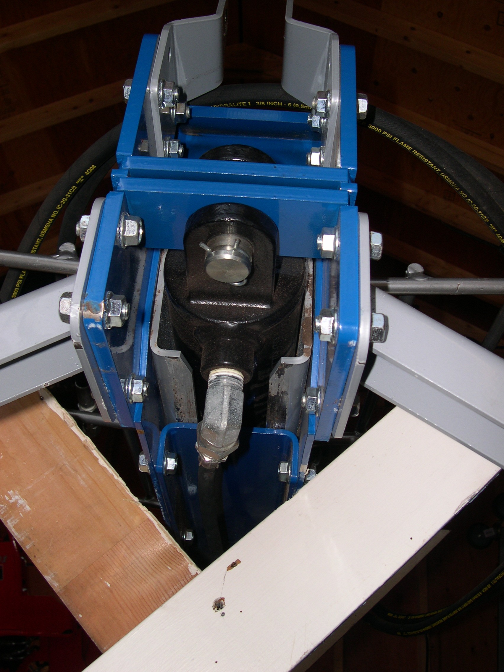

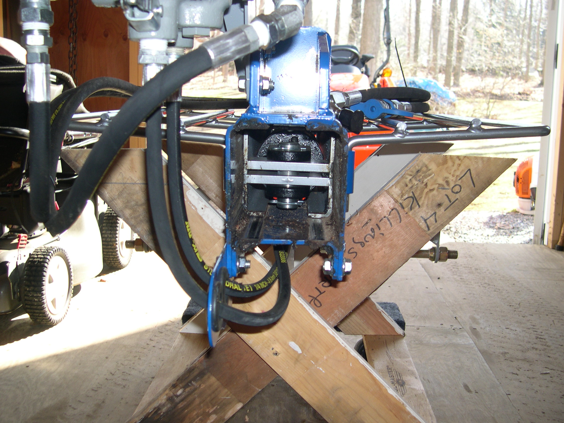

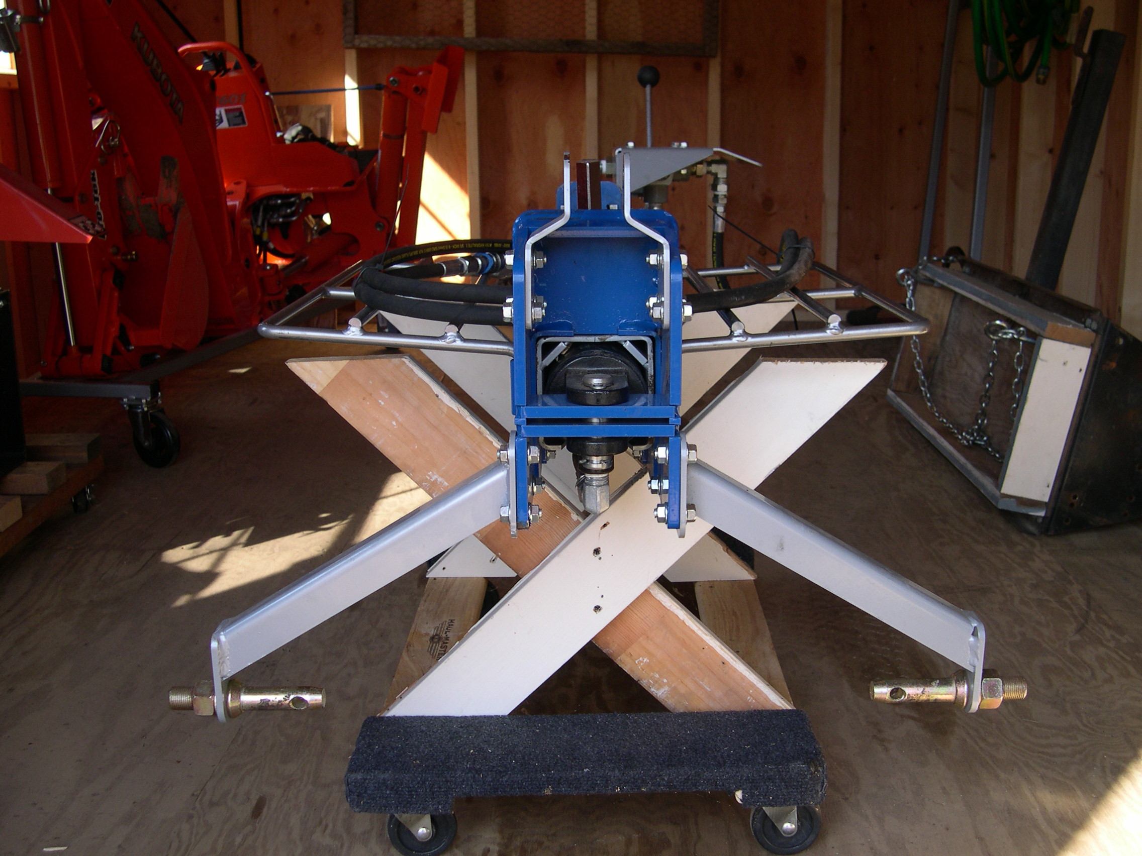

OK, took some pic's yesterday of the splitter for E-B-C and JJ. Basically, the splitter uses a box in side a box architecture with the cylinder pinned to the outside, fixed box (blue) on one end and to the inner, sliding box (silver) on the rod end. The ram sits inside the inner, sliding box. The wedge is welded to the top of the inner box.

That is about how I figured it worked. I am trying to build something similar, but smaller for a limb cutter, that will be on the end of a boom poll.
