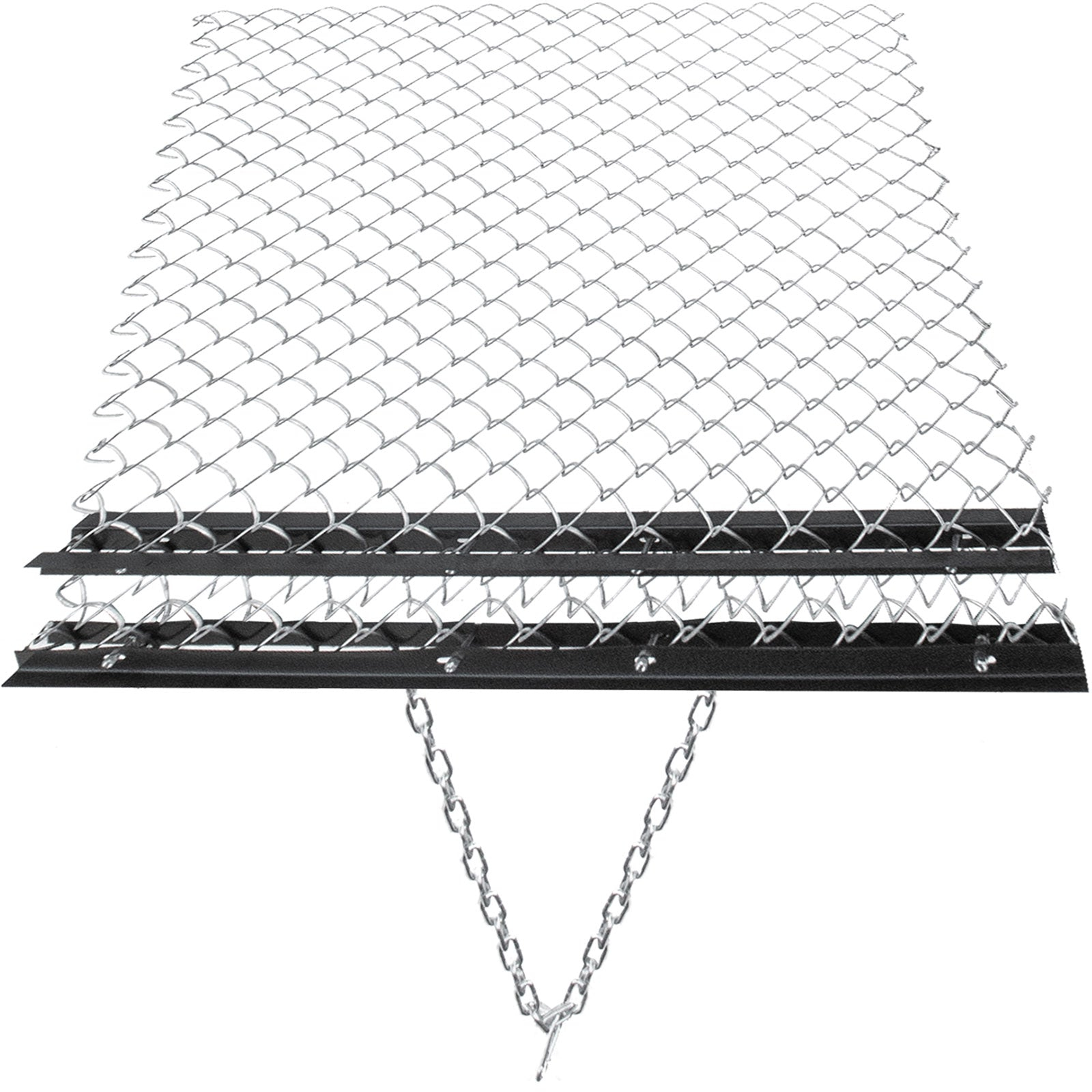

Lengthen your top link so that the blade is barely cutting and just pull ahead. I set a stop on the three point lift to bring the box blade up an inch above grade and let the contents just feather out under the back. When you get your grade about where you want it lengthen the top link even more so that the inside blade isn't cutting at all and the back blade is just smoothing. Finish with a drag harrow. The drag harrow can b something as simple as some chain-link fence material with the leading edge held flat and a chain or even a good rope to pull it with.
