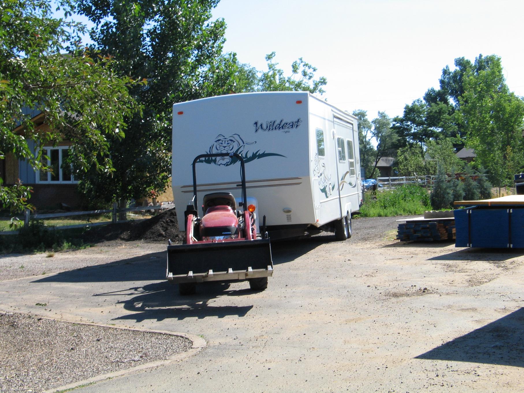

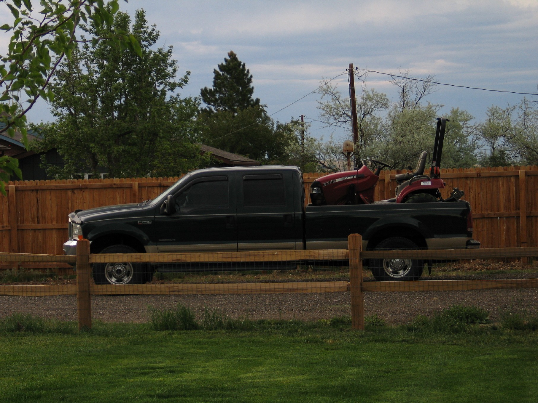

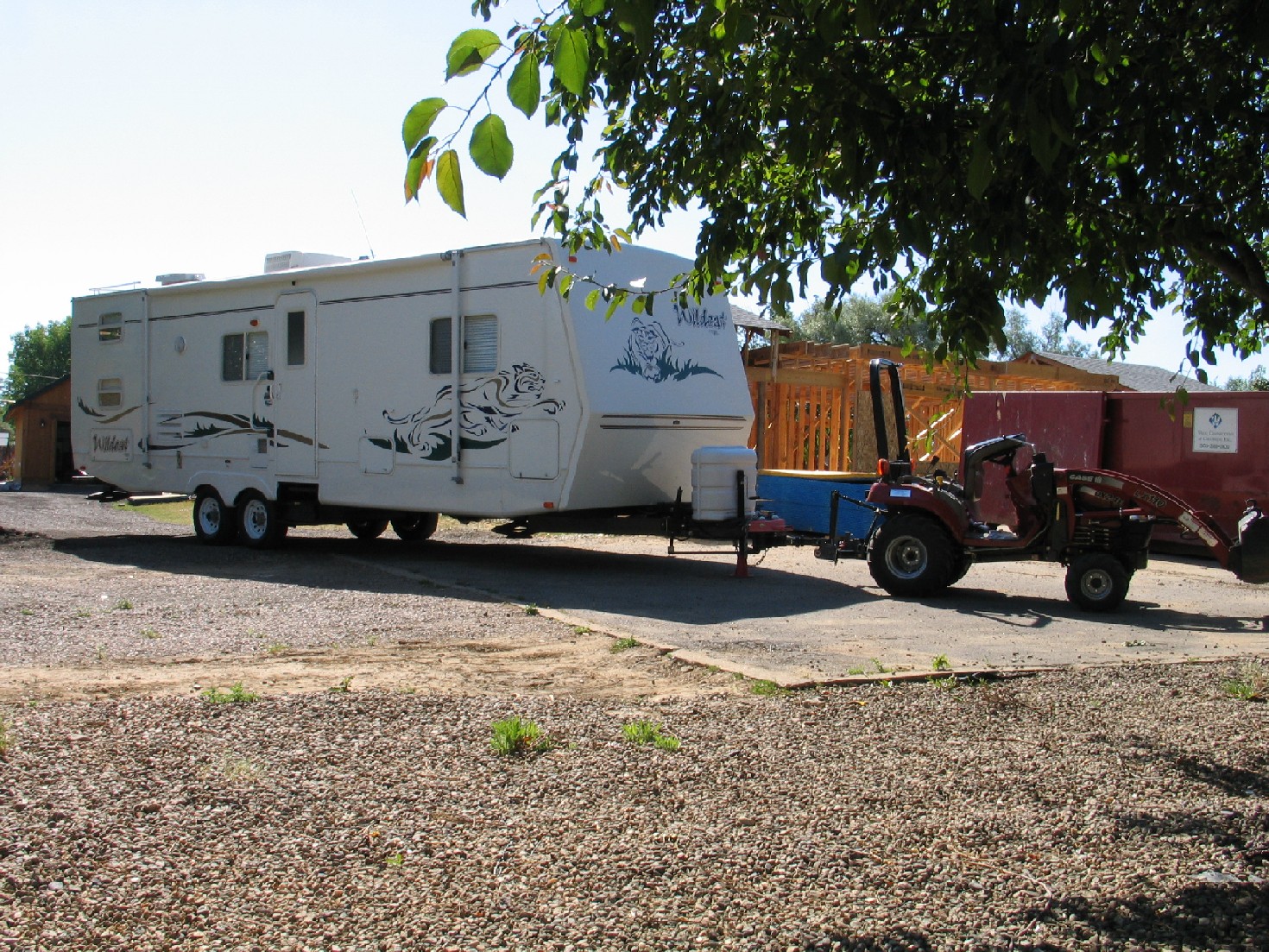

OK, so here's what I did. It was fairly flat, and I really just wanted to see if the tractor could actually move the trailer, and it did, but I went very slow, and it isn't something I'd make a habit of doing with a subcompact.
How small is a subcompact? The 3rd pic is the real tow rig ready to take the subcompact in to the dealer for warranty service.
