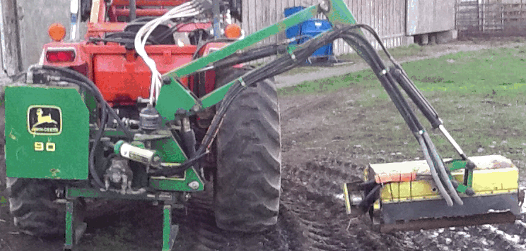

I have one of those and it isn't all that you might think. Mine has a flail head and does not cut as well as I would like and you certainly can't cut under a fence with it. Mine is 3pt mounted and that makes for more flexing of the mounting and arm than I would expect. Mine was used when I got it so I don't have that much into it, but it would not be of use around a fence. Even if you set the flail head perpendicular to the fence you would not want to risk catching the barb wire with it. The big County machines are mid mounted to the frame of the tractor allowing a much heavier set up.

Could you show your setup in some pics?:thumbsup:
I'd like to see what one looks like on a regular sized tractor.

Here you are
Thanks! So what is that unit called exactly? Model 90? What's something like it cost on average? Model of your tractor? HP?
Thanks again- I want one!

JD had the unit made for them and don't sell it any longer. I forget who made it. Here are a couple of boom flail mowers, they are not cheap. I got mine used via a school district surplus sale. They also have rotary brush hog types.
http://www.alamo-group.com/Company/Products/Categories/Boom_MowersPower_Arms.html
http://www.servis-rhino.com/products/boom-mowers/hydraulic-boom-flails/
I run it on either a 45 or a 60 HP machine. It takes a 540 PTO, has it's own pump and tank.
