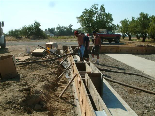

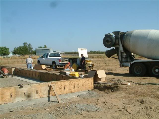

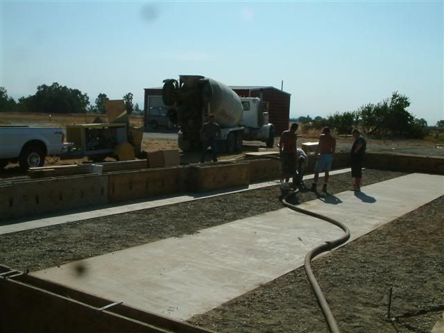

The pour went perfect and ended up being 9 yards. I was the 塗ose Man (no jokes please) pulling, pointing and holding the hose as the concrete is pumped. I can honestly say the FEL would have been more fun even if it took all day. I would take a day of seat time over nearly 1.5 hours of dragging that hose around.
Thanks for the input the pump method was the way to go but don稚 be mislead, its not easy. Thinking about it nothing with concrete is easy, well maybe writing the checks.
