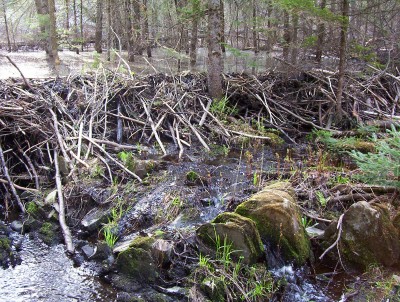

Yes, yours is much more practical. My suggestion was supposed to be somewhat humorous. The "hook" I showed stands over 41/2 feet high, and is quite heavy. Just another case of myself being the only one to "get" the gist of my humour. My mind must work in mysterious ways....
I have actually used this "hook" to pull a rather large beaver dam apart. Beaver dams are real tough to break up. I managed to get this hook inserted and pulled low- drawbar. It sure managed to loosen and break things up.
I did have wardens permission to destroy the dam.
