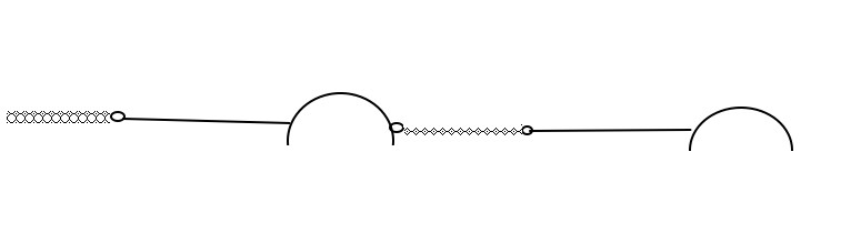

If I had those pipes and wanted to use them for a field smoother, I would cut them in half lengthways, then make a rigid hitch at least a couple of feet long to keep them with open face down when pulled, sort of like a long eye-bolt.
Several in line behind should do far more than just pulling a round pipe.

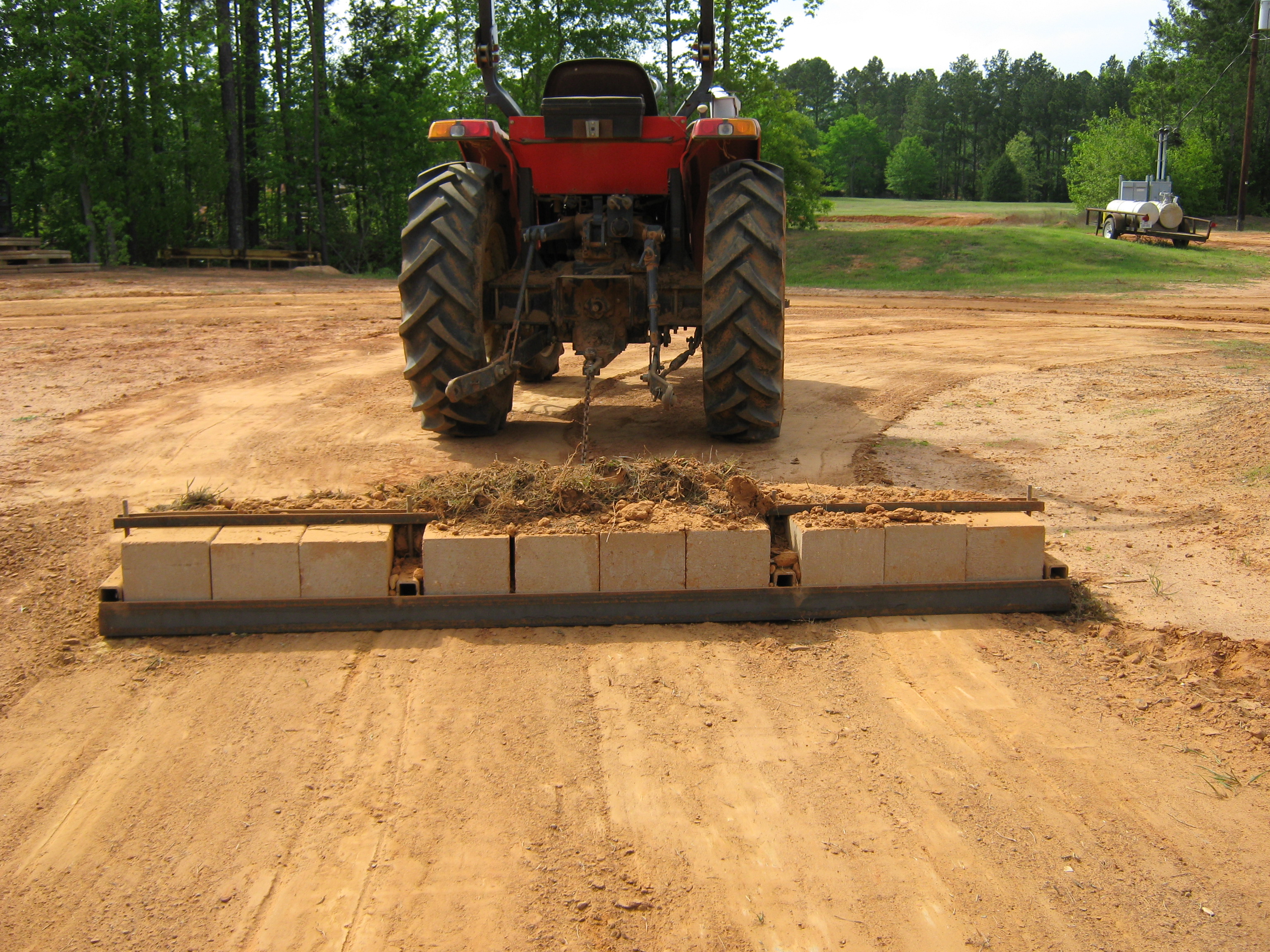

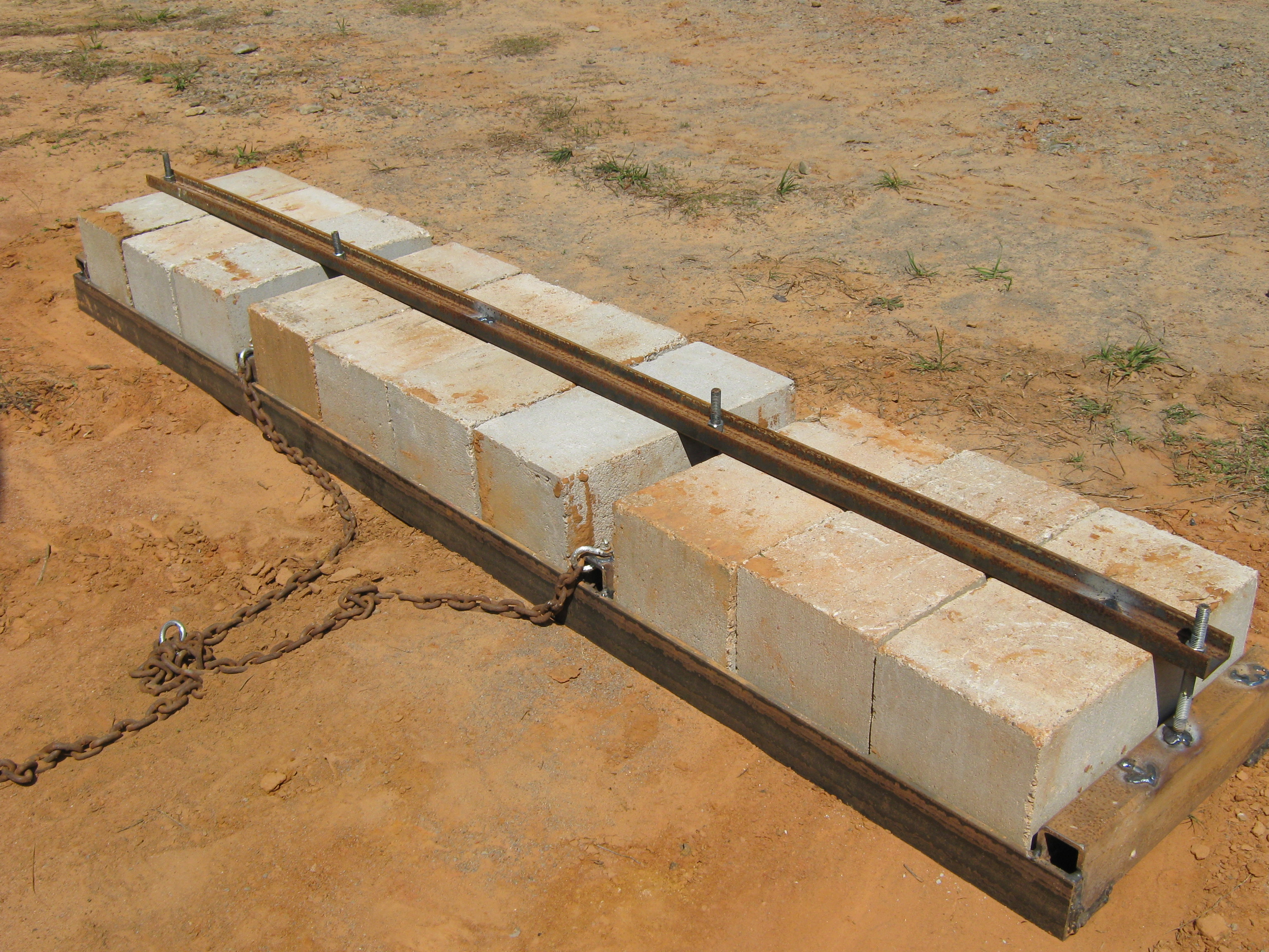

This is what I built. It's a little heavy for my 35hp tractor, and if I get into some soft soil, I stop moving and my tires dig into the ground. But my 80 hp 2wd backhoe can pull it easily no matter how soft the soil is.
