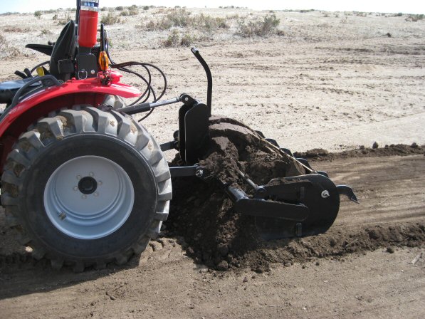

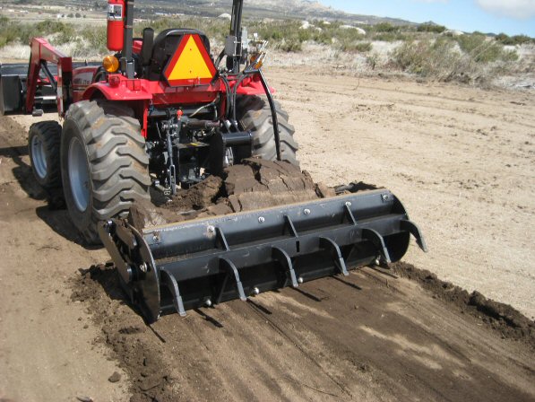

While that sounds like a very nice BB, I think that it is actually just a tad big for your tractor. That's not to say that you could not use it, just that you won't be pulling a full load up any steep hills. I'm pretty sure that with the QD's on the end of the hose that the hydraulic will indeed stay where ever you set it. I have a 66" heavy duty BB for my Mahindra 3215 and it is about all it wants when going up hill. My tractor is ballasted to about 5000lbs. I would go ahead and buy the BB, but keep in mind that you may not be able to use it to it's full capacity depending on your conditions. :thumbsup:
