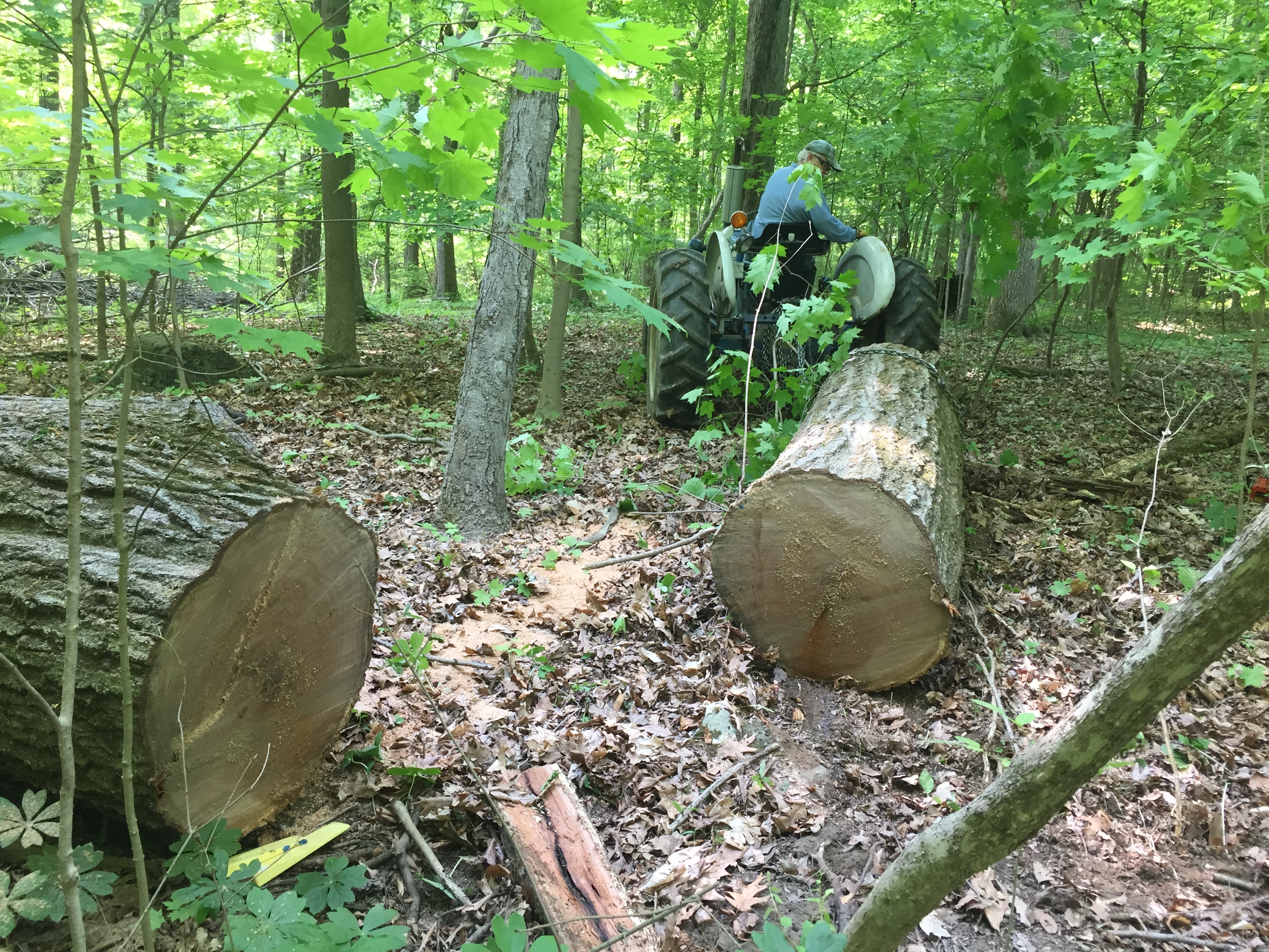

Tongs on a drawbar on the 3-point works fairly well, much more capacity than the bucket, and much less likely to tip the machine.
I've dragged hundreds of cords of logs out of the woods with a Ford 3000, usually working about 1/2 mile in from our staging area, and we've found 3-point to be infinitely better than bucket. However, I'll also say we've found chain chokers to be infinitely more reliable than tongs, when going any sort of distance over any sort of rough terrain.

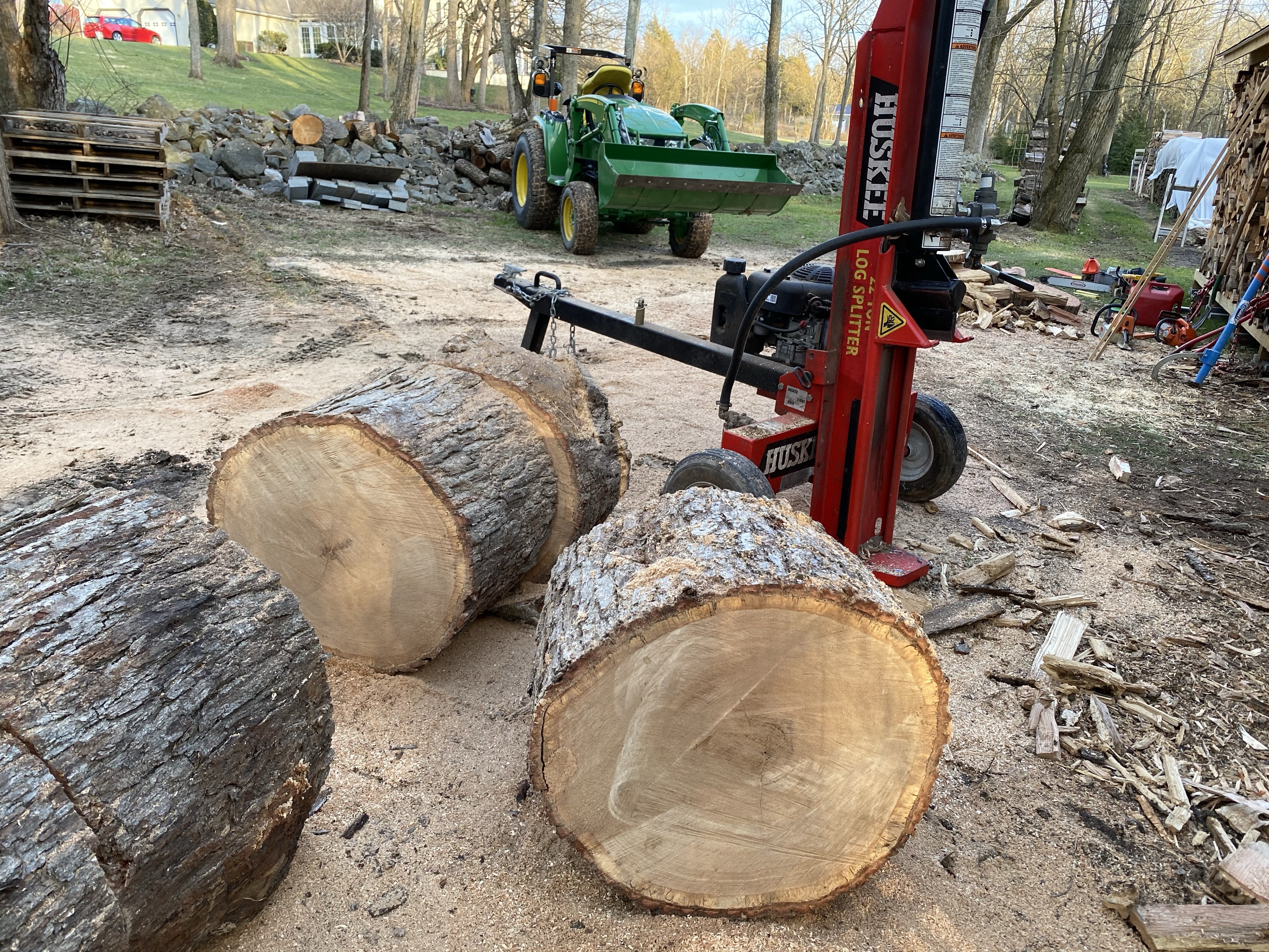

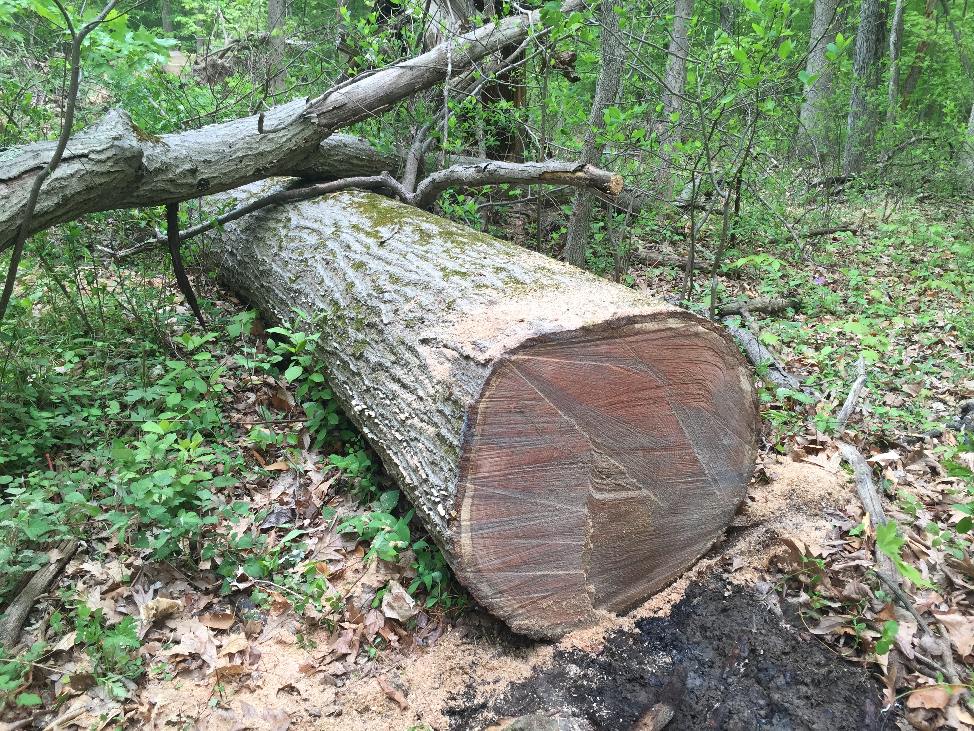

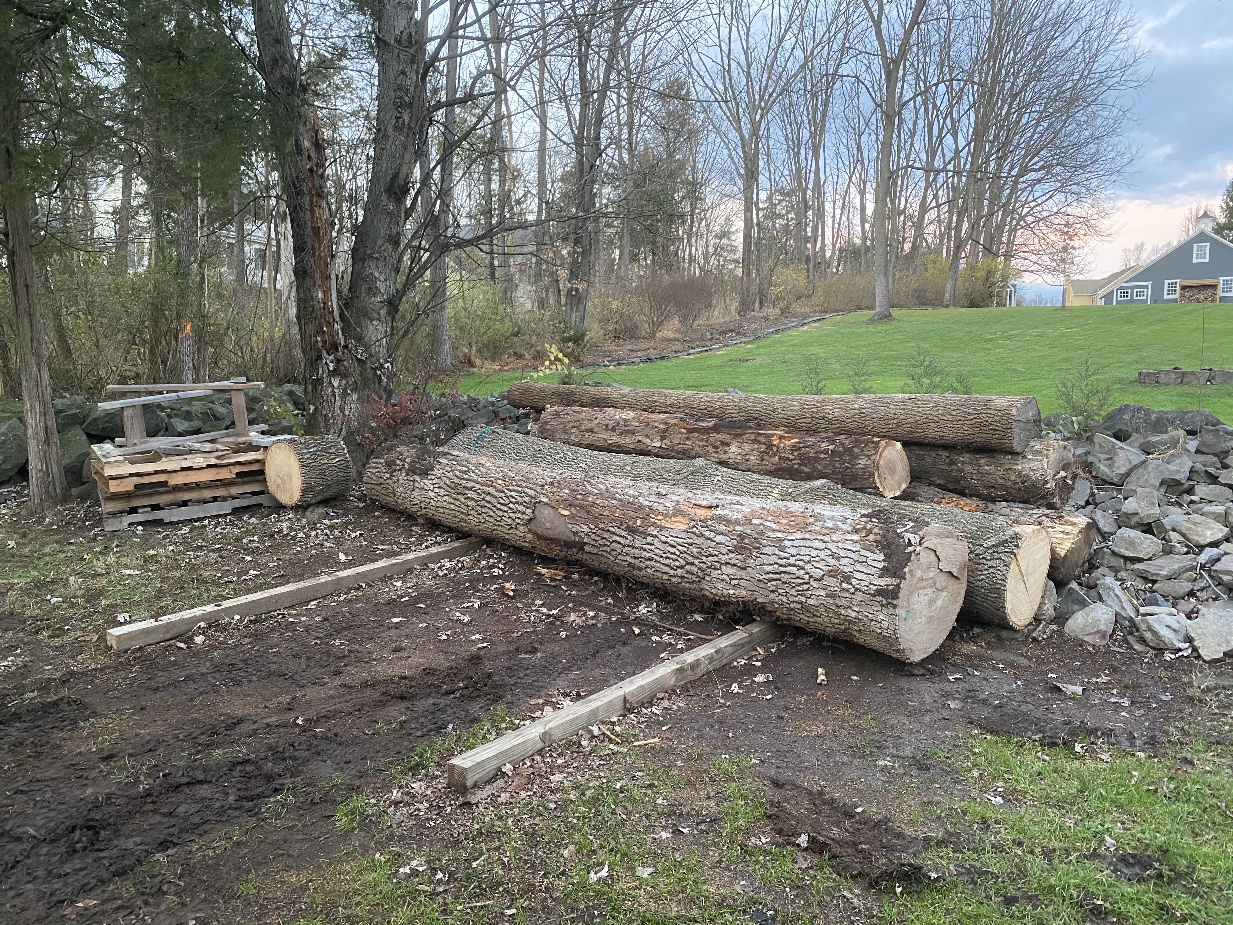

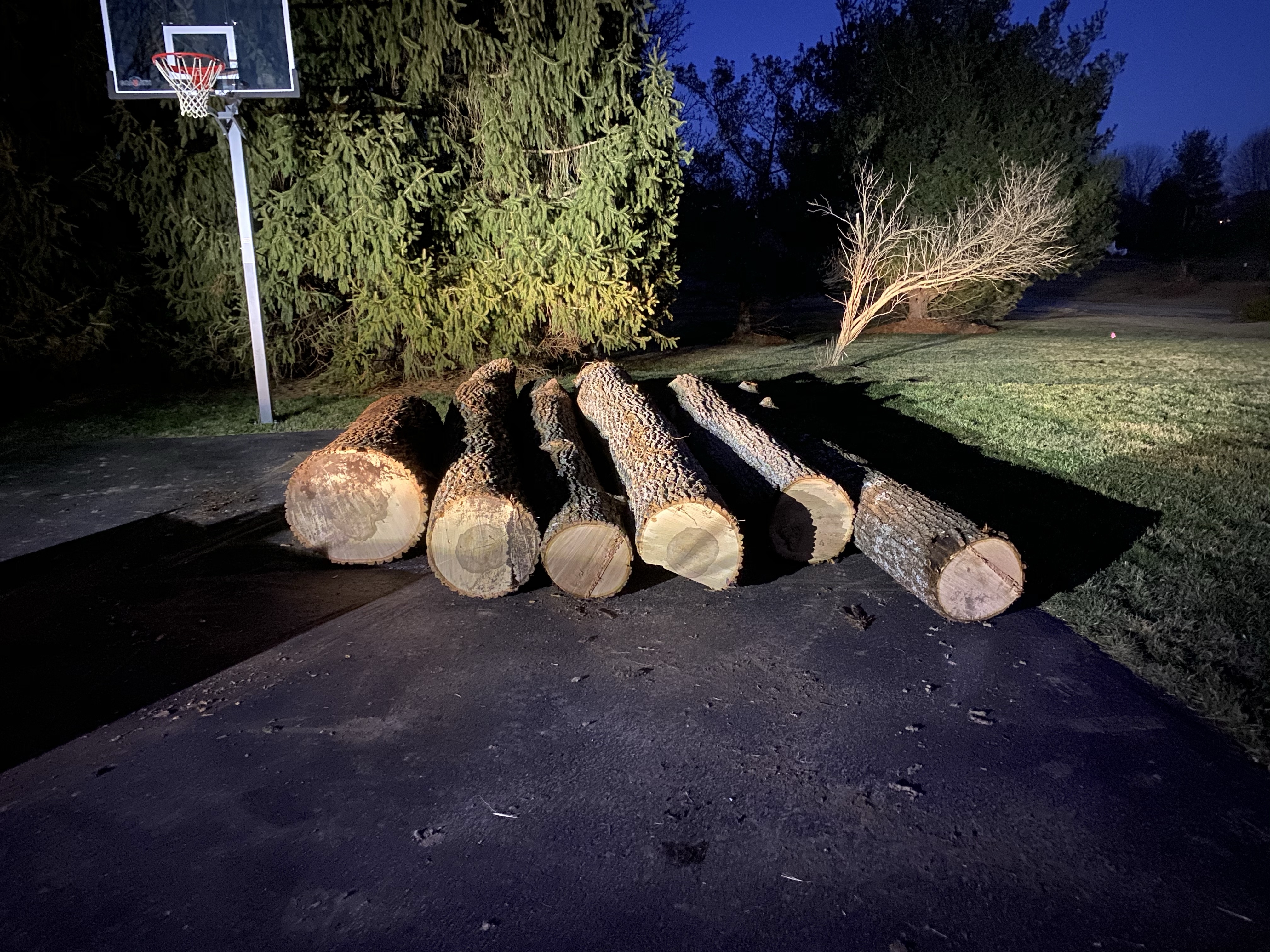

If I tried to pick up that top log with my tractor, it would lift the rears instead. Also, please don't tell me that you burned that hundred dollar bill log.
I burn dozens of logs nicer than that, every year! :D The reality is that I'm surrounded by big oaks and walnuts, and while it's not uncommon to have someone accuse me of burning "veneer quality" logs, the mills around here don't want them, or won't pay us what they're worth to me as firewood.
I also don't like stacking wood that's less than perfectly pin straight. I leave all crotches and knots in the woods, as much as I can. I usually lop the top off the tree, leave that to go back to nature, and just take the straight trunk home.
