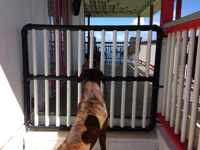

A curve ball... The deck is around part of a pool, so any metal within 5 feet of the pool wall must be bonded with 8ga bare copper wire to the filter pump motor.
So, instead of running copper to each conduit baluster, are there any non-metalic options? Thought about plastic or fiberglass rods, but they are expensive. Now thinking about PVC pipe. Maybe 3/4" so it's rigid enought.
Would it look trashy or should I just break down an use the standard 2x2 pressure treated balusters... ? sigh...

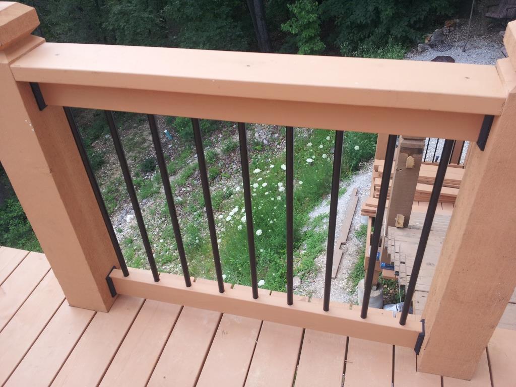

The big box home improvement stores are always advertising metal balusters. I think they are powder coated and don't seem too expensive. From a cost/time and appearance standpoint, these might be a good option.

I built these using 1" PVC and 2x4's in 2005. I used 3 threaded rods per 8ft section to hold together. Last year i built the gate using abs for the frame, not elegant but functional.
David Sent from my iPad using TractorByNet

Lowes and home depot sell powder coated aluminum balusters just for this application.
They also have black plastic brackets to mount the bottom supports in. We thought
they dressed it up a little.
