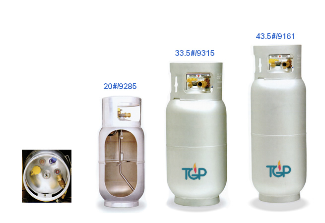

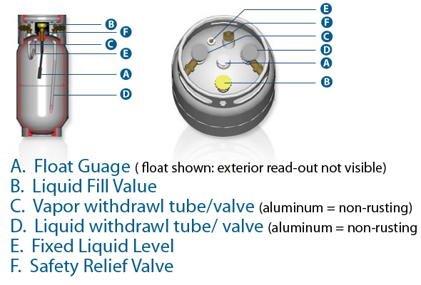

Good memory - I added a fill valve on it so I could fill from the truck, but the vapor and liquid withdraw valves were both installed already from the factory (or I added the vapor one in the hole provided - can't remember).
The 80% blow-off valve for filling was already installed.
Interesting internals since the vapor has a loop of pipe that keeps it in the vapor when oriented correctly on it's side, or vertical.
The liquid tube goes to the bottom "corner" so it's in liquid vertical or horizontal (correctly oriented) as well.
Mine is the larger 43lb tanks and looks a lot like this.
(the liquid dip tube is like the second pic)
