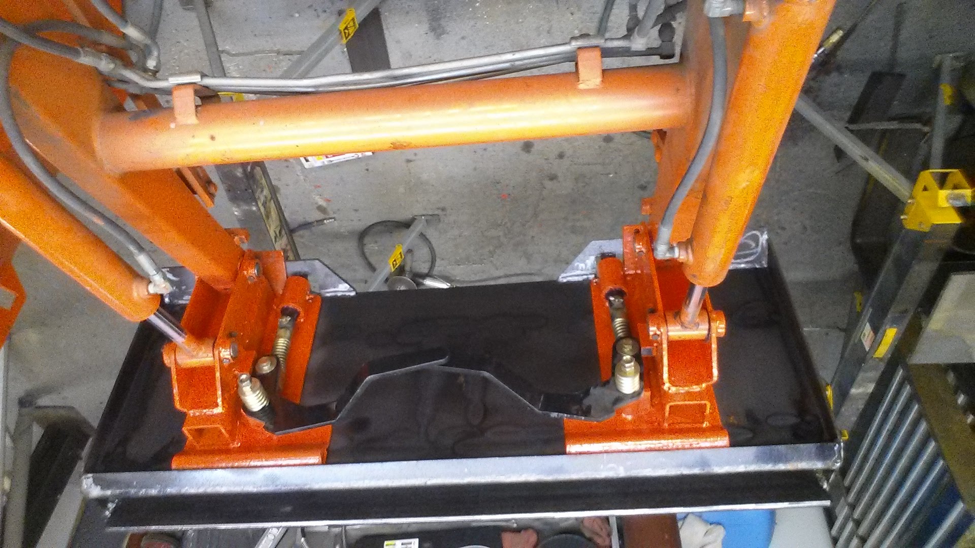

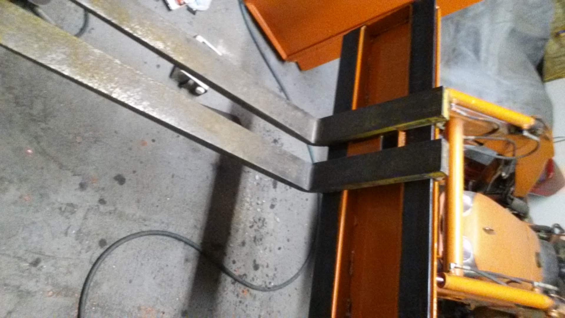

Hilo forks are a spring type steel. They will bend a bit then go back. Plus they are mounted on a rail. Those will work without a problem with the forks. The bolt on the bucket type is normal steel and once bent your done haha. I bought hilo forks and made a quick attach mount and allowing them to adjust side to side. I beat them up pretty bad towing giant logs or ripping roots. Watching them bend is horrifying to watch but they always spring back... The bobcat quick attach system has to be the best thing I have done yet to my tractors. If you haven't, you are truly missing out!

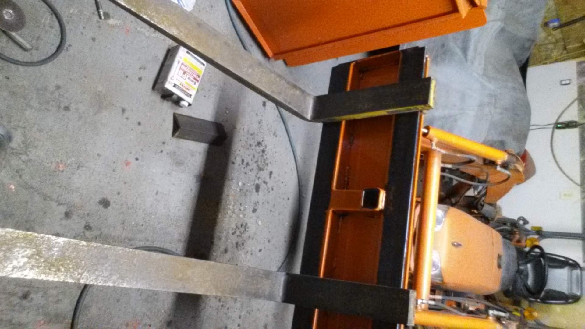

Im guilty of using forks to pull large rocks out of the ground that dont fit the bucket. Be aware that forks are made for lifting, not pushing. Its easy to bend your fork rack. Remember the lever principle- you are applying a lot of force on the end of a long lever and you can easily overload your forks, fork rack, loader arms and tractor while pushing.

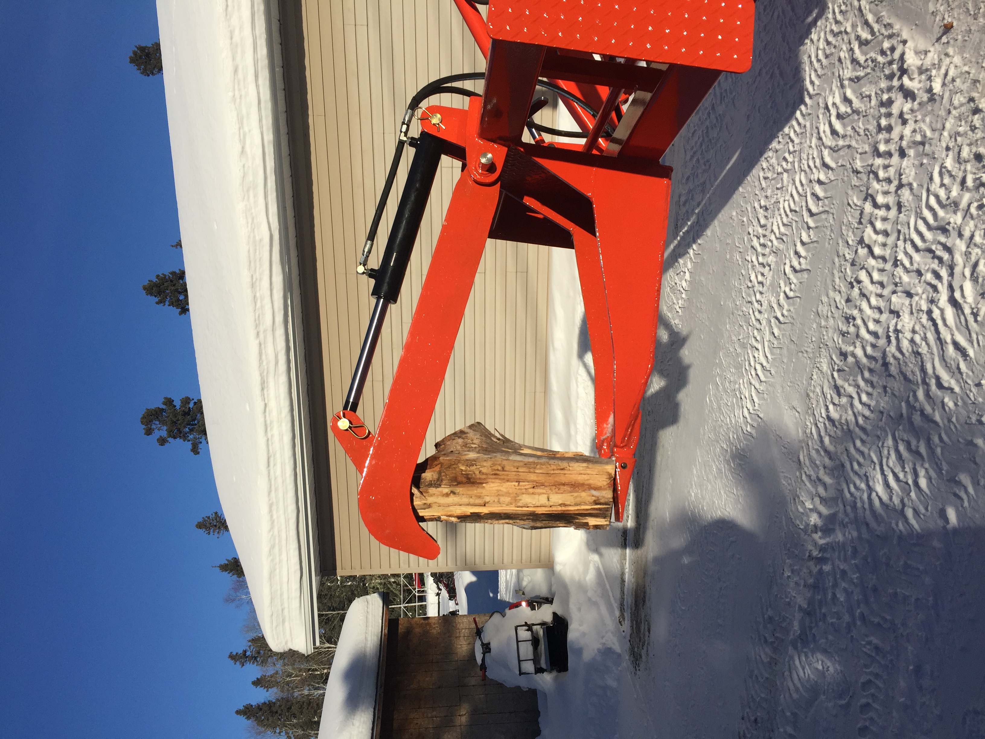

I haven't used my forks for digging stumps or rocks for fear of bending them. I searched for a smaller narrow stump buck simply because of the size of my tractor, Kubota L2501. Most of the stump buckets I found were designed for the power and weight of a skid steer and were too big and heavey for my little tractor, so I built my own. It is only 9" wide and 30" long and I installed two bucket teeth on it as well as a grapple. I couldn't be happier. It's small enough to where I can almost drive the whole bucket into the ground for digging out rocks and the roots of stumps. The two teeth on it are great for ripping and digging. I smile everytime I install it on my FEL because I know it's going to be a fun time.

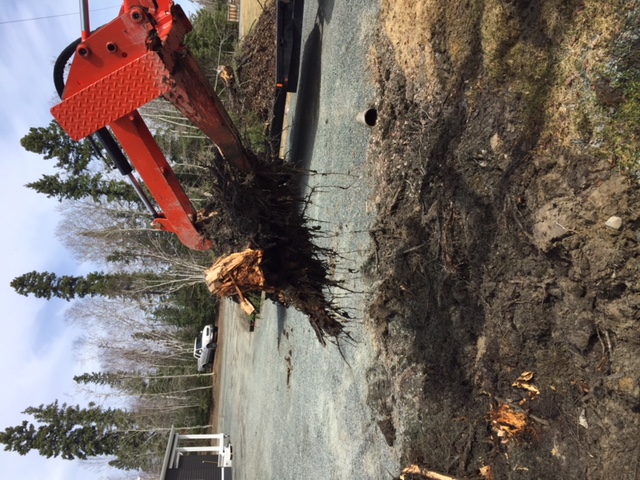

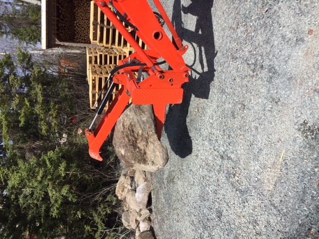

I finally got around to seriously using the grapple fork as a rock/root remover.
Pried out 4 very large embedded stones and 2 stumps/bushes that I have mowed around for years
The M is strong and heavy enough and I don't pry much since the forks allow for
a steep angle to get under and wiggle things a little before grappling and lifting the rock out.

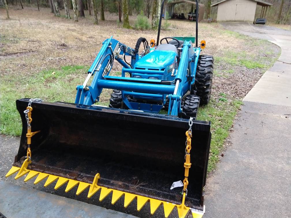

This. I couldn't be happier with my ratchet rake. From raking pinestraw, limbs, and leaves to smoothing out ruts from driving my tractor over wet ground, to ripping roots and small bushes/trees right out of the ground, it's an all around good tool. I opted for the turnbuckle and chains over the ratchet strap because I've experienced ratchets that are left tightened for a long time and rust up, and that was on smaller buckles. I figured if I left the rake on for months at a time, those ratchets would be a booger to get loose. Plus, chains and turnbuckles just seem sturdier and I'm hard on stuff... IMG_20190313_170105894.jpeg
