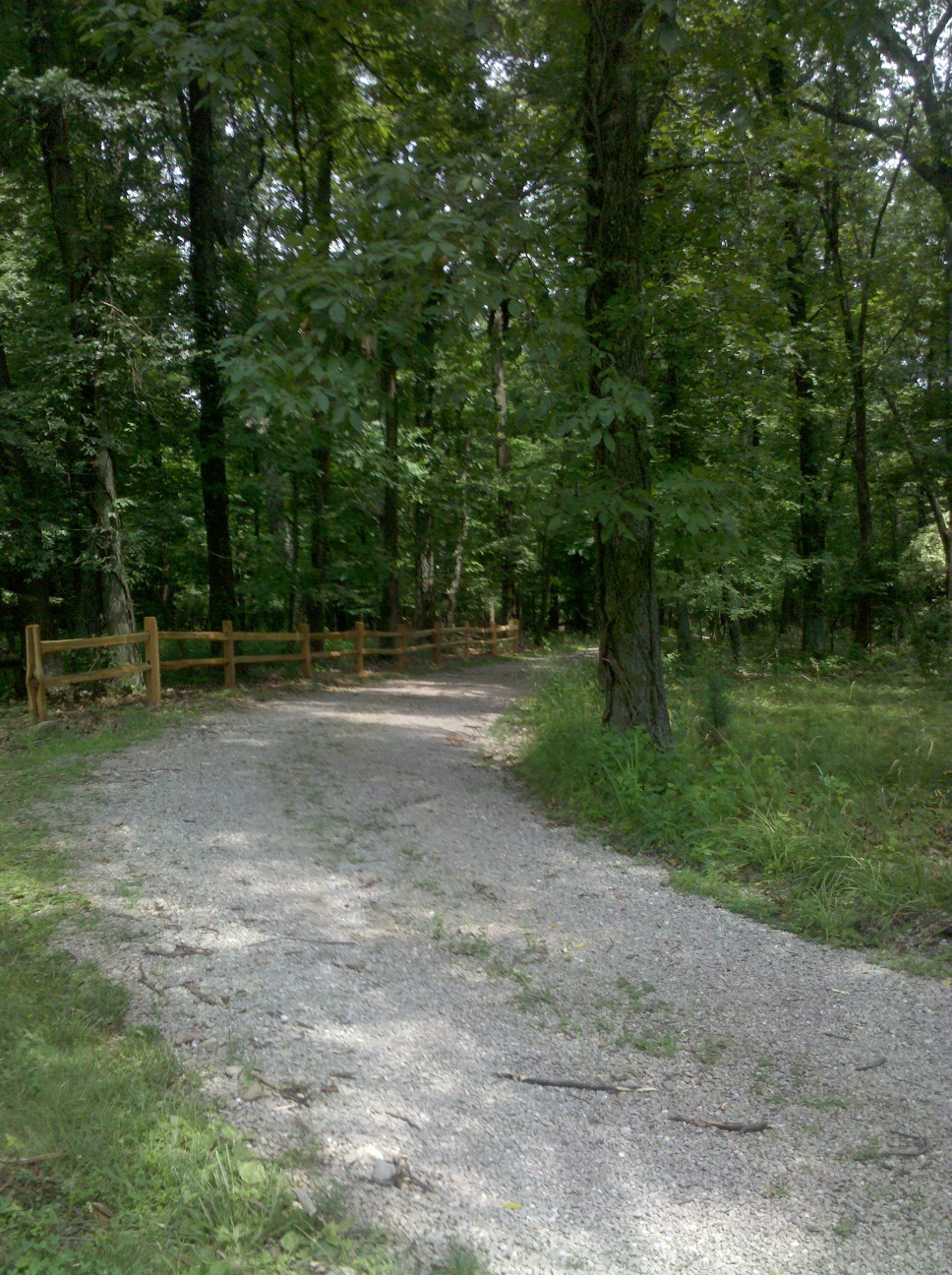

...The other advantage of running slower is that you will never experience the joy :( of "augering down" - where the auger suddenly gets a really good bite in the soil, or threads around a larger rock or root. In ten turns of the PTO the auger will screw itself completely into the ground. If your PTO is running at 300 RPM - this will happen so fast you will not be able to react. Then you will find that your 3pt will bypass when you try to lift the auger out of the hole. You will have to disconnect the drive head and use a really big pipe to unscrew the auger from the ground. You will only do this once.
Will I was on the next to last hole, the heat index was over 100 and I am completely soaked. Even though I was going slow, I got to experience "augering down" for myself. As you can see from the attached (not very good) picture, I am at the edge of the woods. The PHD grabbed a root and just took off. And you are correct, I didn't react quick enough to stop it. I sheared a pin and kicked in the 3pt bypass.
Disconnect the auger, but I couldn't turn it with a pipe wrench and cheater bar. Ended up rocking it with the FEL and then wrapped a chain around it and lifted it out. I did get the post in, but called it a day. Not sure if the speed was too fast or the operator was too slow. I'm blaming it on the heat.
   / Using PHD w/TC40DA - need 3rd hand #20
Stuck auger or not, that's a fine looking rail fence Barry. Nice job!:thumbsup:
