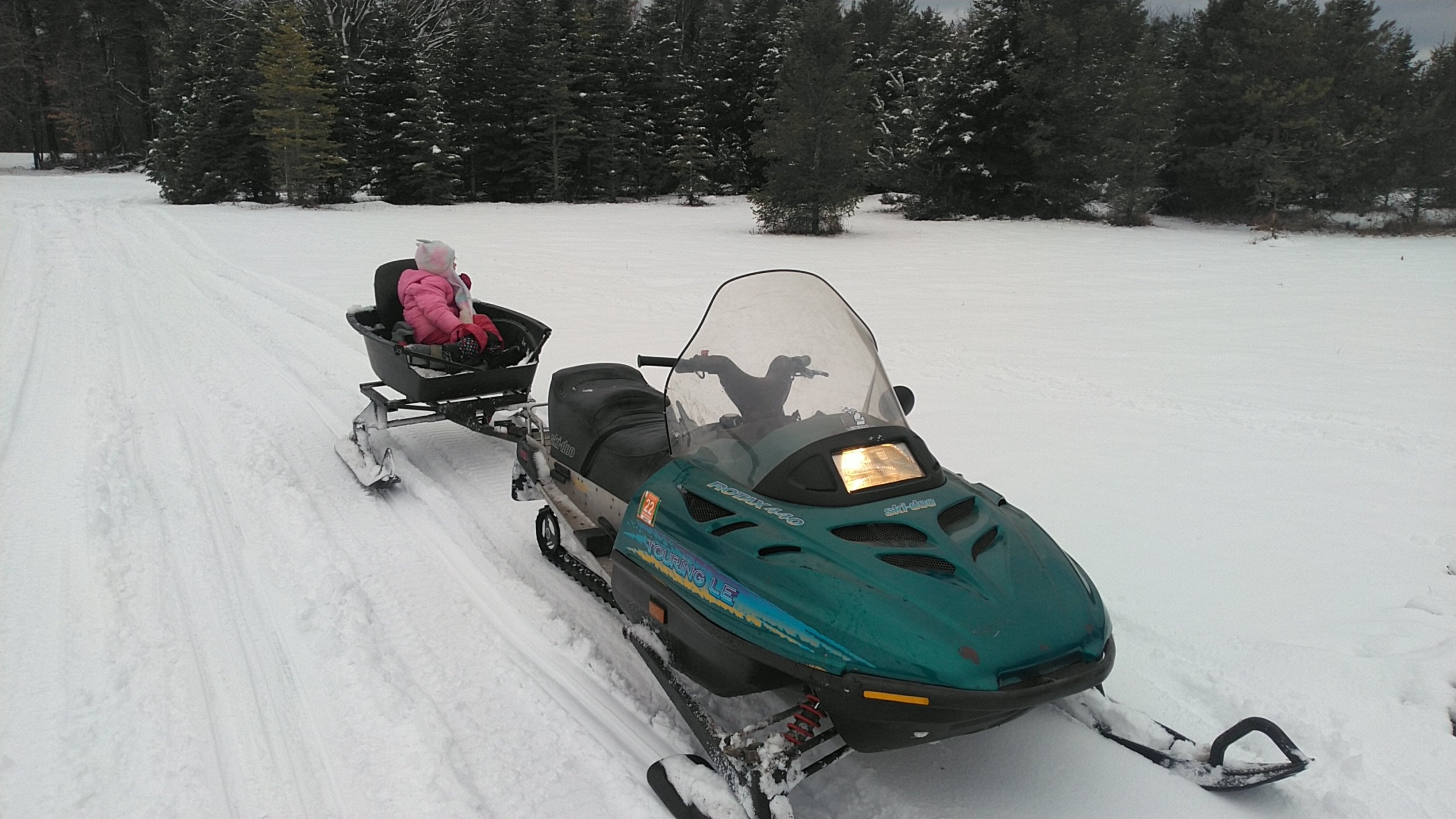

Recently acquired 2 sheets of transparent poly carbonate plastic thinking about making windshields for pull behind snow trailers so when I pull the kids don't get pelted with snow. These trailers will not be used on public snowmobile trails just around my property. So before I dive into this anyone bend or form polycarbonate successfully? Heating them and bending them without a brake? Mostly only have access to heat guns that I think will be beneficial for this project. Or should I build an aluminum frame and either rivet or bolt cut polycarbonate pieces to the frame? The tubs mounted to the ski frames are rounded, flared, and somewhat pieced together. Here's what I'll be working with and other ones similar. Ideas are appreciated.

I have formed poly carbonate using a heat gun and a piece of tubing as a form. You don't need much pressure to bend poly but you do need to heat the entire bend area evenly. I also suggest that you don't try to do too sharp a bend radius either. Somewhere around a 1" radius is probably best to shoot for.

Too late, since you already have the plastic, but... I've done something like this, but I used a windscreen from another sled, that was already shaped. Yes, even heat is needed (have a helper) to bend it w/o cracking.

Looks like your snowmobile windshield would be a perfect fit for the sleigh. How much to get another windshield?

Yep, have a shelf full of that series skidoo chassis parts unfortunately no spare windshields anymore (they do get pretty brittle with age and cold temps) I don't own a sheet metal brak plus I'm to cheap to buy a hundred dollar windshield for a 30+ yr old diy novelty trailer. Anyways when I get the time and it gets warmer I'll get the trailer pulled inside and mock something up with cardboard first than finalize my plan with that sheet of 1/4" thick sheet of polycarbonate I have on hand. I'm thinking it's going to be a combination of polycarbonate, and some repurposed aluminum angle and tube I have laying around. Thanks for all the input everyone 👍I'm still not completely sold on how I'm planning to mount it or cut it I guess for now Im planning to cut the sheet with a router bit and round off the edges with a router though?

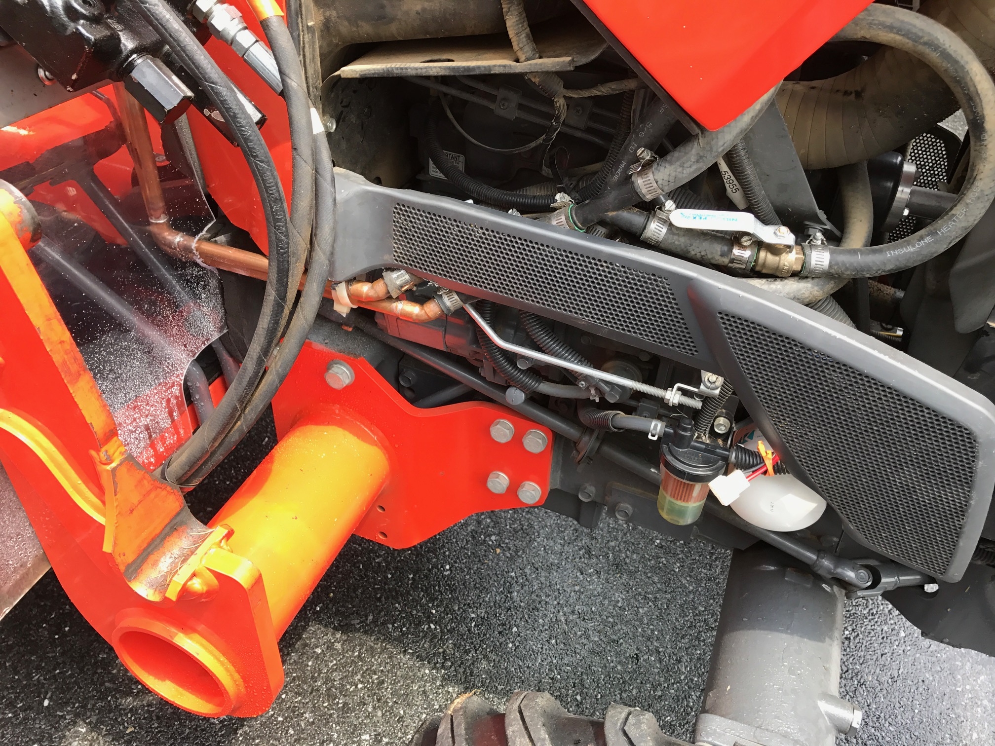

We used Lexan at work for various things. One use was for forklift lids. We cut it to size and bent it with our large press brake (can do 10' pieces of 1/4" mild steel). The springback was substantial. 90° bends came back to nearly 45°. Cutting it is easy with a saw. While I haven't tried a razor knife, I'm doubtful it would work well. That's based on experience cutting Plexiglass. To cut it by scoring it you need to plow material out of the cut. One of the best tools - believe it or not - was from Kmart. It resembles this:
The tool is pulled and scrapes out a V, getting deeper on each pass. A razor knife tries to push plastic out of the way and doesn't work well.
My DIY cab had automotive safety glass except for the lower front where it had to be cut around the hood, heater lines and pedals. That ended up being Lexan after a misadventure with flexible plastic. Good material to work with. Below is a shot with the "crumbs" from cutting still stuck to it.
