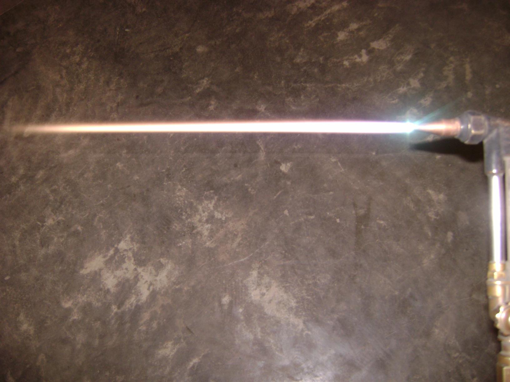

In the pic's you made, I noticed the cuts look smooth and hardly any slag. Is that typical with propane?
Oh you can get slag with propane if your travel speed is off.
I don't notice more use of oxygen, but I don't cut a lot with the torch, just depends on the project at hand. I use my band saw for most cuts.
